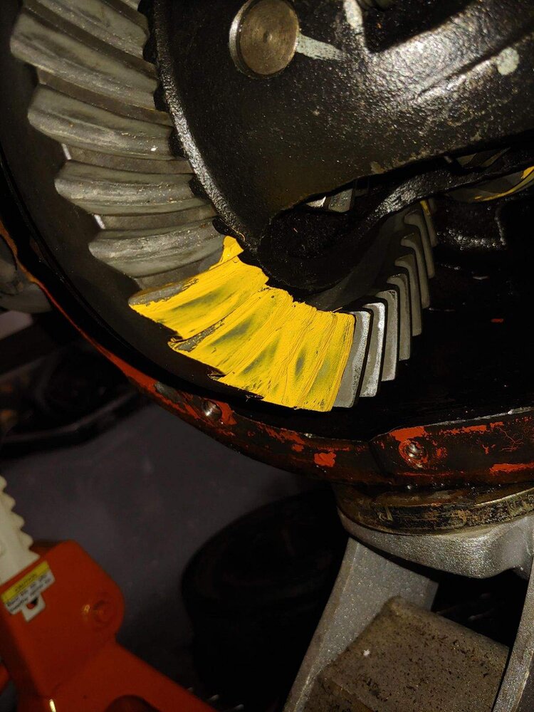

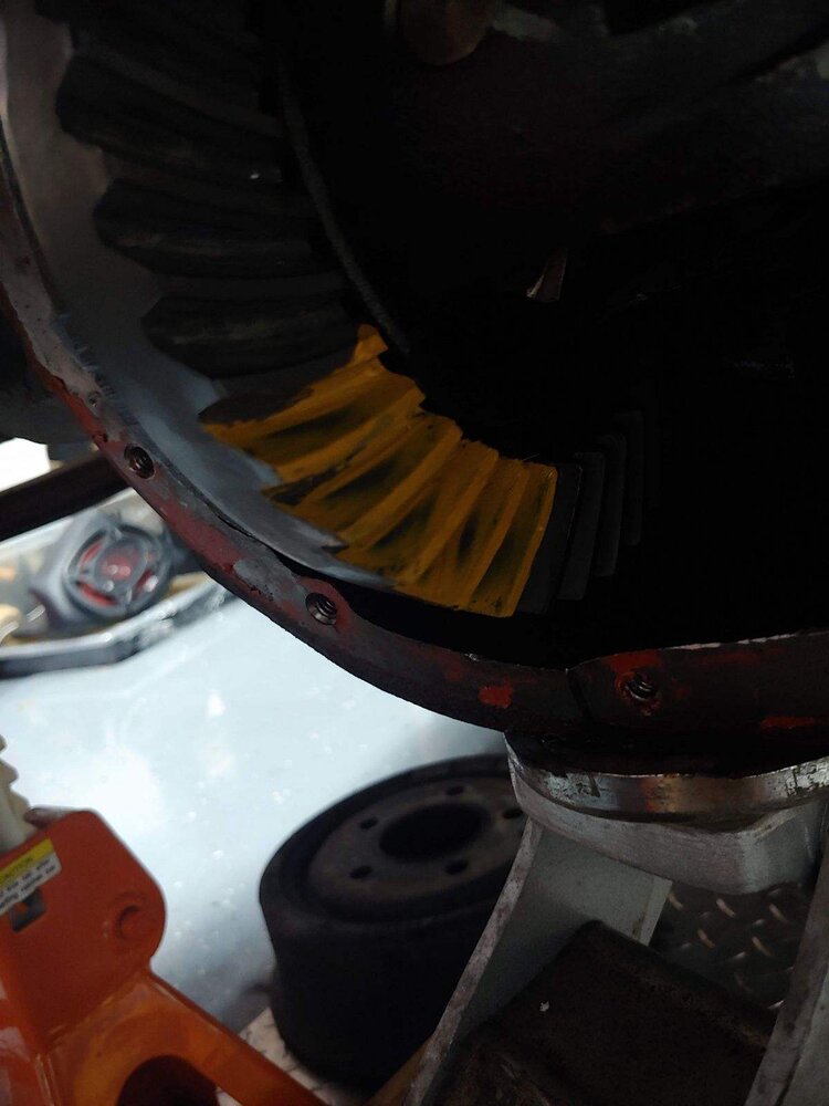

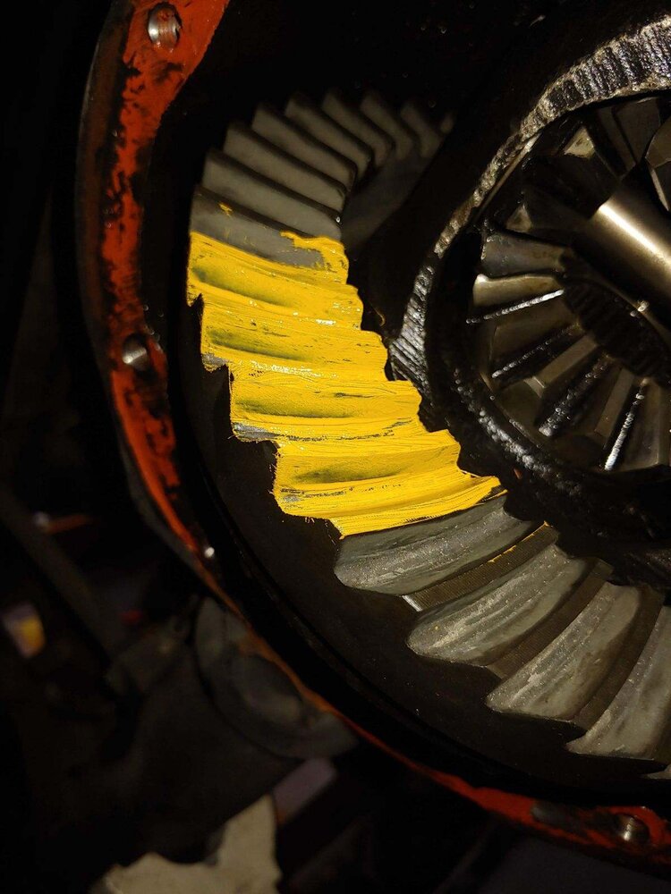

The owner said he did the gears. And shared a picture of the pattern with me. Seems a bit deep to me. Just wondering what else it could be. I’ve already passed on the jeep, so this is just curious at this point.

I’ve seen worse, but that ain’t right. Pinion too deep. But that shouldn’t be causing major decel.
