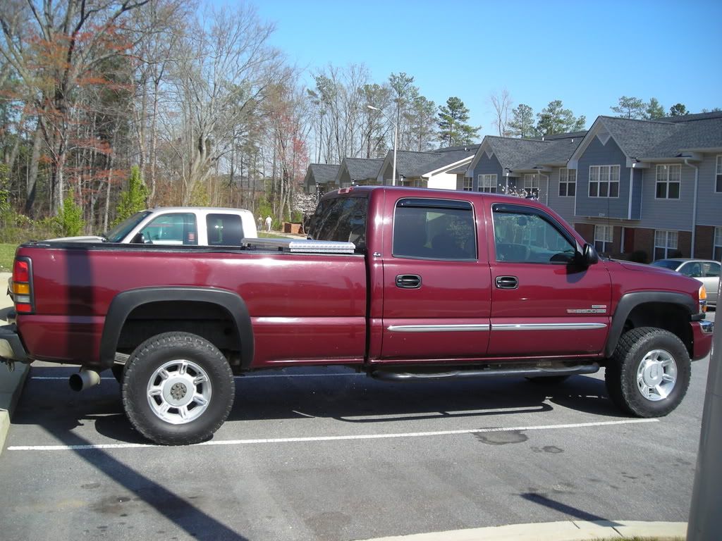

Is there existing tailpipe there that you want to route differently what? I didn't like the tail pipe exit on the 5" exhaust on my Duramax that the previous owner installed because it wouldn't allow the spare tire to be installed, so I hacked that off and used the existing bends in the tail pipe to fab up an exit in front of the tire, actually came out pretty clean looking I do think. Look into what you have and see what you can make from it before ordering something. I spent about 2 hours visualizing and measuring before I hacked it off. I think it wound up taking a combination of roughly a 45, two 30s, and some straight. All existing pipe, nothing added.
This:
http://i44.photobucket.com/albums/f43/GCncsuHD/dmax/DSCN1506.jpg
To This:
http://i44.photobucket.com/albums/f43/GCncsuHD/dmax/DSCN3020.jpg
Otherwise, I would look into getting one of those combo bends that has like a U, some straight, and a 45 all in one piece. You can cut the U into whatever angle you need, 30, 45, 90 etc.
