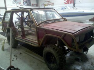

I'm looking to help a friend with a exo cage on his yota my ? is what size tubing should we use.This is my first cage so it is going to take awhile but would like to know what size would be strong and hold up. THANKS
