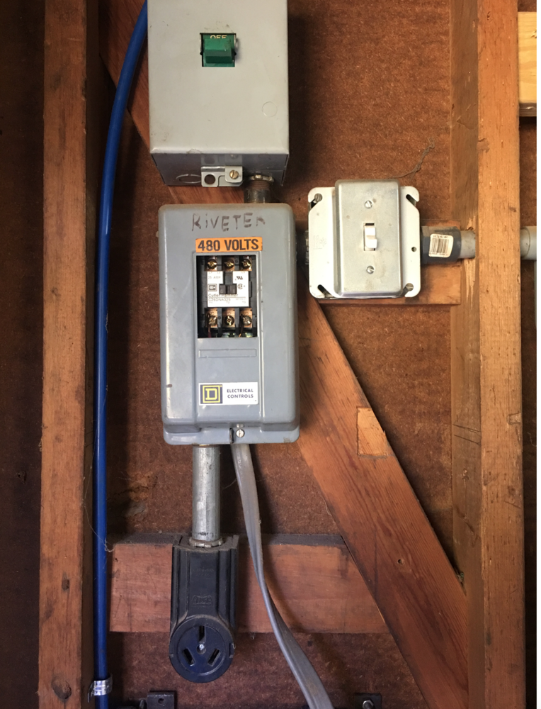

Does that light switch beside it do anything by chance? Whats the big romex looking wire go to? I'm betting that's not actually 440v 3p. It looks like someone swiped a starter and a box from work for a home project and it just says 440v. It looks like only the outside terminals of the startery are being used which means it's most likely just 220v single phase.
That's a starter in the box. Not the right cover for the box either, kinda sketchy being able to stick a finger in there to the terminals.
The big romex goes to nothing. I plugged my 220v compressor into it one day not knowing and it wouldn't cut on so I am not sure. It also makes a nice humming when its turned on. Switch does something but honestly I can't remember right now. Maybe that is the starter I am hearing when I do that.

If it's what I'm thinking the lightswitch is for the control power for the starter. Flip switch up, energizes the starter causing it to pull in (possibly hum too, older startery like that tend to sometimes) and provide power to the stove plug below or to whatever the Rome once went to. I'd get a multimeter and start checking things in that garage. Whoever did that wiring job might have done some other creative things that could give you a nice surprise.
What would the purpose of the starter be for? Why wouldn't just a normal plug do what they want? Everything else is pretty simple in the garage. There is also like a 50amp transfer switch though.
No idea. I use them every day but I worknit industrial equipment. Likely someone like me who is comfortable working on electrical stuff and made his setup at home neat with extra equipment from work. He might have been a hobby woodworker and this was how he wired up his dust control system so he could contol it from inside rather than going in and out.
I'm curious to see inside the box with the cover off. That big switch over top looks to be his disconnect for the starter.
I'll take some pics when I go out there next. The original person that owned the house I heard either was a welder or worked with tools and dies. The owner after that did a lot of wood working inside the garage.
