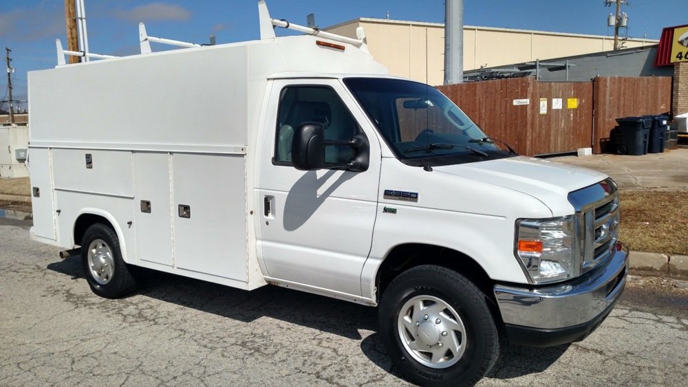

So what I've come to find out is that the 5.4 isn't my favorite motor, the one in the van chassis platform doesn't have any of the shitty head issues the truck has and the 5r110 is pretty bulletproof. I do like the 6.0 and have worked on/own plenty of the ls based engines... What it really came down to is the e350s have power locks and windows while the express chassis don't. I think I found a 2014 350 with decent miles I'm gonna pick up.
Somebody photoshop me a trailready winch bumper and 32" bfgs on there, can't wait to junk this thing up.
