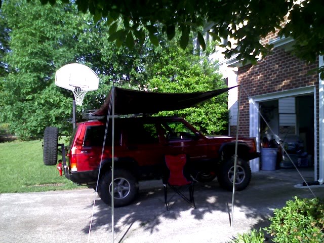

I found this might be good for a short break,but it just doesn't feel like it'll cover much area past a noon sun or having to move the vehicle to adjust for the sun.
I want to be able to walk under the shelter and have part of the jeep covered too, so I picked up a tarp that is 12'z16' so I can cover nearly the entire Cherokee, and have plenty of room to be covered.
As soon as I get the 12'x16' tarp fitted I'll post some pictures of what it came out like.

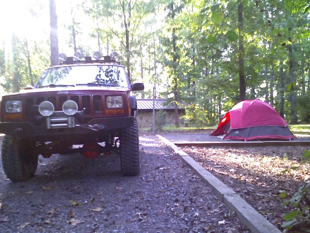

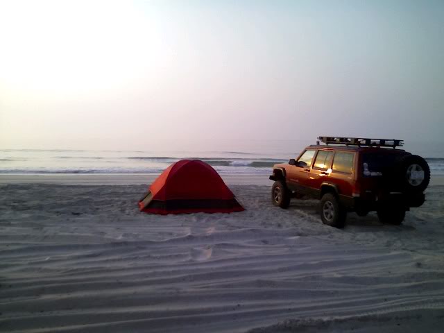

Get yourself a tent you can trust to keep you warm, dry and keep the bugs out if you're gonna sleep outdoors.
If you're gonna sleep in the back of the truck have some sort of air mattress. There's an R-value to the air mattress insulating you from below to keep you warmer or cooler, and the bonus of being more comfortable while sleeping (also great in the tents). I use a 2.5" XL sleep mat from Rei that I got on sale.

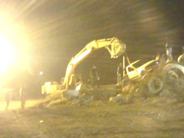

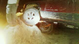

When all else fails have a friend with an excavator pull ya off the obstacle.

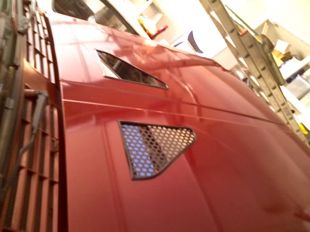

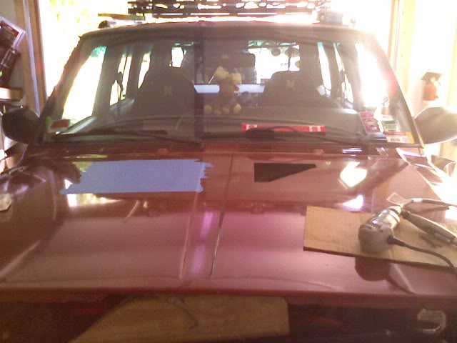

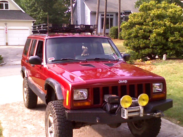

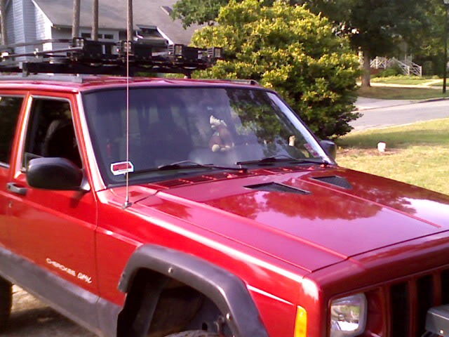

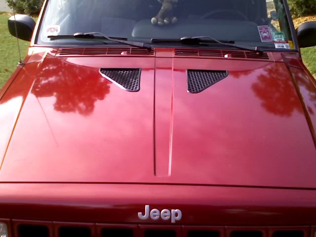

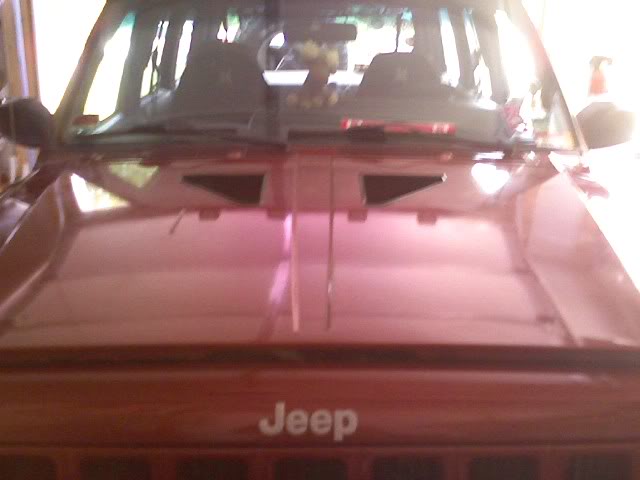

It occurred to me after a lot of this and overheating several times
That I should let some heat out.
After doing this mod I found that it did let a lot of heat out, but when it's 125 with the heat index it didn't matter, so I have deduced that the fan clutch is gone. What I'm doing now is a: water pump, a radiator, thermostat, and an electric triple fan conversion. There's not much worse than being stuck anywhere with the tide coming in and being unable to move your vehicle, so I'm going to try to prevent that from ever happening.
The awning worked great by the way, I had another size that was 12'x16' and it covered the whole vehicle and extended out a good ways for cover.

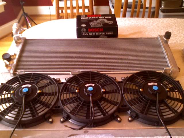

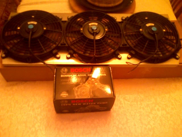

SO after the vents did help vent some heat but still had the overheating issue I decided to go with dirtboundoffroad's electric triple fan conversion.
I also picked up a new water pump to go with it
After this I plan on a two row full aluminum radiator and new hoses, particularly a lower hose with a spring inside to keep the hose from collapsing and overheating the engine.
In addition to the triple fan I plan on doing a zirgo digital fan controller

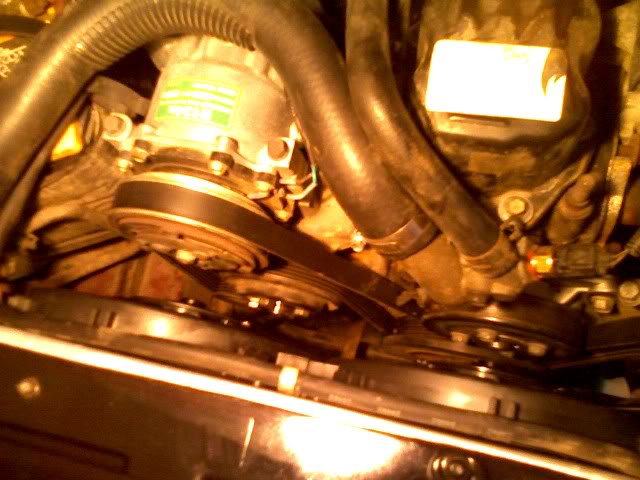

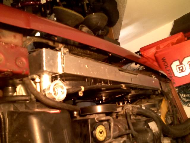

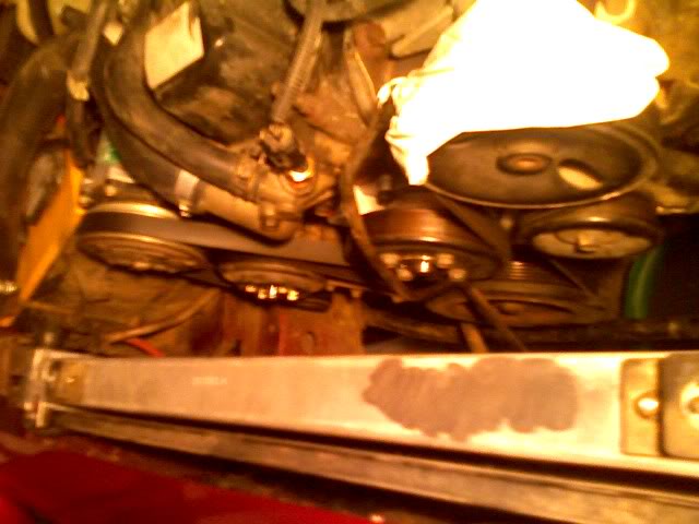

Test Fit number one:
The components used:

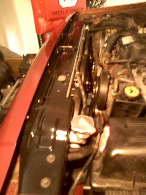

Clearances with mechanical fan removed:

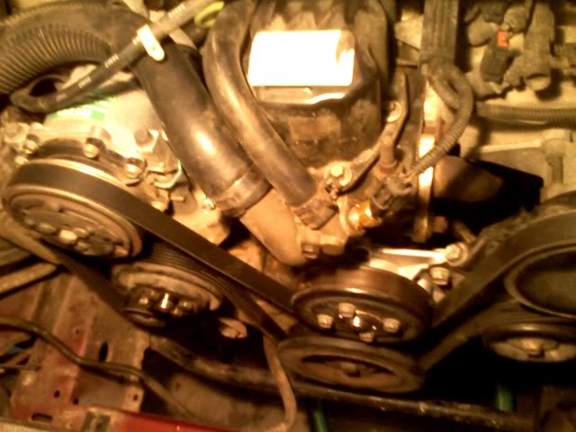

The bolts from the mechanical fan that replace the studs are 5/16-24 (3/4" long) from what I read around 20ftlbs torque on em:

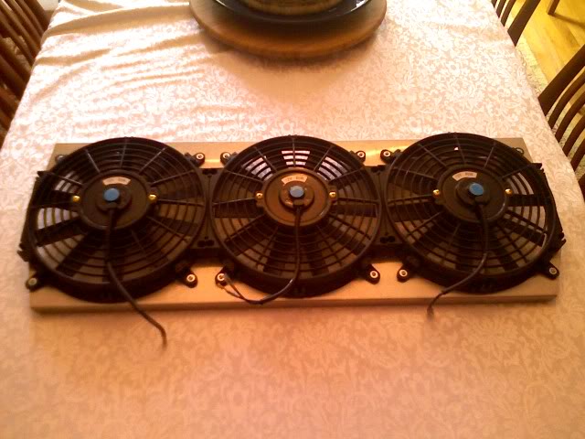

Fan conversion update: I anticipate an increase in MPG as I felt a slight increase in HP.
The fans don't draw as much air as I'd hoped, but it does keep the vehicle at 210. I wired two fans on a switch that operates off a fused battery line, and the third fan is run off a fused line off the original electric fan circuit.
May look into another type of 10"fan later. need more than an 80 watt fan I believe to get the draw I want.
Update on the electric fan conversion: I didn't get much over a single MPG benefit onroad. The intake was replaced by an AFE cold air intake, and it makes great noise without providing any gain in MPG. I still have yet to take the Jeep on a HW only run to test MPG on the HW. Cannot say these are any benefit for camping at all with extended wheeling
