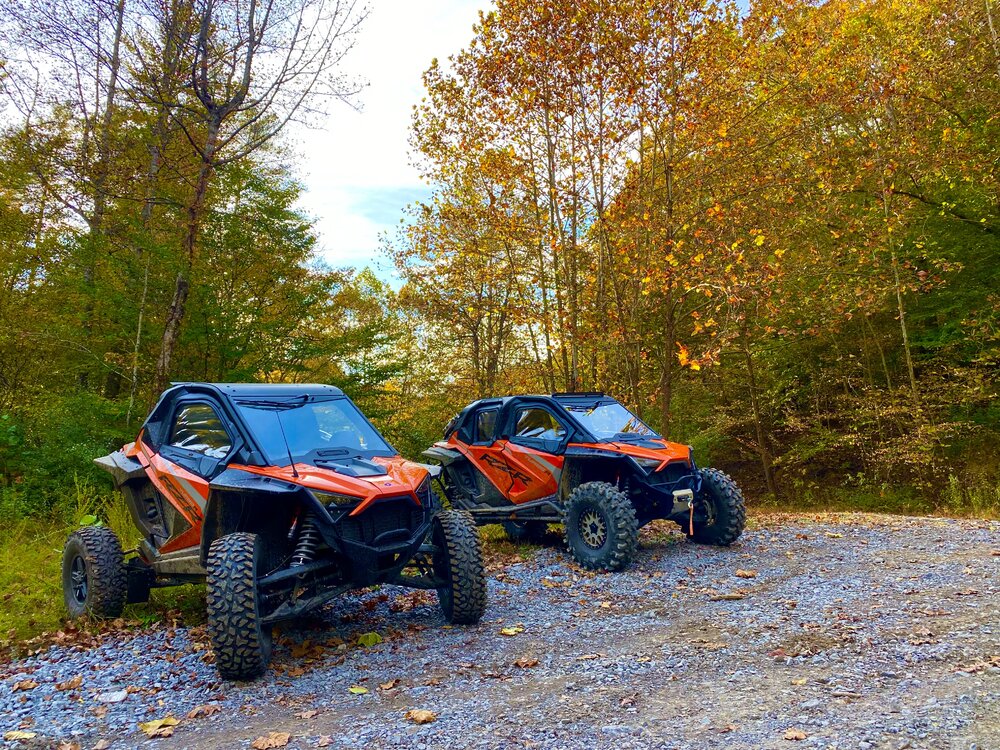

I think axles would be fine. Only thing we would use it for is our 2 sxs a couple times a year. Problem with selling is that it belonged to my grandfather, after he passed we have no idea where (or if) the title is so I think it would be a hard sell.

You got double RZR Turbo R money, but you're worried about difficulty of selling a $3000 trailer? Just go buy another trailer and keep the one you got.
