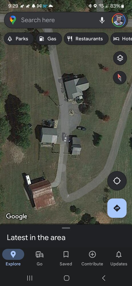

The fiber is terminated outside the house with a cat cable running in the house to plug into whatever router. This is the layout of the property. They don't need anything super fancy just something that is simple that gets them wireless internet to those buildings.
So would it work to use something like this?
Bridge
Then use a mesh system and put one of the 3 in each building? With a wired backhaul to each point to point deal?
So if I understand this the bridge takes the place of running wires from each satellite?
Seems too simple.
