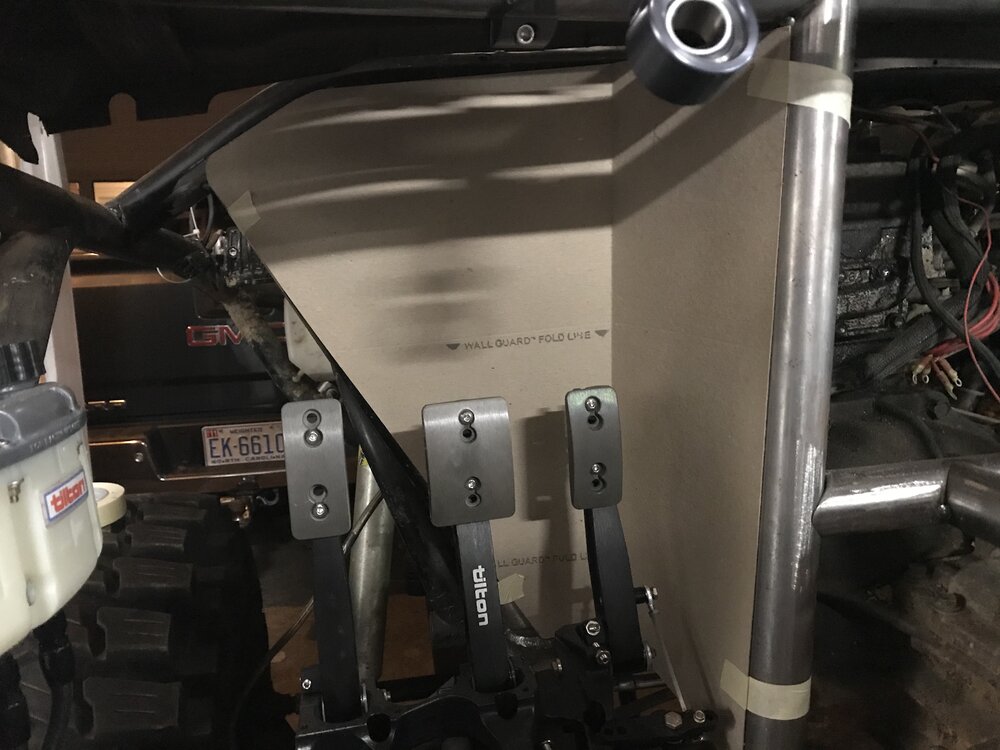

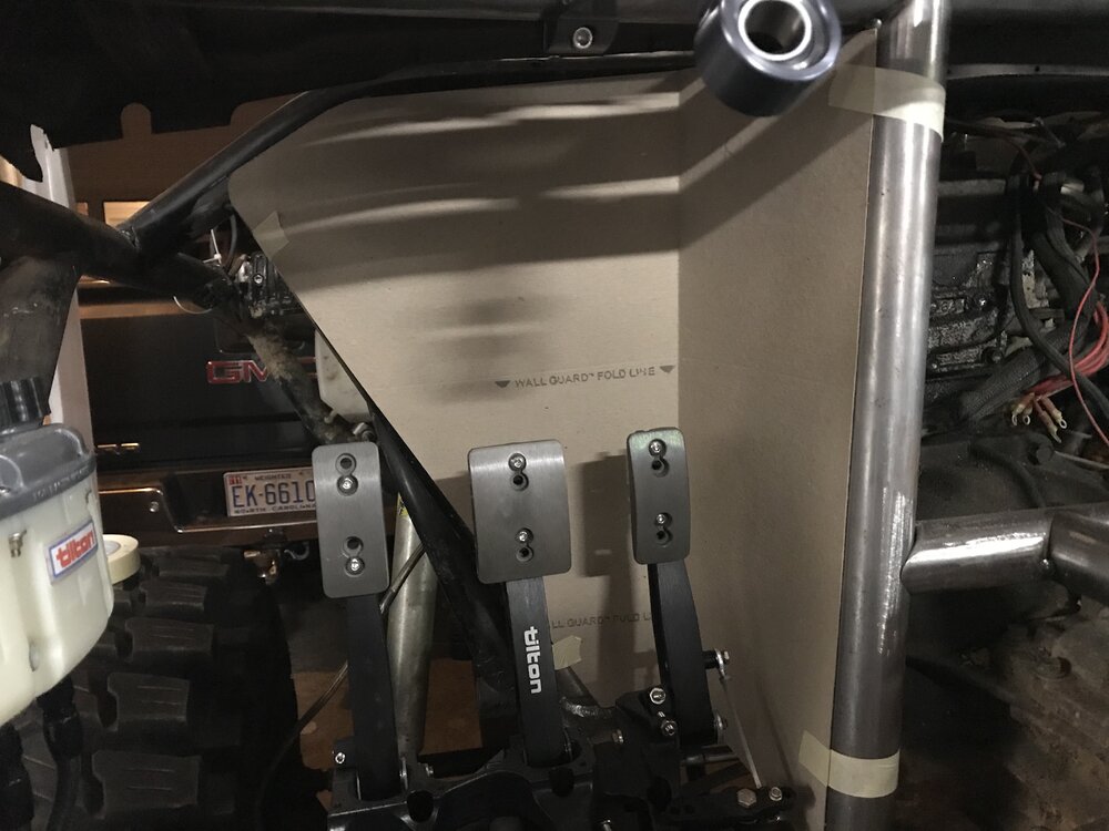

Hey everyone, just figured I'd start getting ideas for this stuff. Where/How do you get that special cardboard that works amazing for fabricating? From what I remember when working somewhere, it's not that cheap to buy new but I've heard you can source it from Costco/Sams?? idk, just looking for ideas of places to look. thanks

Just tape smaller sheets together. That works with smaller templates, too. If you're trying to fit it into a given space, the likelihood that you're going to nail it on the first try is nil. More likely, you'll get a piece to fit the left side, a piece to fit the right side, etc, then tape them together for transferring.
