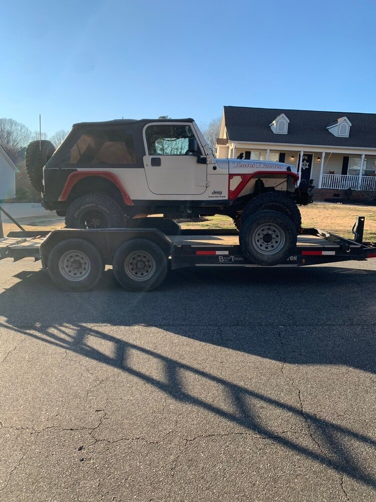

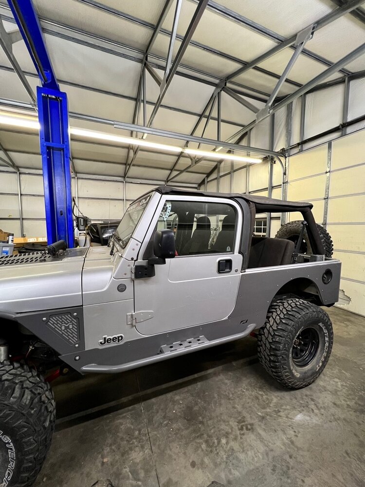

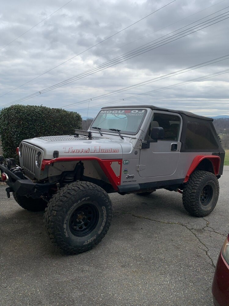

I picked this thing up about this time last year. Because when your single seat buggy has been sitting broken for going on 5 years and you have no time to work on it, the only logical thing to do is go buy another project to not have time to work on. I've missed having a streetable rig for years, and I'm a family man now so I needed something with room for car seats. I've always loved LJs, and have wanted one for a long time. The market on these thigs has really gone crazy lately, but I found this one at a decent enough deal that I felt like it was worth it.

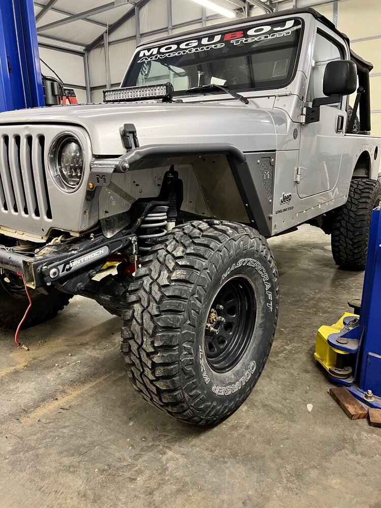

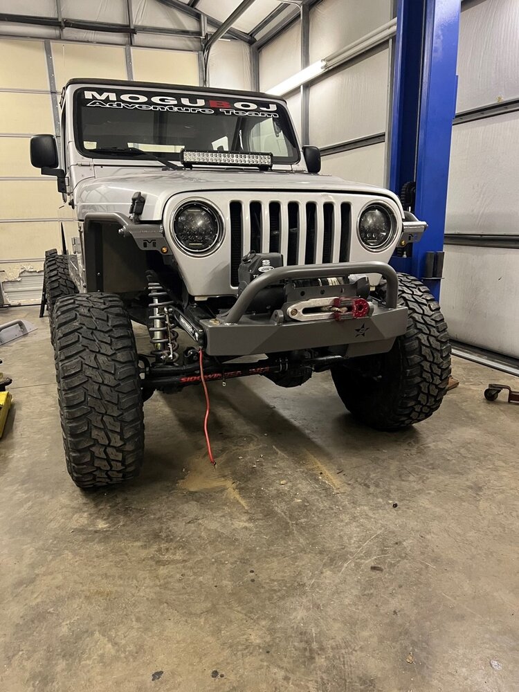

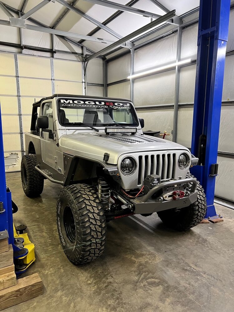

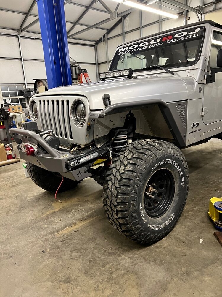

Currently it's your basic mildly built Jeep. 4.5" lift with 1.25" BL on 35s. 30/44 with 4.56 gears and a Spartan locker in the front and LSD in the rear. Most upgrades so far have been cosmetic stuff. But I already have a large pile of parts in the corner of the shop for a 3/4 link long arm, ton swap, and 40s. The goal is a rig capable enough to handle most trails, that I can still load the family up in for a day trip or jump in and drive it to work or around town any time I want.

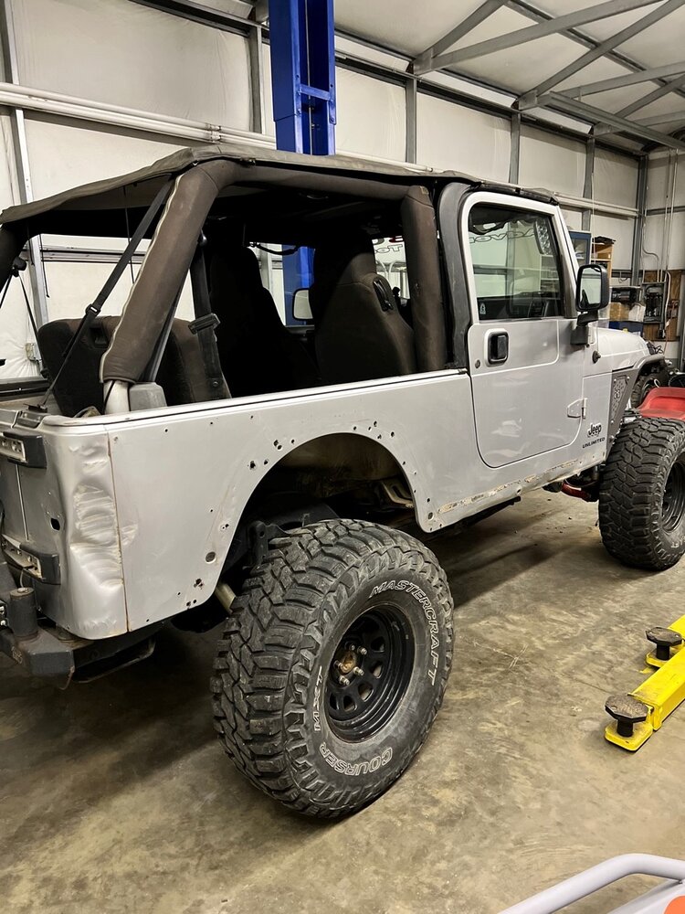

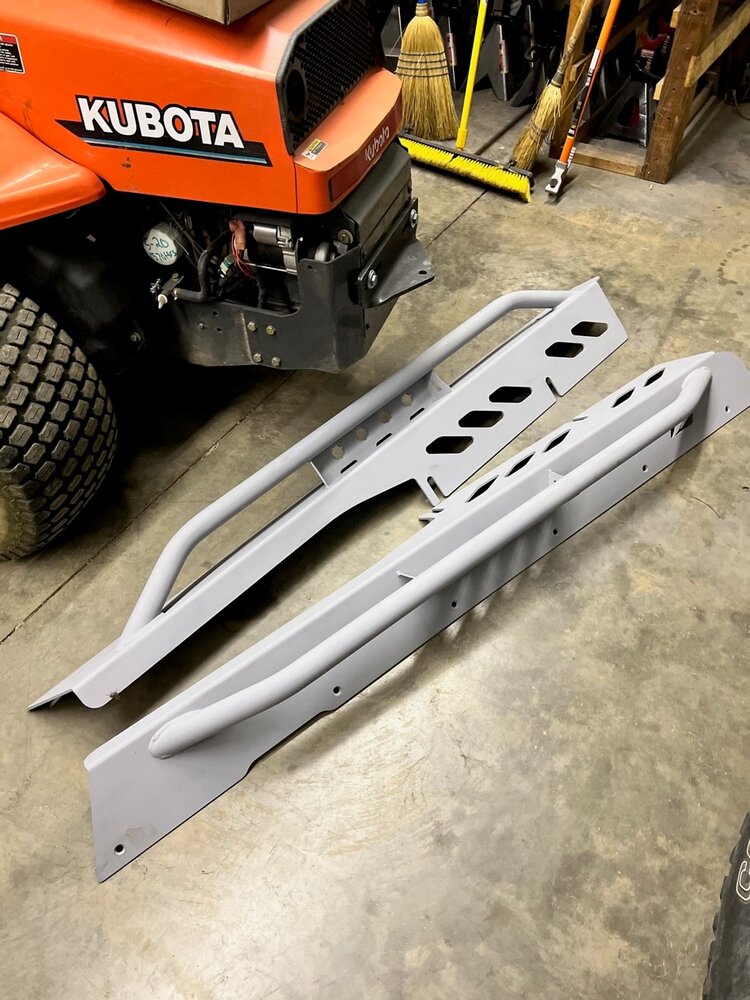

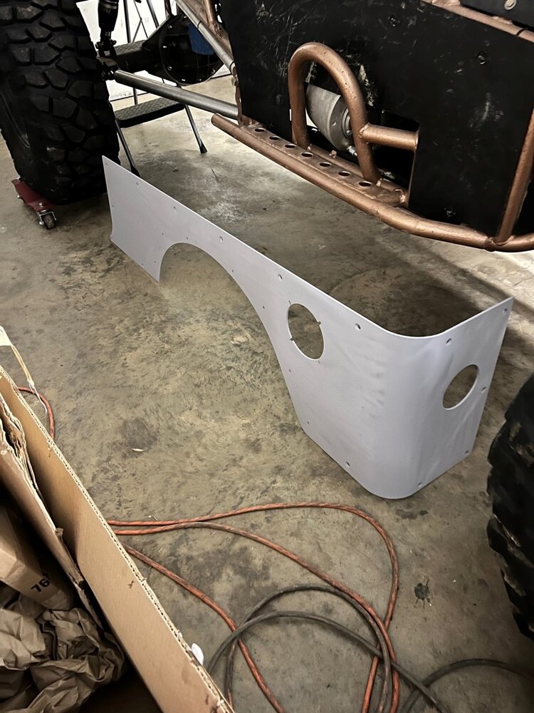

The first thing on the list to do was to get rid of the red fenders. I didn't care for that look all. I wanted something different than the black that most do though. So I ended up going with satin charcoal gray Rustoleum spray paint on all the armor.

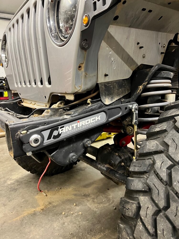

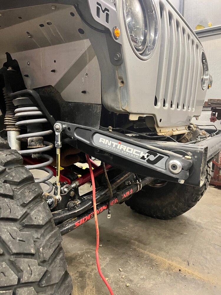

After that was an Antirock front sway bar.

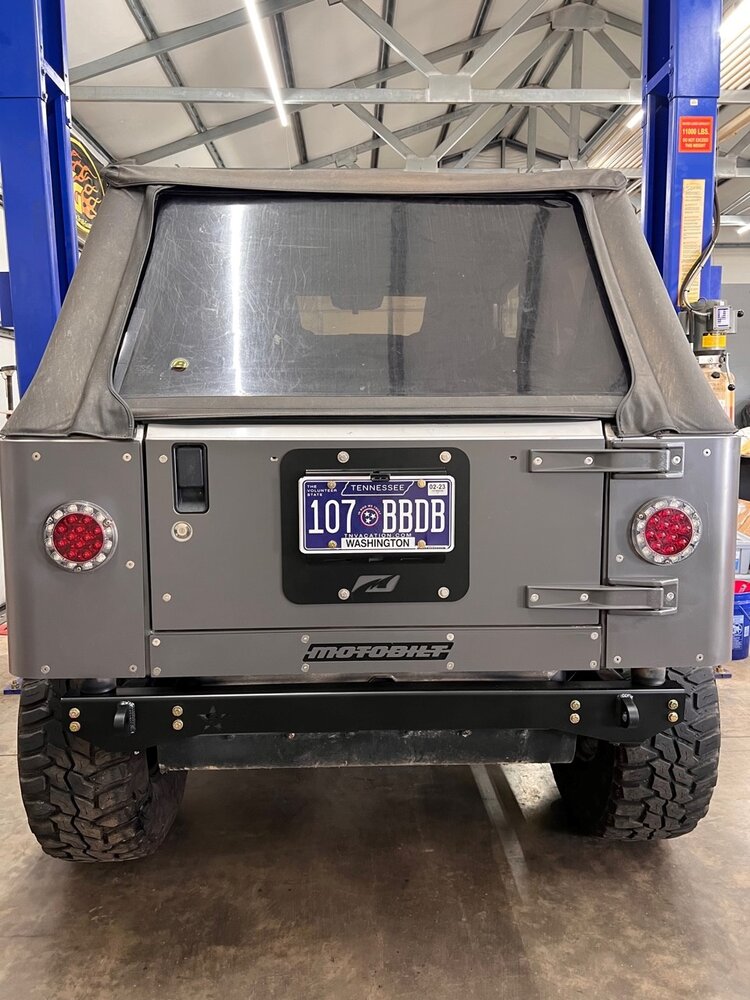

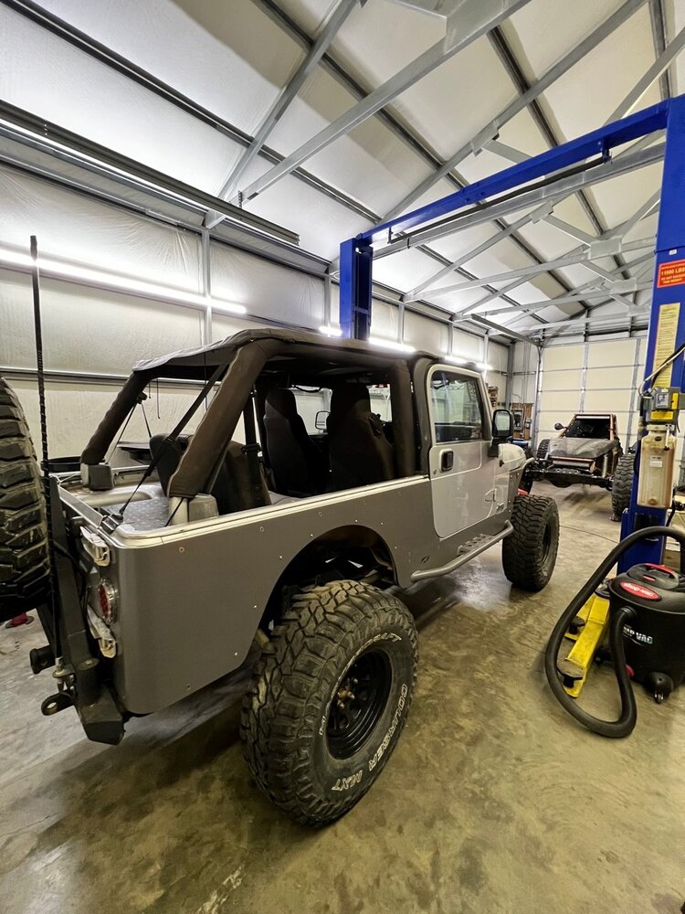

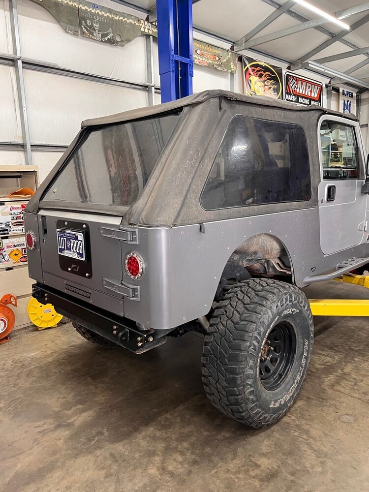

I wasn't really a fan of the look of the rear bumper an tire carrier either. It was a match for the old front bumper, it actually seemed pretty sturdy and decent quality, I just prefer the clean back look and once I get this thing on 40s I won't be hauling around a spare anyway. I ran it all this past summer, but took advantage of the Black Friday sales and picked up some Motobilt tailgate armor and tag bracket and the Barnes4WD tail plate bumper. I also swapped out the tailgate hinges for the older '97-'02 style for the cleaner look.

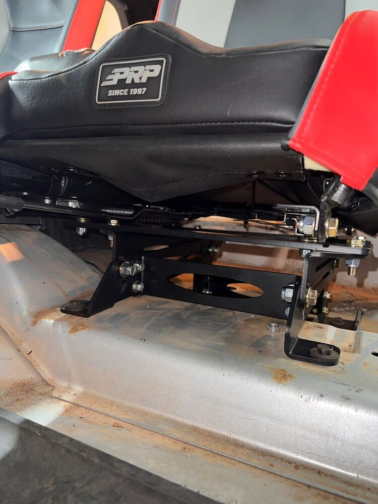

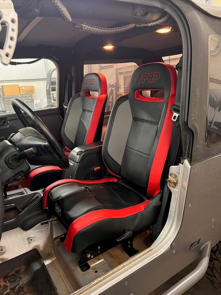

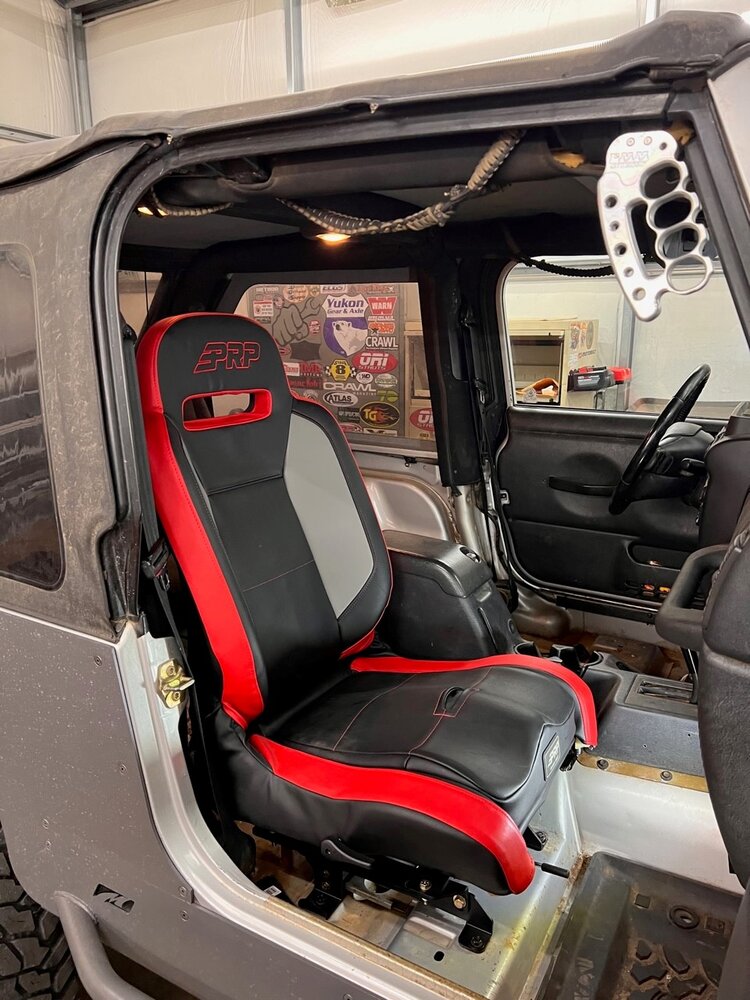

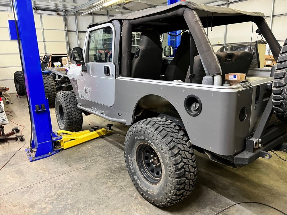

Just this past week I installed these PRP Enduro Elite seats on Genright seat brackets. Definitely not cheap, but a huge upgrade over the factory seats. My driver's seat was about shot anyway. I've got a bolt in harness bar and PRP harnesses here to put in, but I'm still debating on whether to put them in yet or not.

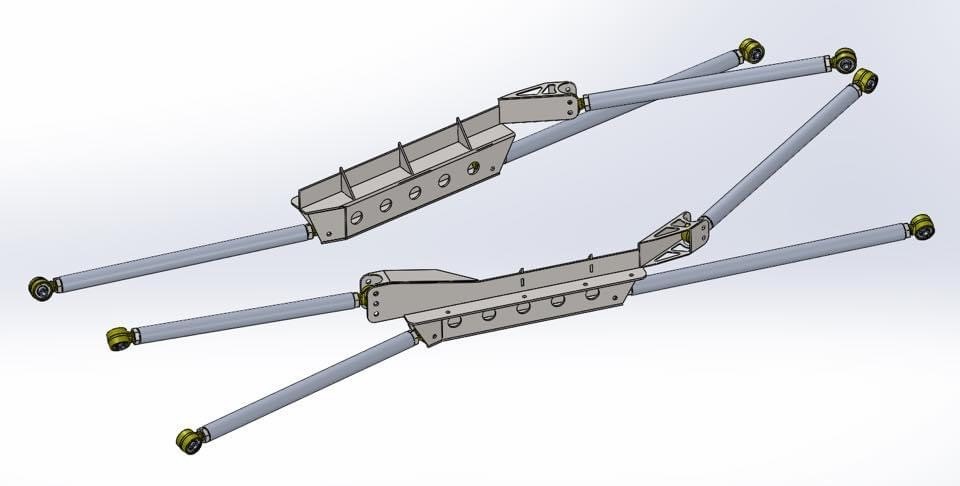

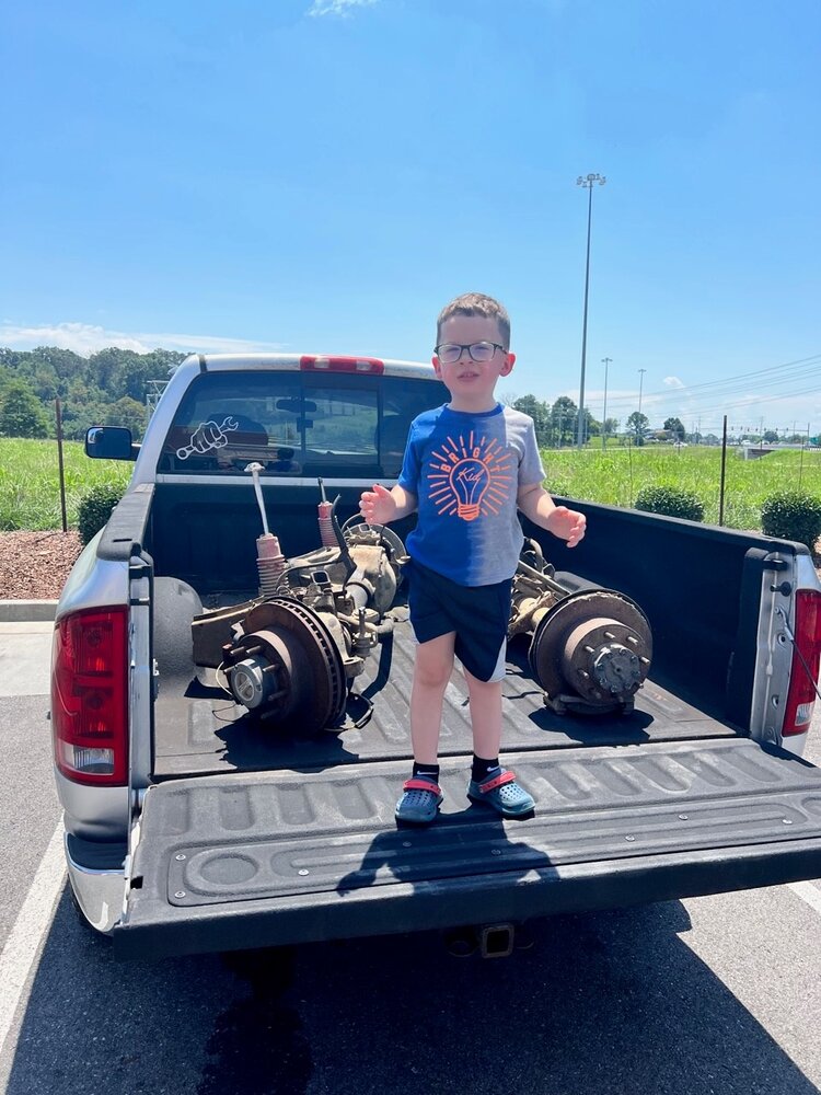

This will be the base of the suspension. It's a 3/4 link subframe kit designed by the guy who went by GTXRacer on Pirate back in the day. He designed and sold a few of these, but they never really took off. I was planning to get the Motobilt kit, but ran across one of these on Facebook for stupid cheap so I couldn't pass it up. I guess the popcorn welds on it may have something to do with the price, but it's all stuff that can be ground out and re-welded.
The plan for now is the axle swap with a small stretch staying on coil springs, with a swap to coilovers and more stretch down the road. And who knows if a LS might not find it's way under the hood one day.

-05+ 60/10.5 w/5.38 gears Detroit front and factory Ford e-locker rear
-4.3 Atlas (this is an old case that still has the small front output, but I've talked to AA and the upgrade is still available)
-3.5" Rock Krawler triple rate springs
-Rock Krawler 1.25" rebuildable flex joints
-PSC big bore hydro assist kit

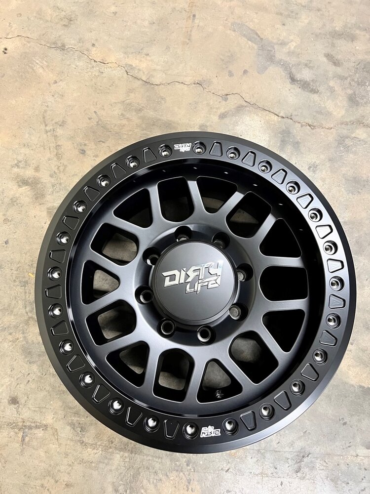

-Dirty Life Mesa beadlocks

I regeared that Jeep a few years ago. PO was a guy named Craig in the upstate of SC.
Solid rig man. He took care of it and wheeled it very lightly.
Yeah I bought it from him last January, picked it up outside of Spartanburg. He had actually had the frame swapped because the original frame was shot. The new one is clean as can be, the only rust I've found in the whole Jeep is on the passenger rocker, and it's covered by the armor.

Still rocking the stock rollbar inside or does it have a full cage? I have a solid harness bar in my rig, and have contemplated a removable one to make rear seat access easier.

Stock cage for now, the harness bar is a rockhard4x4 clamp on bar I bought off here a few weeks ago. It should be easy enough to remove for daily driving then throw it in for wheeling.
