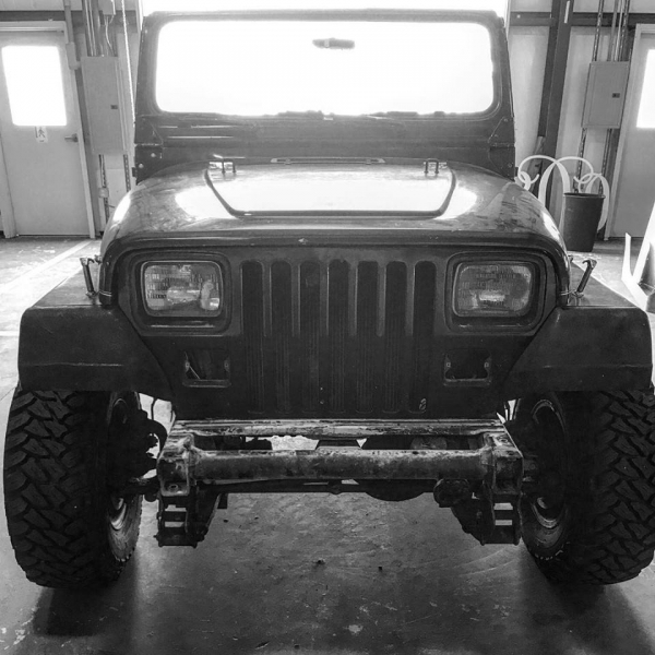

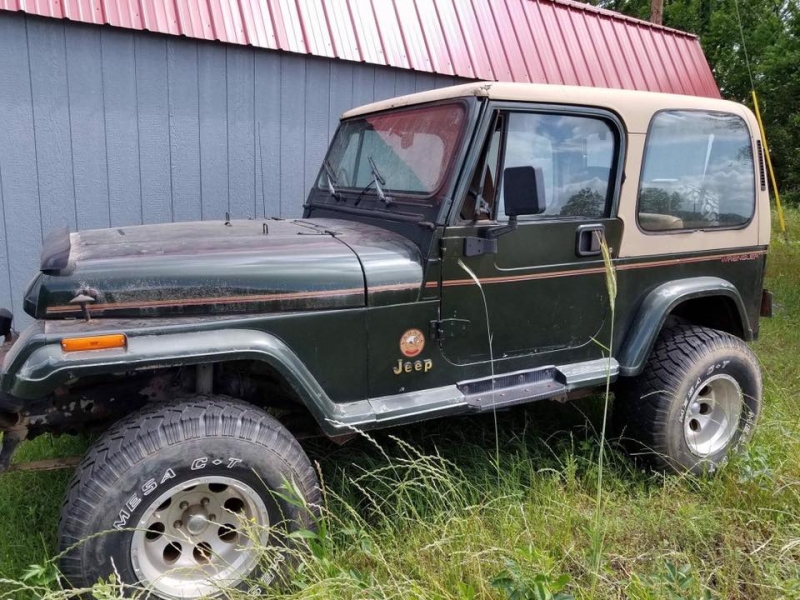

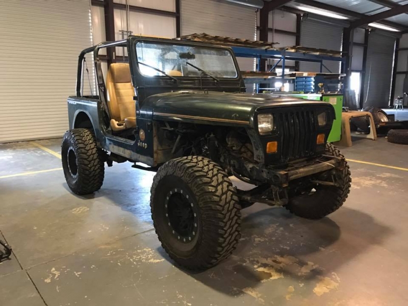

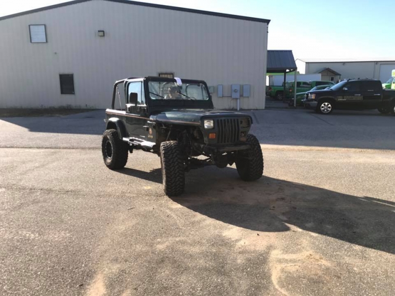

We found a YJ!

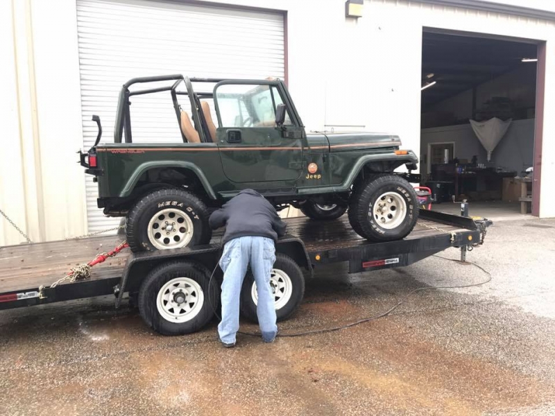

Once they made it back it was time to clean it up

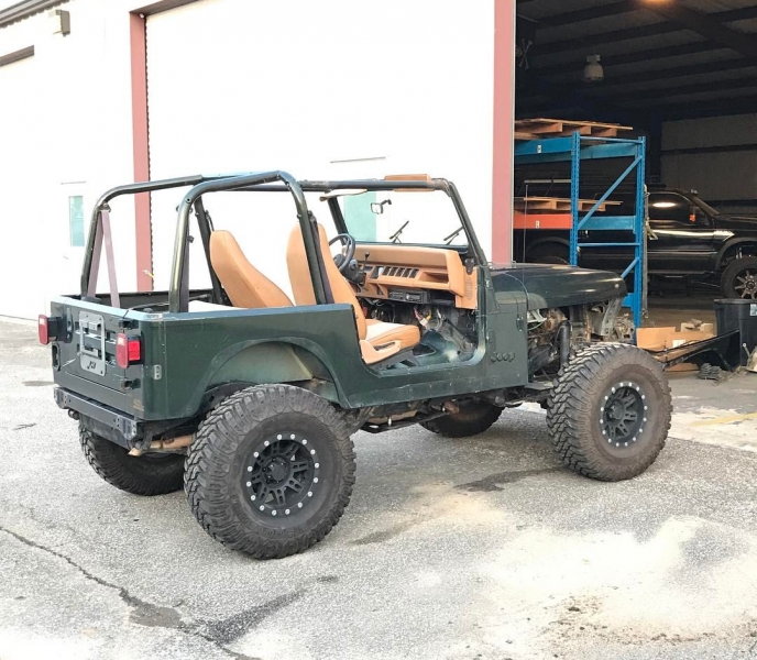

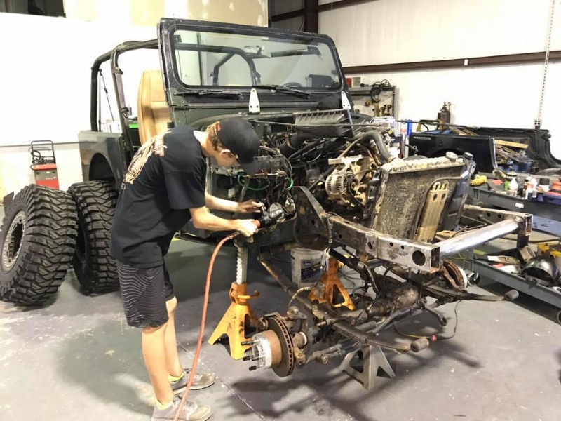

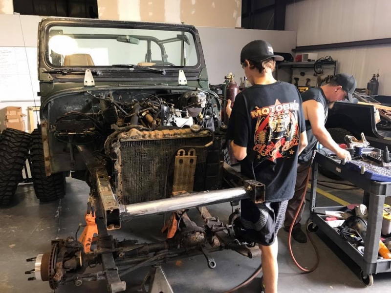

Stripping it down.

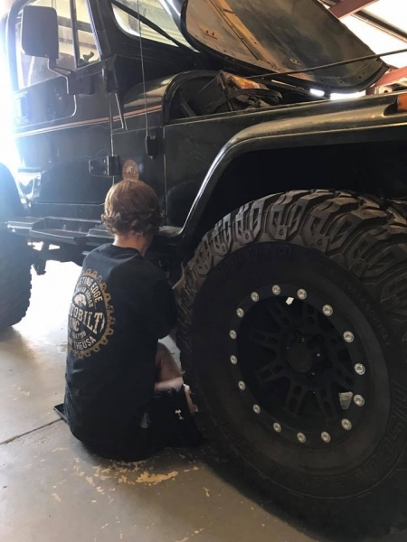

Trying out a different set of shoe's to see how they fit

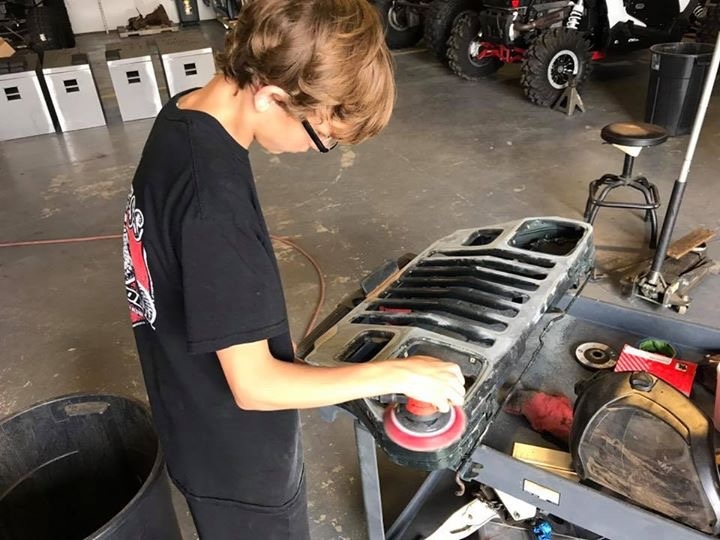

Hudson stripping the plastic crud off!

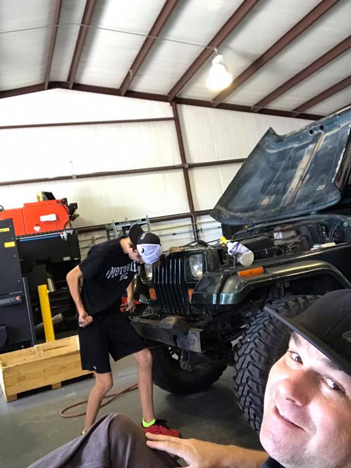

Now that all the junk is off he can get started
Wade helping replace the intake manifold

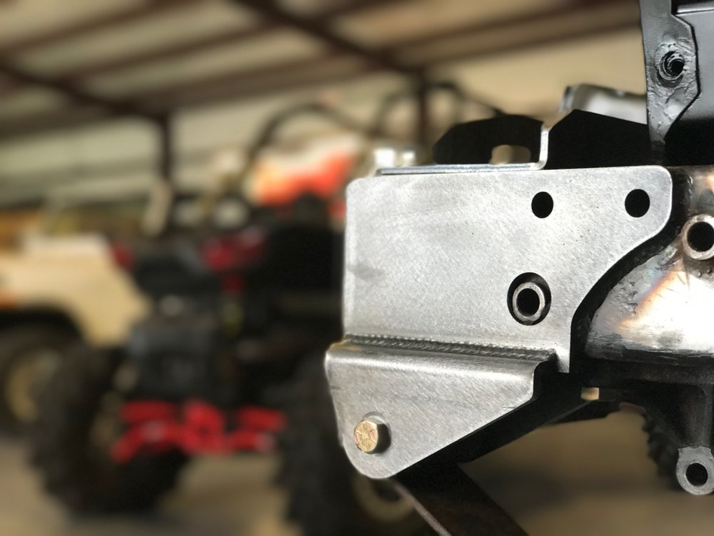

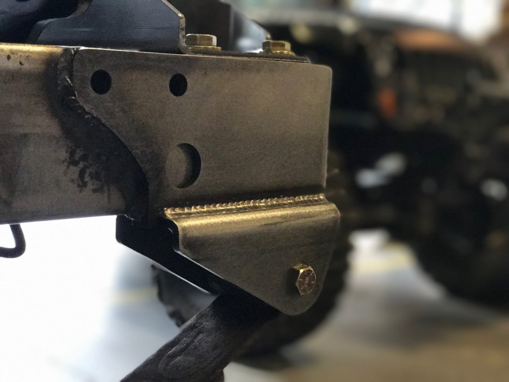

Hudson making sure everything is cleaned up on the frame in preparation for the Motobilt YJ full width kit. The previous owner welded the spring perches on the factory 30 too wide so the kit will work fine for now until some 1 ton axles are found!

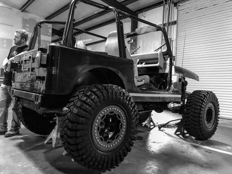

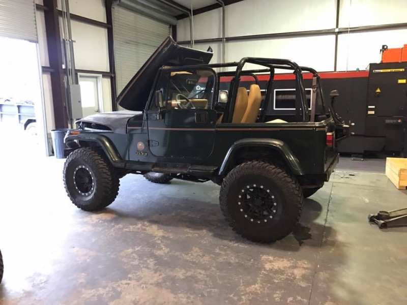

Hum 37" trepadors on 17" steel wheels with Motobilt DIY Bead lock kits? We will see.

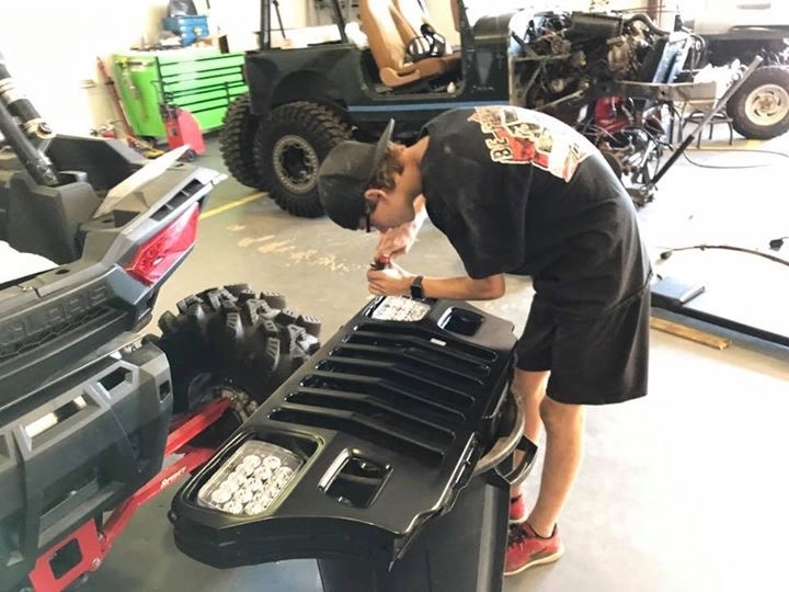

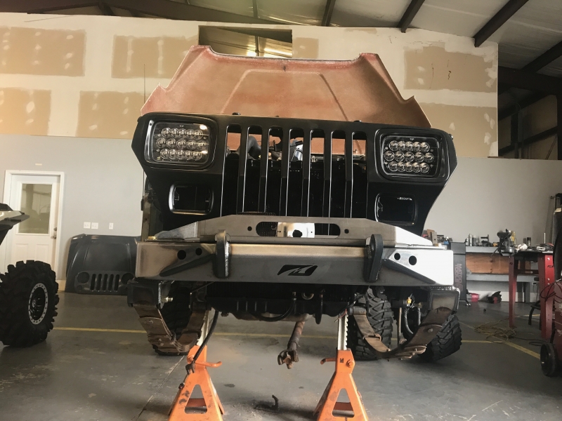

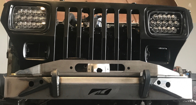

You have to have LED's on everything these days!

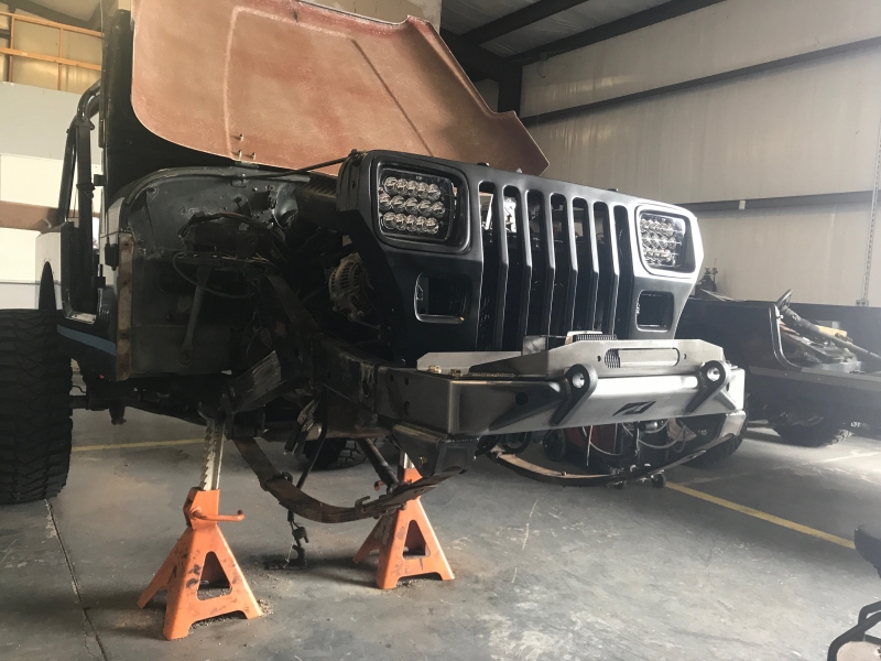

Even installed the Motobilt Full Width YJ bumper

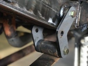

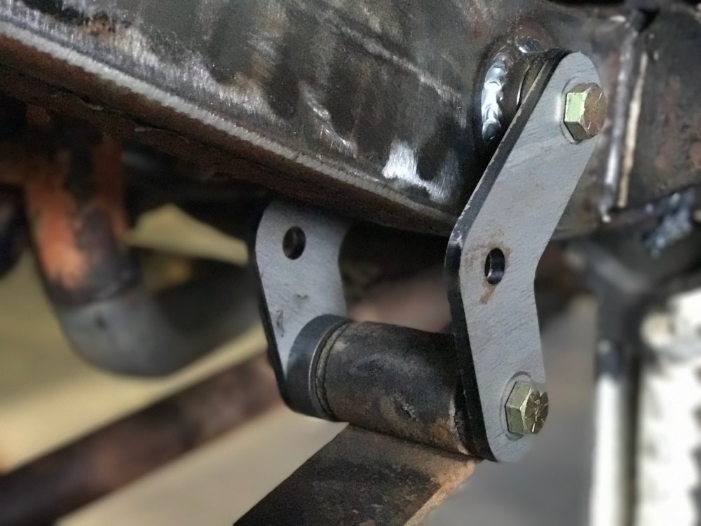

The springs are are in place with the new shackle reversal setup
