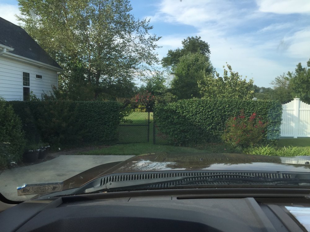

Here is mine with euonymus woven throughout.
The gate there is 10' wide
That's actually quite nice. I might be sold on the chain link. Did you have it installed or do it yourself?

@rockcity how long did it take for the vining to cover like that?
Believe it or not, that was a single vine on each side of the gate about 24" long when I transplanted it. I planted it like 5 years ago but it's been the same for the last couple. I take the hedge trimmer to it about once to twice a season to make sure it stays nice. Beyond that, it's pretty low maintenance now that it's established.
I also have it all the way down the side fences on the side of the house. It grows really fast. As it grows, I weave the vines about once a month in the summer through the fence. The main vines are about 3" diameter now. All the sprouts are easy to root and transplant. It makes great ground cover as well and chokes out most all weeds.

The builder installed the fence. I've done chain link enough to know to hire someone to do it professionally.
I like the vegetative cover better. Low maintenance and it adds some nice landscaping options.
