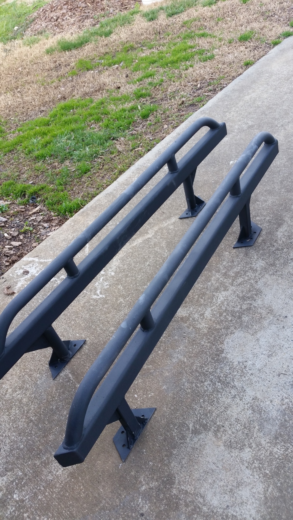

Here are the rock sliders that I picked up off of a board member and repaired. They turned out nice and was a simple fix that saved me a ton of money!

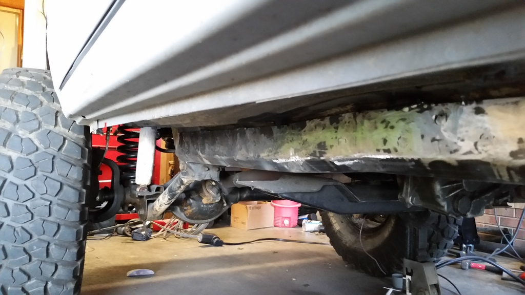

frame stiffeners are done, and they were honestly much more simple to install than the ruffstuff ones. total took me between 6 to 8 hours because its a lot of welding and grinding.
I began by unbolting the crossmember and grinding off the undercoating. This is where I learned that a 32grit flap disk is really what you need for that job rather than the hard grinding disk. I had all of the under coating torn off in less than 10 minutes.
Then I placed the floor jack under the jeep and pressed the stiffeners on to the frame starting at the rear and moving to the front I tack welded all of the sections into place. using the C clamp to make sure they were tight to the frame horizontally and vertically. ( make sure you do not pinch and fluid lines on the driver side)
Then i filled alll the rosette holes and stitch welded around the edges. after filling all the holes and stitch welding i ground the side and bottom flat removing all the excess weld from the stiffeners.
Ending up with something like this

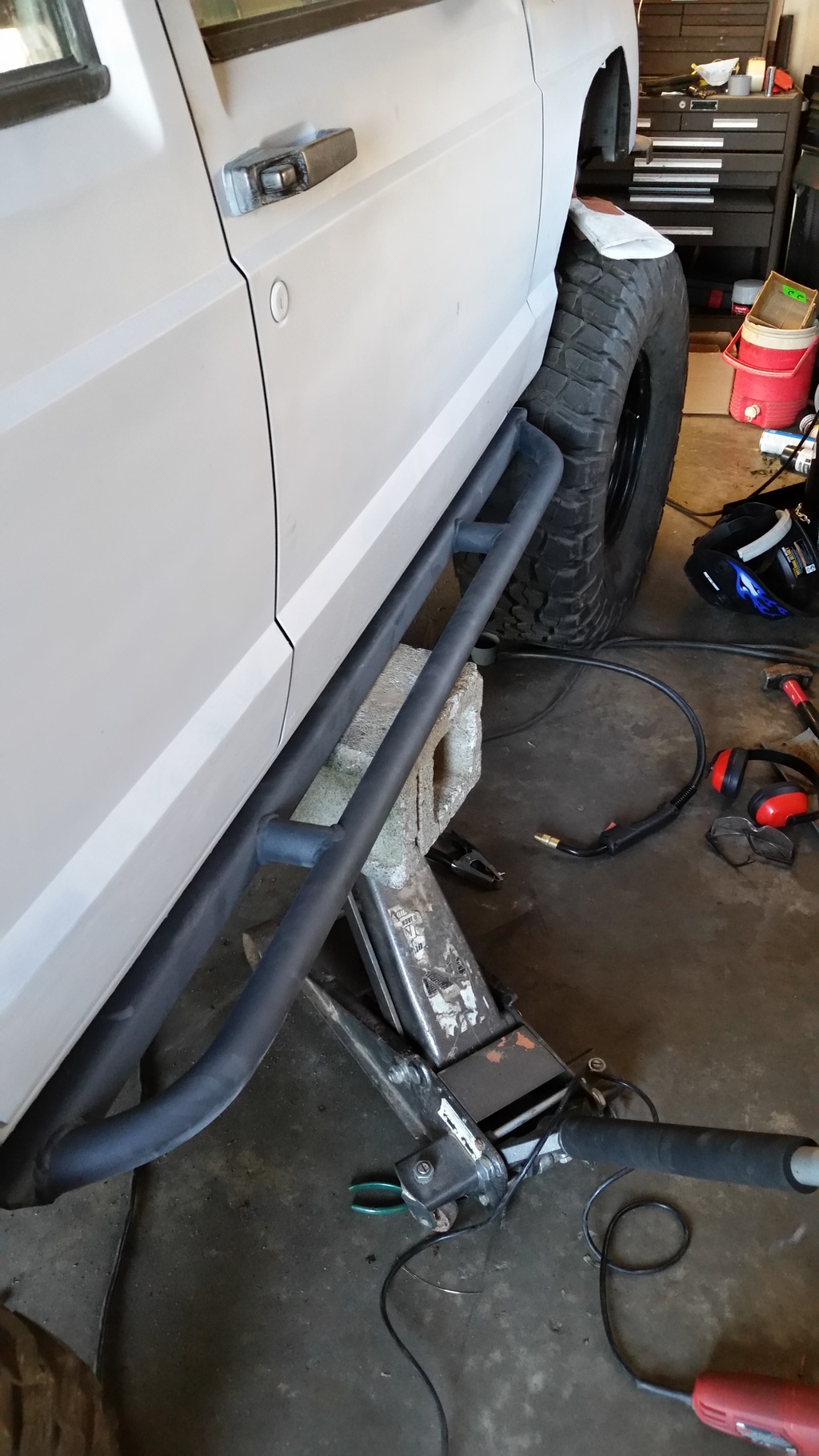

After finishing the stiffeners I mocked up my sliders and clearanced the areas that needed it.
tomorrow I will be drilling the holes for the sliders and painting the frame stiffeners and finally I will be ready to begin the 3 link build.
