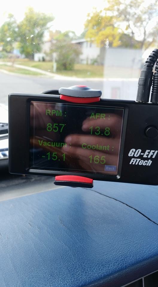

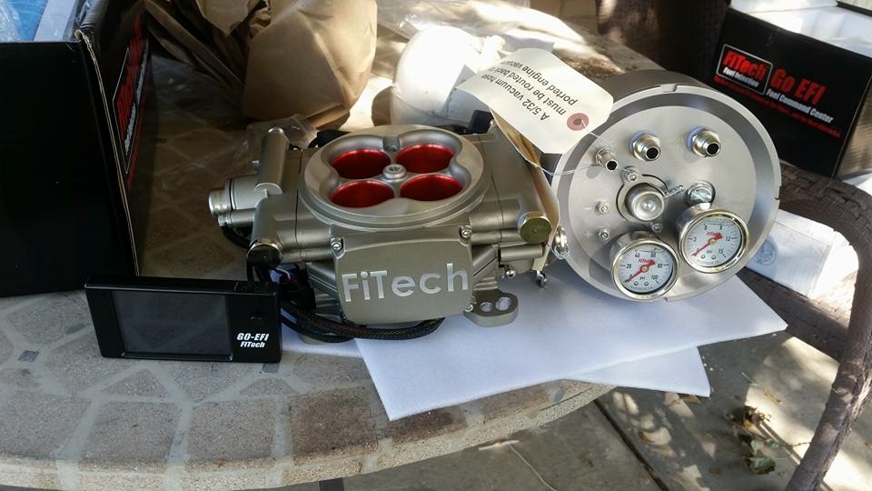

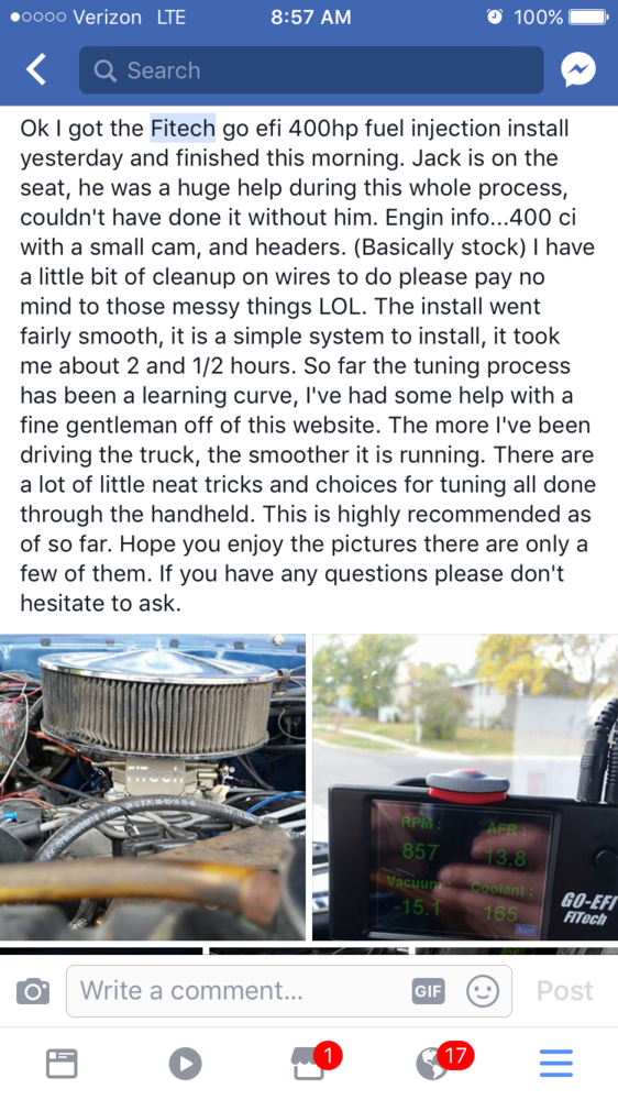

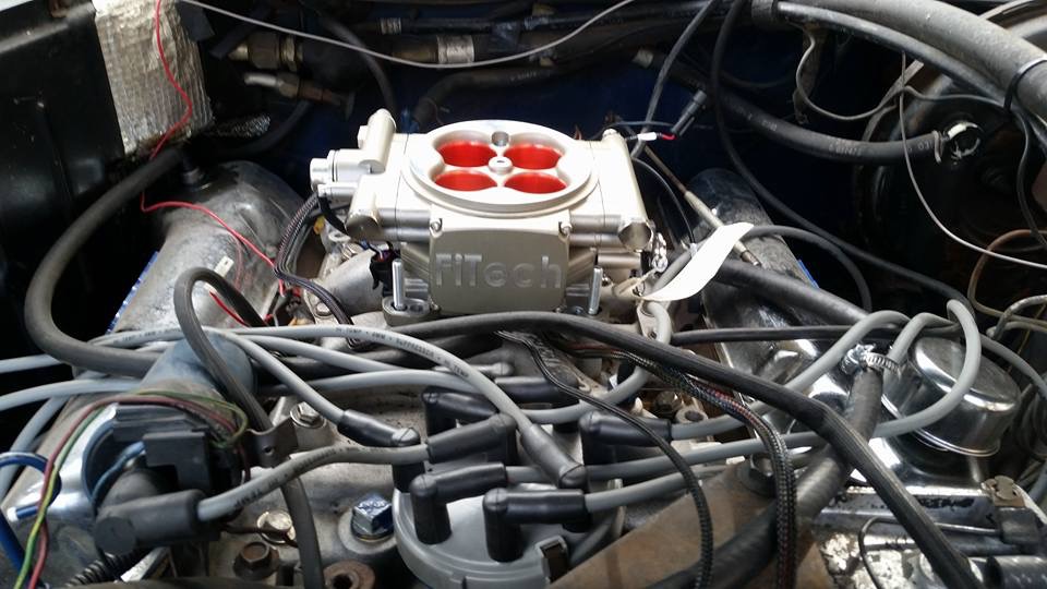

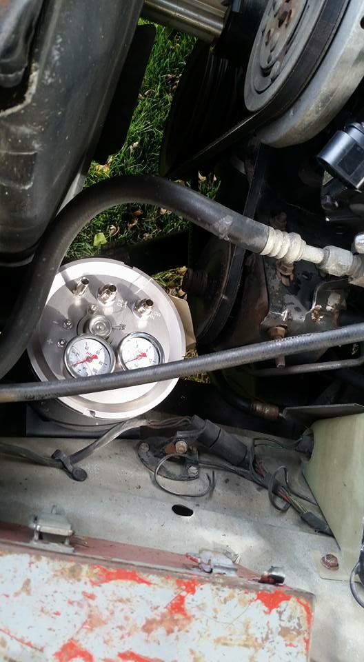

Seems to be getting great reviews from everyone in my groups. I have read though that after a couple months it seems to develop dead spots in acceleration, and haven't seen what the culprit is though. Here's a recent install.
