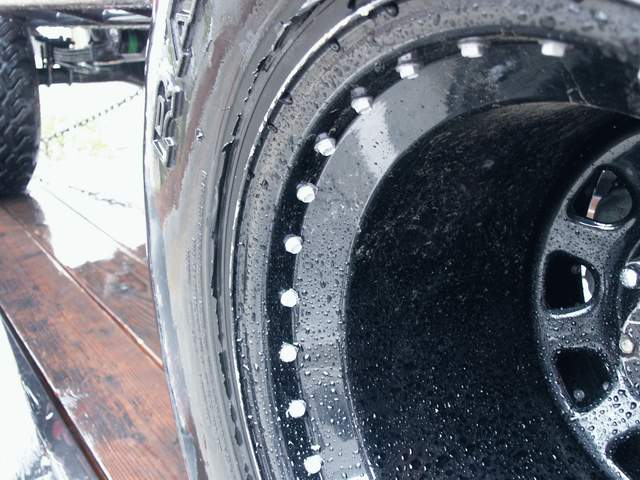

More than one way to skin that cat but I wouldn’t want to be behind a rig on a tight trail with sheet metal screws holding the tire to its bead. Some patience and saving some money for another month or two and this could be much more simple.
Most people think same but screws are spaced close together right behind the bead, it holds up really well. I wouldn't trust jumping a rig and landing on this setup lol, but I drove on a flat with many turns and bumps and good distance and put air back in it and went on.
Its not for everyone lol, after all its gotta be cheap junk rims and little time to spare
vs someone without beadlocks at all. W
I've been that guy many times in past and it sucked for me, and really sucked for the crowd behind. So for now I found solution to get me by
No way. I'm guessing John got all four rims used for around $100 or less. Screws are cheap. Re-centered H1 rims with stamped/pressed centers are not cheap, and the vast majority of rigs cannot run them without being re-centered.
Yep, got 5 37s with these rims for 300..not bad
Yessir, this I found out on my other jeep I had so that's why I'm not taking them out lol.
Its not that big a deal, to loose 5psi over a full week or so is nothing considering I have 60screws into each rim lol (yeah I'm doing pretty good as someone stated).
