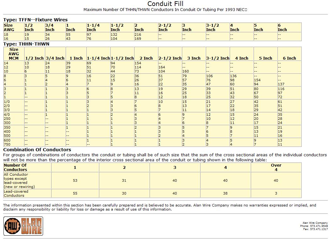

As for the electrical, it's best to have a junction box below the floor where you transition from romex to conduit or BX cable and then up to the receptacle box in the cabinet. You shouldn't run romex inside of conduit. You physically can, but it's not code.
Good point on the romex......I was going to recommend the MC/BX, that's what I usually use.
Alright, Shaun, granted I'm an industrial and controls guy, and haven't done houses in~5 years...
but give me some direction here. What code would prevent romex inside conduit? I know there is code to specifically say it is not required inside a wall, or unoccupieed space, but what would make it against code.
Something to do w/ the paper getting wet & breaking down inside the conduit allowing a fire.......I remember it barely from code class.
We had this type of floor in our other house and it held up amazingly well. I was very surprised. It was about 7 years old when we sold the house and it looked just like it did the day we moved in 5 years earlier. We have a 115lb Lab that loves to play in the house. After 5 years it had zero scratches.
However, out new house has nice dark hardwood floors. After 1.5 years its all dented and scratched up from use. I guess it just gets like that but that laminate stuff just plain takes the abuse!
just don't get it wet
To explain the romex and conduit question,
When running conduit you have to figure the fill factor of the conduit, It all depends on cable size and amps. The cables must have area in order to keep from over heating. Romex doesn't allow you to figure it due the caseing, The figuring is done by single conductors. Running open ended conduit over romex is ok, Just don't have it in a closed raceway. IE box to box conduit.
that is crazy logic.
Crazy is Box Fill Figuring.
Here ya go
