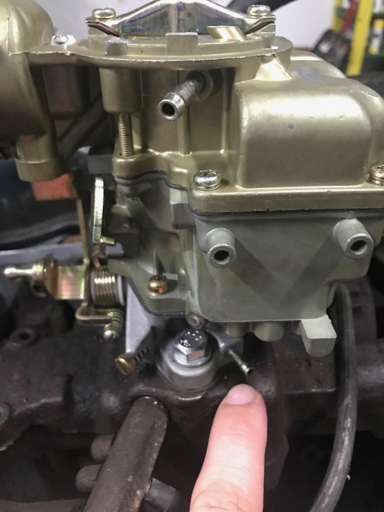

Decomp Your atv ally Joined Nov 24, 2010 Location Midland Jul 23, 2017 #1 Do these two get plugged off or do they get hooked up to the vacuum port? The one on top too? I replaced intake with a non emission one.
broncosbybart Is it 5 YET? Joined May 15, 2008 Location Charlotte, NC Jul 24, 2017 #2 Bottom port goes to the distributor. I plugged the one on the top.
