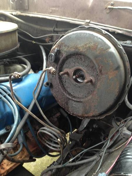

What I started with...

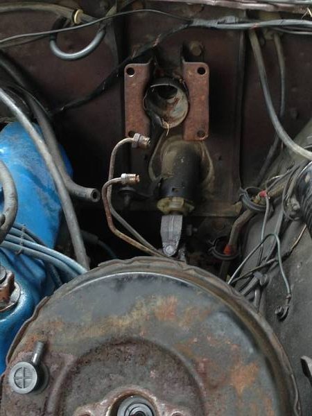

MC off...

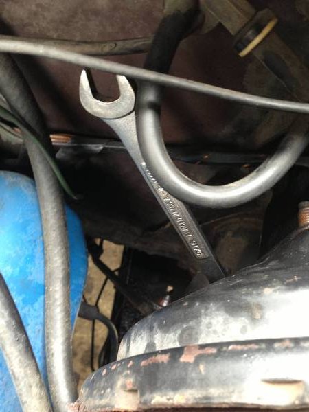

This nut on the backside of the booster is a bugger to get off...but the rest were easy with the hood popped reaching down between the back of the hood and the cowl...made much easier with a ratcheting 9/16" wrench.

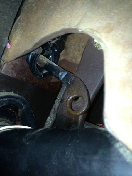

There is a bolt, bushing and nut that holds the booster arm to the brake pedal:

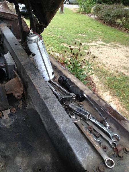

All the tools you need to remove the booster, MC and the bolt on the brake pedal. You'll need a double flaring tool for the rear brake line (rear on the MC) since it's a different sized fitting. I had a tube working kit to get good straight tube...results might vary. You'll also need a 3/8 brake line wrench for the bleeders...again...results might vary. But the tools you see are all you need for booster/mc removal and install.
Now that everything is out...reverse the order to put everything back in. If you don't count the bleeder battle or me fubar'ing the flare a couple times, you can literally have the old booster/mc out and the new ones installed, in an hour.

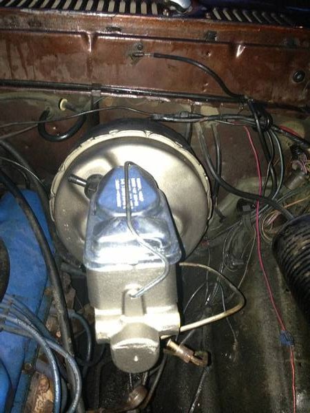

The finished product...

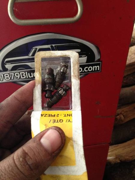

And here is what was left of the bleeders when I took them out...
