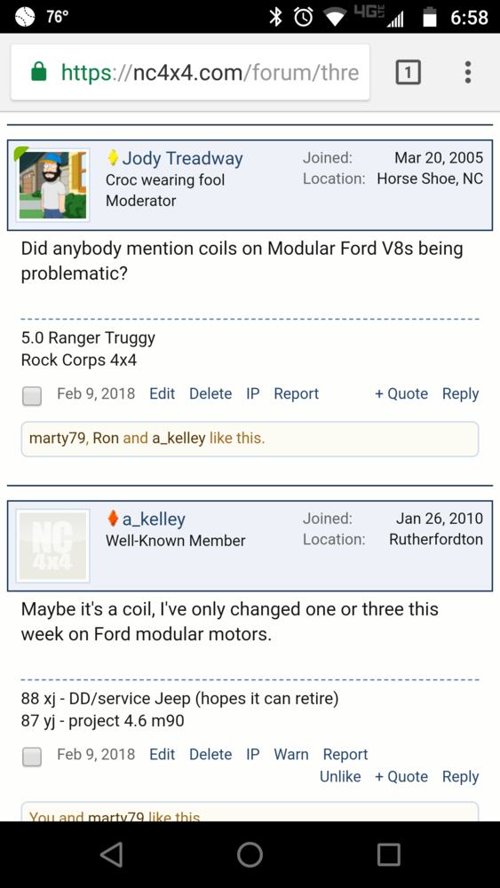

Ummmm. Touch mean this thing hasn't fixed itself in 3 months?
hey easy now I stated was gonna buy ford coil but guess what it's not the coil..or plugs. freaking stupid crap that's what it is, dam ford design engineers of the hood cowl
