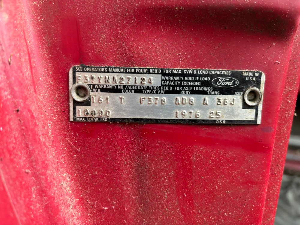

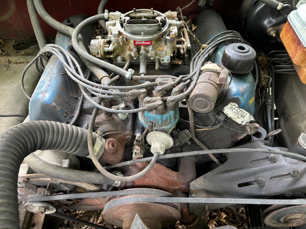

1976 F350... needs a flywheel and we're going to do the clutch while we're at it. It has an NP435 with PTO. Is this a 390 or something else? I want to make sure we get the right flywheel.
The GE612AA would also cross reference to a 360.
So assuming someone didnt swap motors and re-use valve covers or any other number of tomfoolery...Id bet 360

I’m an old school ford guy, I love them, but…they’ve got so many different fly wheels/starter teeth counts…that’d be my first check.
Chevy tended to leave things good enough forever.
Ford was never satisfied and constantly chasing perfection. There can be so many flywheel combos, or head combos …
