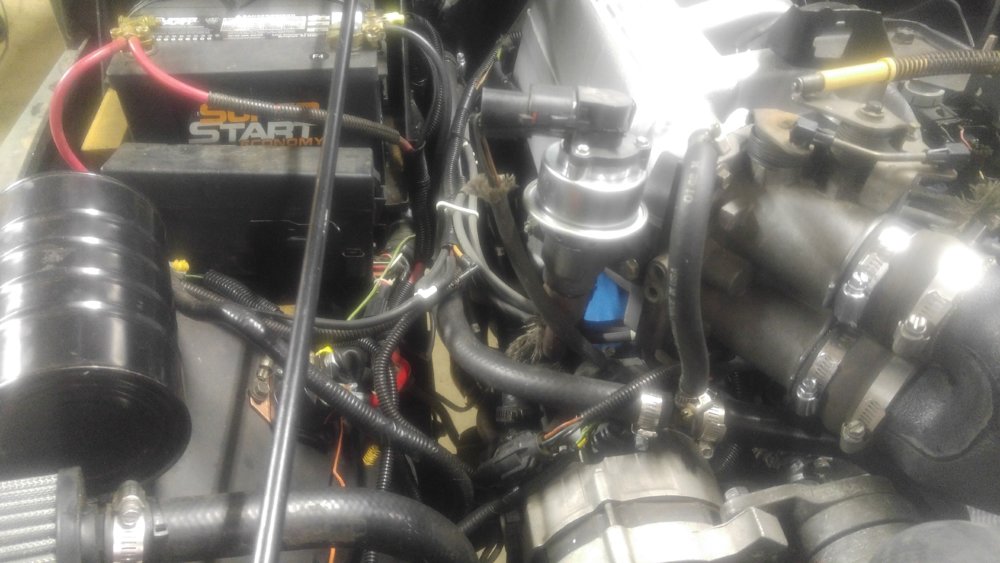

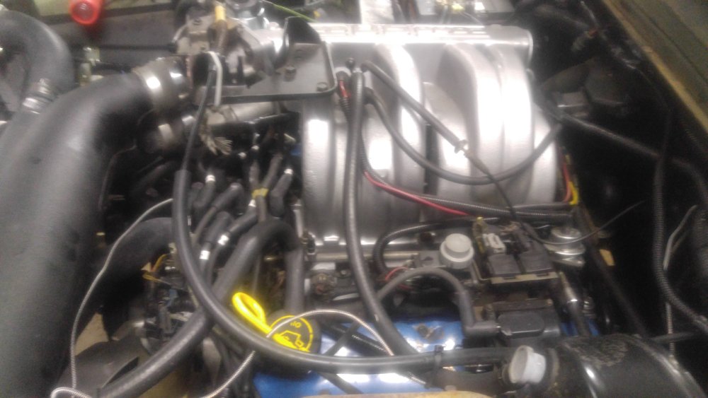

Need some help. I have a new to me YJ with swapped 91 truck 302 and Ford efi. Manual trans. Complete with egr, smog, all sorts of vacume lines the whole nine.
Its a speed density sytem from what I gather. I believe I could learn most of it and I got a good gist, but I'd like to simplify it. And from what I gather future cam ugrades want make it happy. It's also currently not real happy and running a little rough and harder on fuel than it should be ( or I presume).
1. Strip it down clean out the clutter and run it.
2. Holly efi system to replace the Ford comp and wiring. Keep intakes and Ford hardware.
3. Holly efi carb(throttle body) and a carb style intake

Thoughts...............????
MAF conversion will definitely make future upgrades easier (possible).
Is the engine basically stock? If so, getting it running properly shouldn't be an issue.
Start with verifying timing, fuel pressure and no vacuum leaks.

And fuel pressure seems suspect. It doesn't pull or rev out like it should. Timing is dead on rulled that out.
Fuel pressure straight on the rail a good start?? Have to get me a gauge. I don't think the pump on the rail is anything special I'll have to check. I need to look up what this system requires.

Correct, check the pressure at the rail schoader valve. Any parts store will have one for cheap. Should be around 35ish running and when you unhook the vacuum hose from the reg it should rise around 5 psi.
You can delete the EGR and smog pump without any issues. It'll clean things up a lot.

My thoughts are to keep it simple by addressing and repairing what you currently have. The truck EFI systems are dead nuts reliable and quite simple.
Before I went backwards and swapped in a carb or spent $2k on a Holley EFI conversion, I'd diagnose what you have. Fords EEC-IV EFI is a really good system. As long as you aren't swapping cams or anything like that, the OEM electronics will do just fine.
*Verify fuel pressure running and see if it drops rapidly once turned off. If it does, you could have a stuck open injector (among other things) that would explain your issues
* Unhook the pressure regulator vacuum hose and see if there is any raw gas on/in it. If the regulator is leaking, that can cause your issues as well.
* Verify your engine to chassis grounds. Really, really check them. That oversight cost me about $600 last year...
* Check spark quality to make sure you have adequate amount
