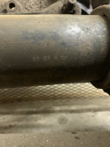

So I was looking to get shafts for a kingpin I have.

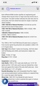

I looked at ECGS site and saw that they had different shafts for later model Ford kingpins.
Didn’t know if anyone knew how to identify which axle I have.
I was always under the impression that all 83-98 Dana 60’s ran the same shafts.
ECGS site and RCV have a break at 88...
See pics below.
I have called ECGS before for a question that had nothing to do with me buying anything. They were willing to help me and spent like 15 minutes on the phone with me for $0 sales. I guarantee if you call them and ask, they will be more than glad to help you and determine what year axle you have.
It shows on the screenshot it's the length of the short inner axle. Ones an inch longer. Measure yours if you have one.
It's a 1/4" longer on one side and 1/4" shorter on the other.

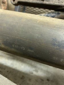

The forward facing side of the driver's side axle tube will have a 6 digit number stamped on it. The numbers are about the size of typewriter print. Google Dana BOM, cross reference and rock out.
Look on the housing there should be a date code that will tell when the axle was built.
Thanks guys.
It’s a 89-91 thanks Jody and @1-tonmudder
