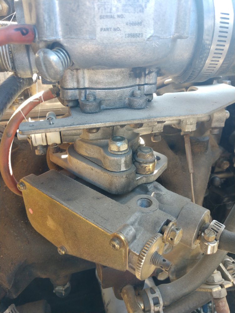

if not the mixer and regulator serviced.

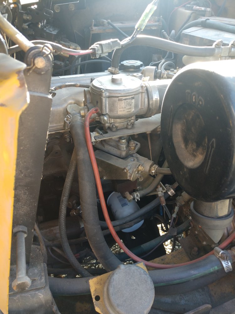

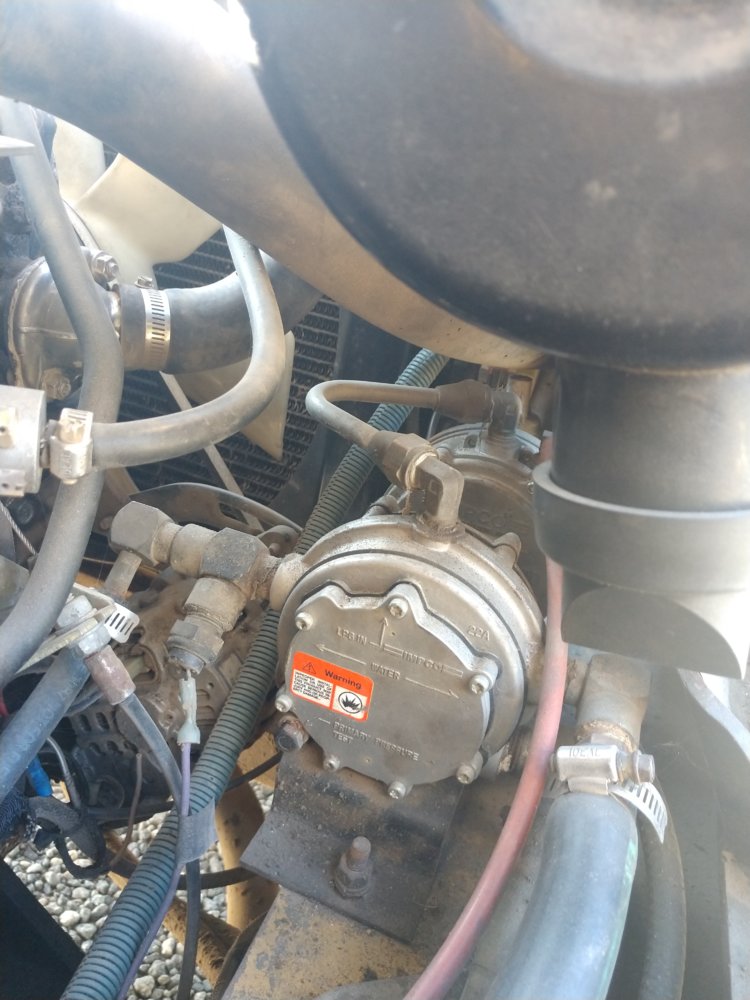

If that's the two big round things that are in the picture that Supply the propane to the throttle body those were serviced/rebuilt within the last year.. is there a simple way to test if it's being flooded those times where it won't start
The mixer is the carburetor. The other 2 look to be the regulator and maybe a lockoff. A better pic of them, so they can be identified would help.

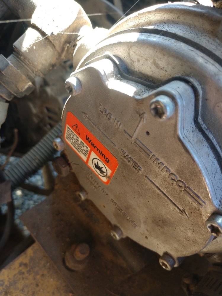

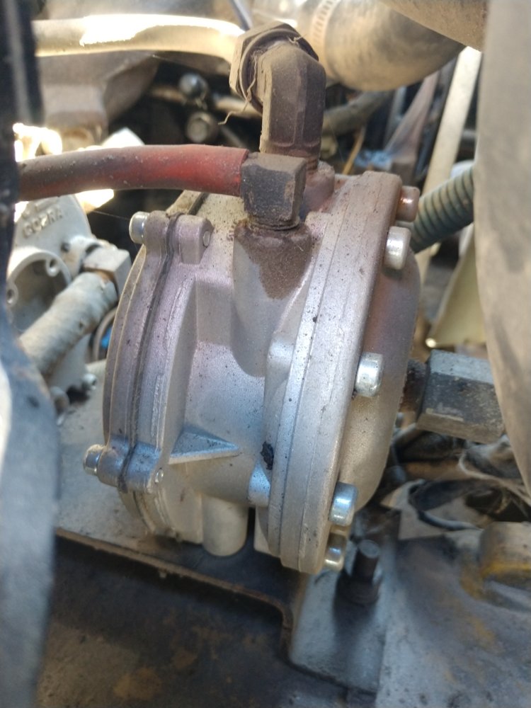

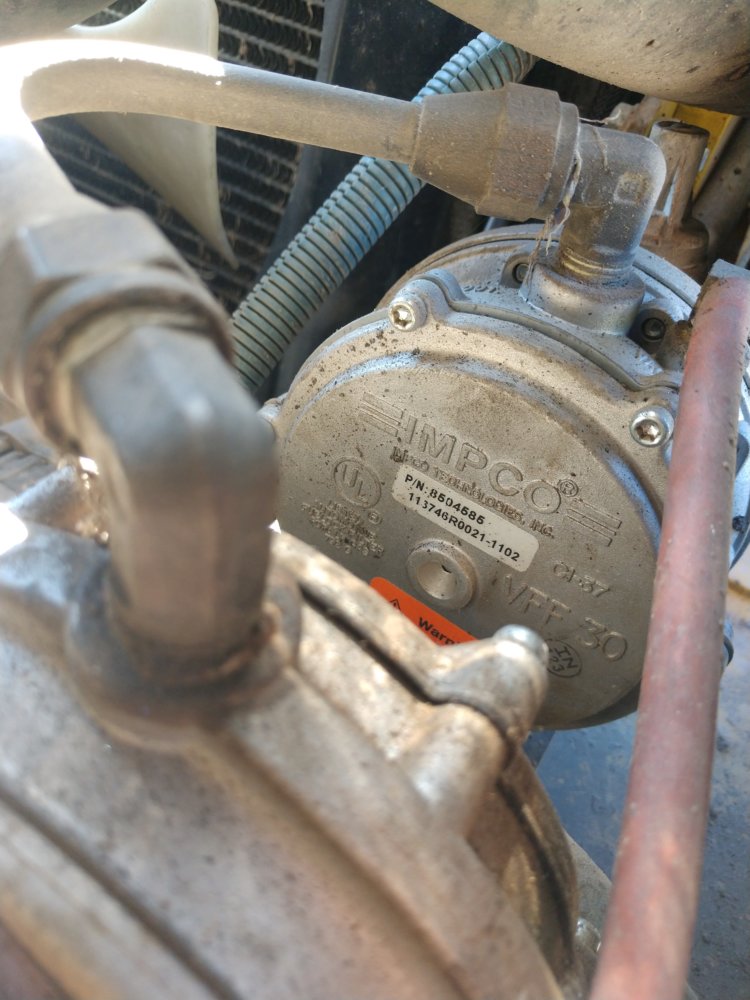

So the round unit in the back (VFF30) is a vacuum lockoff. That means, if the engine is wore out or low on vacuum, it will have a hard time pulling the diaphragm open. The one in front of it is the regulator; it converts the pressurized liquid fuel into gas. There should also be coolant lines flowing through it, or it will freeze up and not work.
You should be able to look into the air intake on the carb and see the diaphragm moving up and down, from the vaccum change, when throttle is opened/closed. Not sure what the contraption is below the carb.

The regulator is likely full of tar and when it gets hot at full temperature and you shut it off The Regulators is not fully seal back. It will cause the engine to flood it start. Replace the vacuum lock off at the same time, they are common to get stuck and let gas flow even when there is no vacuum. They are both very cheap to replace, probably about 60 bucks a piece you can even buy them on Amazon

Flooding is actually a huge problem in the forklift industry, propane Regulators whatever setup you may have the most common failure is to Rich condition. Normal failure is fail to start
This comes from service technicians not draining The Regulators during service to remove all the propylene and tar from the regulator which intern eats up the diaphragms in the regulator
Just for educational purposes that Contraption below the mixer is the throttle governor, it regulates engine speed at Max RPM, basically air flow goes through a throttle plate spring tension at certain vacuum can close it up to limit engine speed
