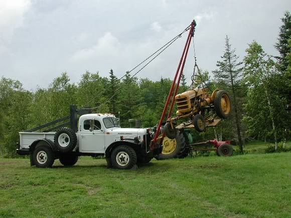

if you can get your jeep into where the stuff is, and if you have a winch on said jeep. make a crane for it. two poles 6 tabs. you can make it in about an hour. you'll also need a ratchet strap and a snatch block, and a couple d rings. I might have a pic of my setup. I use a small atv winch and it will lift about 1k lbs.
Yep, got a jeep crane...max out at 600# (most I am comfortable with)....wanting to do up to 2k lbs....
