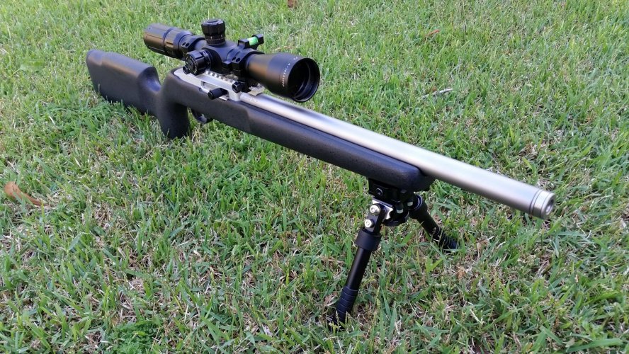

Well my Kidd project completed, I went with some friends this past weekend to do some long range shooting with .22lr. The goal was to shoot out to 300 yards dialing out and back. All of us have the glass with the travel needed to get there and it was just a fun thing to get together and do.
I bought this rifle with a factory receiver and a Kidd 20" barrel, Kidd bolt, Vblock and trigger. The Boyds stock had been professionally bedded with a steel bedding block. I replaced the receiver with a Kidd and 20moa Kidd rail and a Kidd 16.5" barrel. This rifle at 50 yards will stack lead on top of lead. At 100 it will hold well under an inch. At 200 it will hold under 3". Wind is hard on 22.
We shot based on ballistic calculators and most all ended up pretty close out to 300 yards. After we had seen 300, it only made sense to take it farther.
400. Yep, 400 yards.
I Took it all the way to 400 yards with 3 different ammo types. Eley Contact, Federal Gold Target 711B and Federal Bulk (for giggles, but it surprised me and some others). The Federal bulk is not subsonic and is a lighter bullet. Most would tell you that accuracy will go to crap as it comes through the transition from supersonic to subsonic. As we found out, theory does not always meet reality.
Dialed the scope out through 400 based on my ballistic calculator Strelok. Zero was 50 yds. Actual dope was as follows. I have 17.3 mils of up left after my 50 yard zero, above 17 I held using the mil reticle. We were hitting steel and looking for a "group" at 400 that simply made a noise. At 300, depending on the swirling wind, a 10 inch was possible.

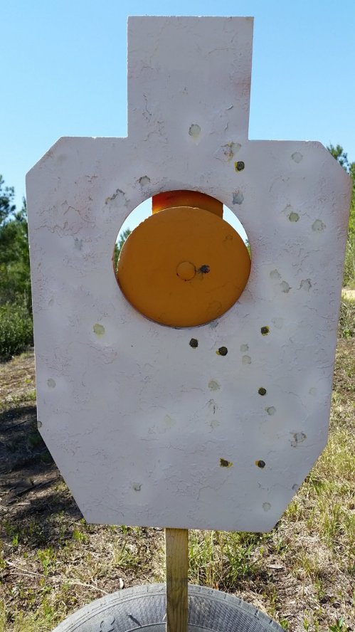

This is one of the 400 yard targets. You can see how I walked the shots up the steel once I connected.

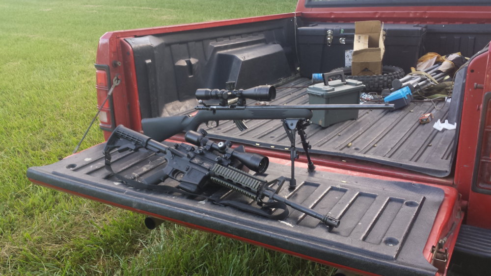

Man, we need to get together!!! I love shooting .22 as far as itll reach. Ive got a cheap setup, but it works great to 200 and holds on at 300.
Savage Mark II - bone stock except I had my smith put some weaver mounts on it.
BSA Sweet .22 3-9x50 scope

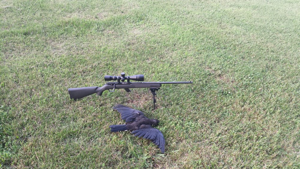

I use it to pop squirrels with federal gold metal 40gr at 100 yards and have killed crows at 180 with it.

That is good shooting to kill squirrels and crows at that range :)
