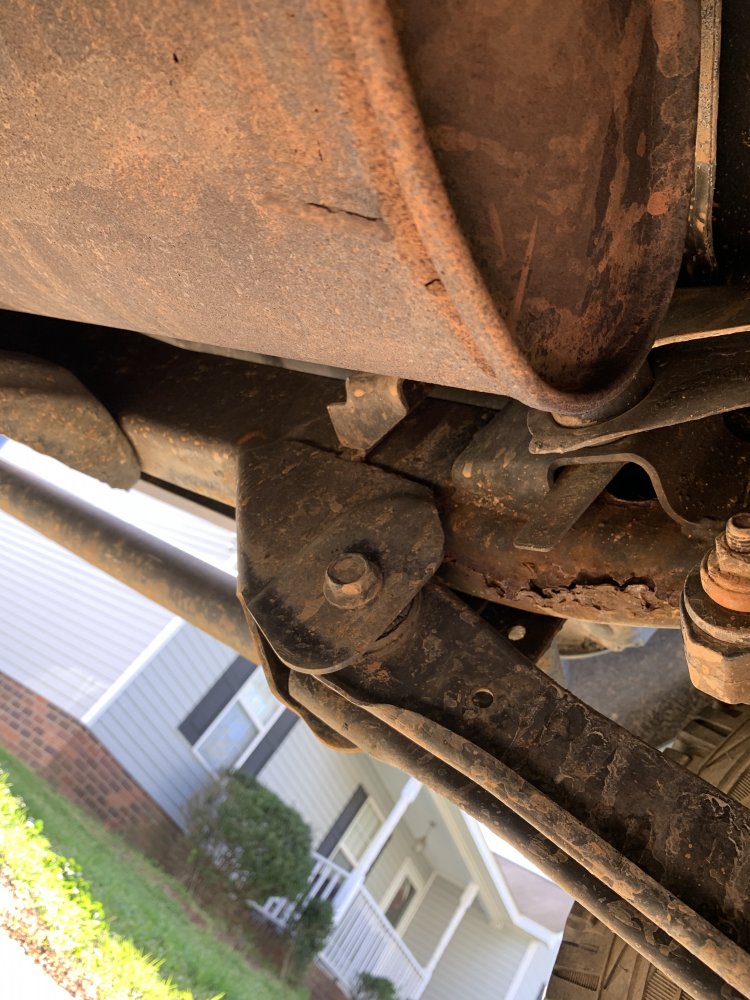

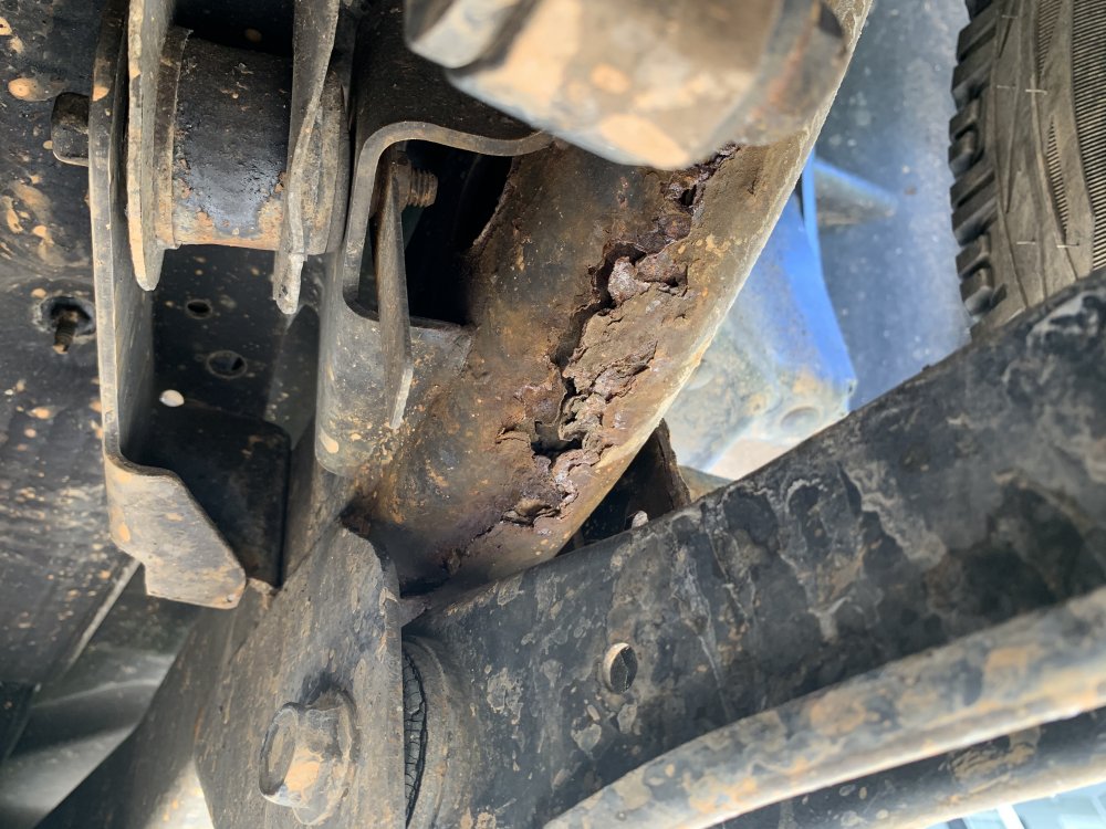

Was crawling around under my gf TJ doing some exhaust work and noticed this rust on the back half of the frame rail, should this be a major structural concern? Or does it look like just surface?

agreed when you see metal flaking off that aint surface...
Yeah I was afraid of it, just didn’t wanna believe it...she’s on a scuba trip to Florida right now so I’m gonna wait to break the “bad” news to her when she gets back. At least the 5 minutes of searching I’ve done, doesn’t seem the repair kits are too expensive

The labor time is extensive and is a big pain.
Without at least a two post lift forget it, axles and suspension. All need to come out.
If one corner is that way, then every corner is probably that way. I would bet money the frame above trans skid plate is rotten too.
I have fixed two of them, and never again.

Whew with each reply i dread it more and more. Guess I’ll crawl under and inspect more thoroughly today after work, it does make sense that there’s more rot but I really hope it’s not the case….would it be a better option at that point to just replace the frame entirely?

I have a TJ in the same situation. Used frames are around $1200. A brand spanking new one is $2600 from 4wp. Then you have to transfer all the stuff to the new frame. $$$$ in labor unless you do it yourself. My plan for a later date unless I decide to part it out.

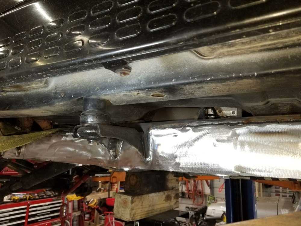

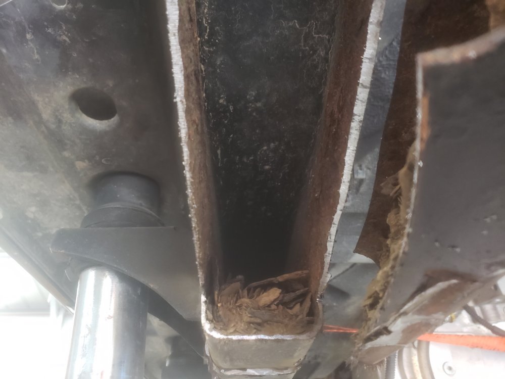

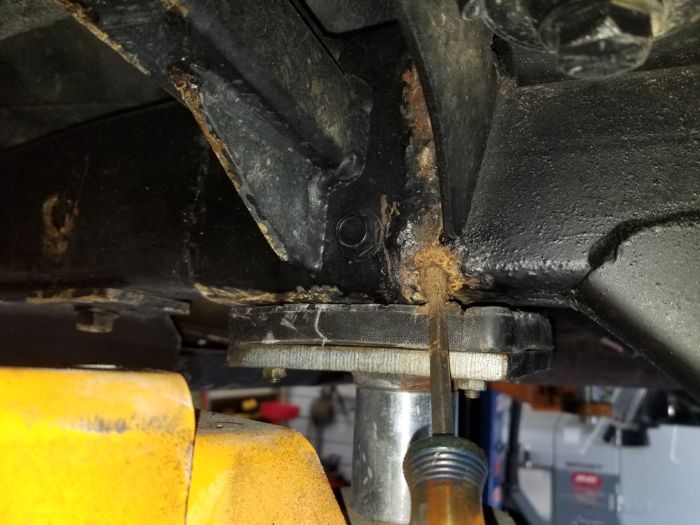

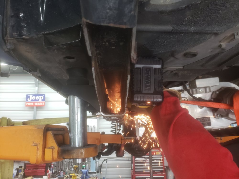

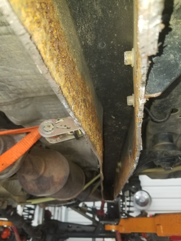

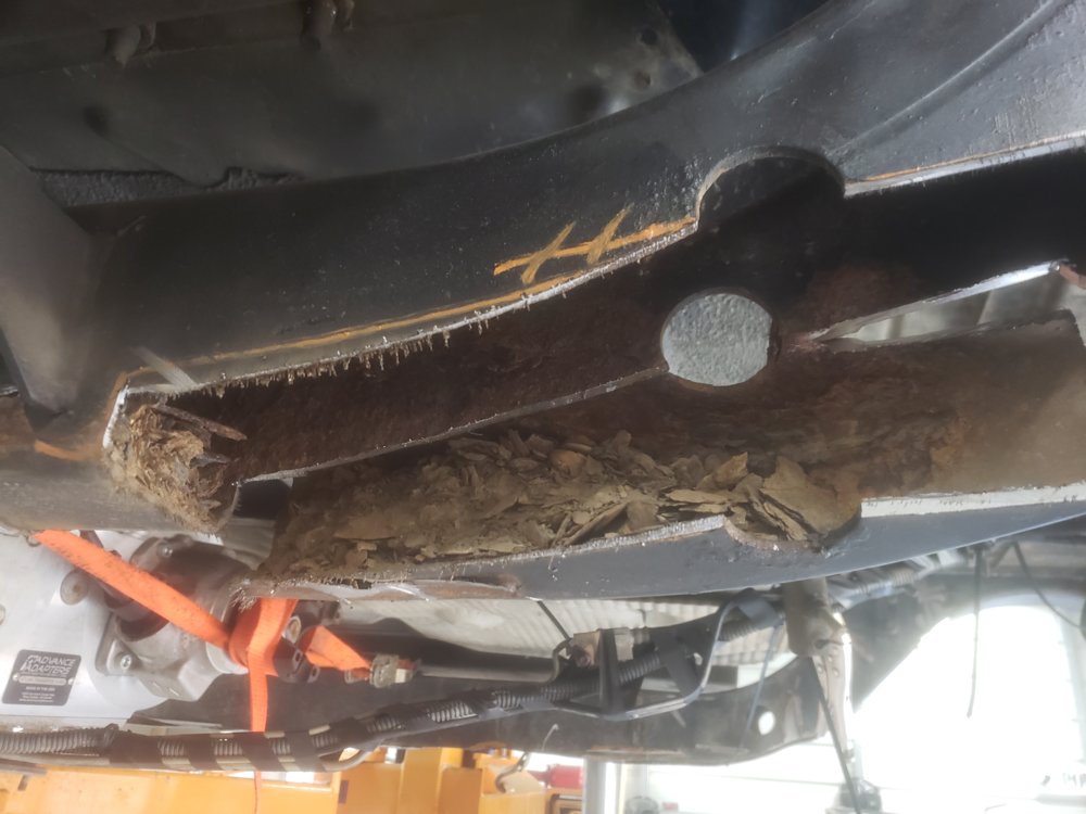

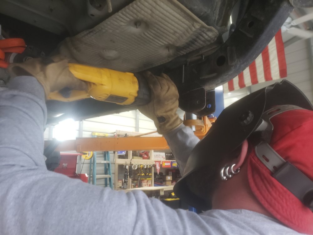

SOME of the wort involved.....to give you an idea of the suck
Mine wasn't NEARLY as obvious as yours.....
But once it was opened
LOOK AT THAT SHIT!!!
Whole bottom 1/3 of the frame had to be cut out
If I went that route I’d plan on doing it myself, good thing is the Jeep isn’t our main transportation it’s more of a “fun” vehicle, that’s becoming less fun with each post. But I’m sure parting it out or parting with it altogether wouldn’t be an option for her, she loves that thing.
