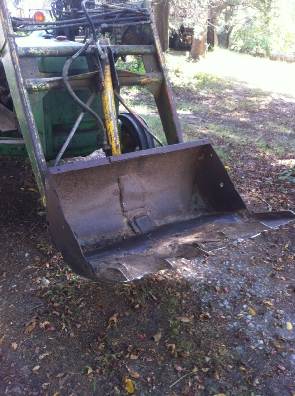

My dad has a John Deere 2040 that he bought many many years ago with some kind of aftermarket front end loader on it. The loader has always worked great, and our favorite thing about it is the deep, narrow bucket. Over the years I have done a lot of patch work to it and it needs more now.

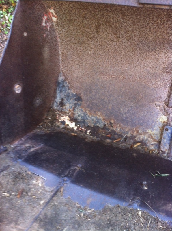

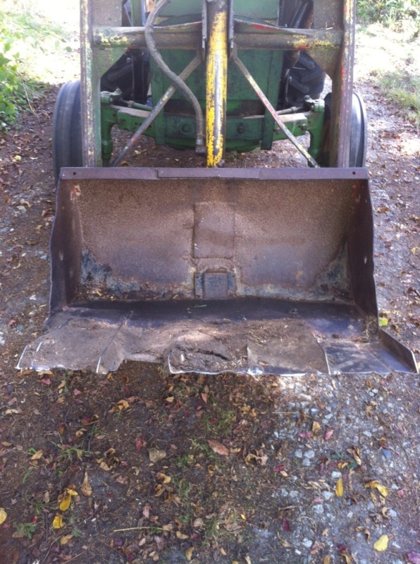

My dad wants me to cut out and replace the back bottom part of the bucket where holes are rusting through. I can do it, but I'm starting to think that with all the repair work that has been done to this bucket that it may be better to just build a new bucket instead of continuing to dump nickel and dimes into this one which is deteriorating.

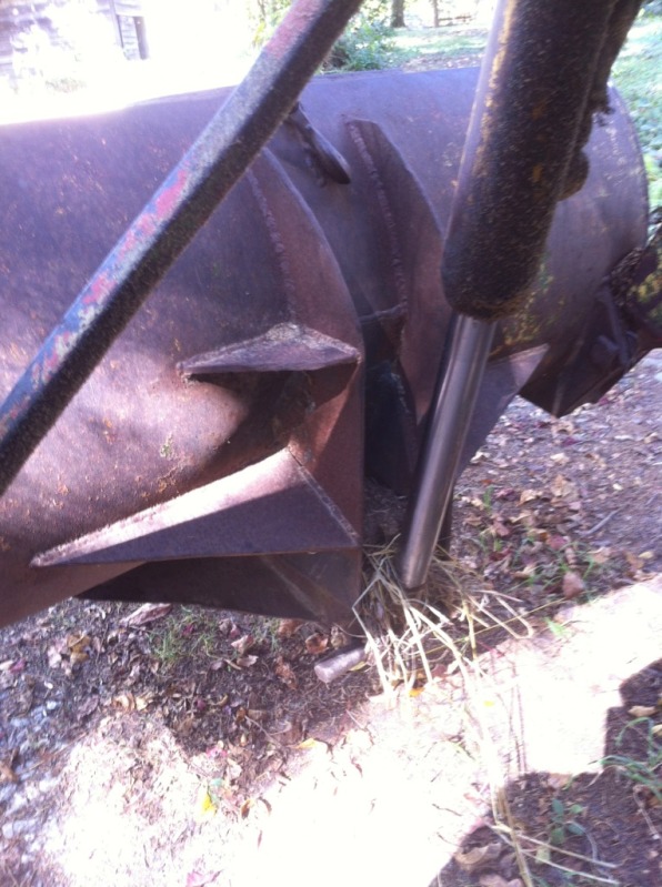

I have a welder but I dont have a great way to cut thick steel. I added several big gussetts to the cylinder mount on the back of the bucket using 1/4" plate and I remember I went through a lot of cutting wheels on my angle grinder doing it.
Also, I can't bend plate except with the torch/hammer method so all of the work to create the curve in the bucket would be done by angling strips of steel plate. and welding it together.
Any input?

You need a cutting edge on that bucket. really that will fix your problem. You don't need to build a new bucket. Just plate in the rusted part. You want this to work for you, not you work for it..
Rent some torches. This is only a few hours work with the right tools.
When you weld the cutting edge on use something like a 7018 rod, or Co2 shielded flux core. you need high nickle content to bond the hardened cutting edge to the mild steel of the bucket.
Realistically you need to use AR500 or similar for the bucket and some hard-facing welding rods.
I'd have a local shop cut and bend the "patch", you cut it out and weld it in. A decent torch can be had for less than $200; search Craigslist.
Maybe add some holes in it as it looks like the rusting is due to water sitting in the bucket rather than wearing out.
Can I not use mild steel angle iron back to back as the cutting teeth/bucket braces?
You can use whatever you want, I have been building heavy equipment for 18+ years. I have built & repaired more crap like this than I can remember.
Mild steel is fine for the patches, for scraping, skimming & attempted digging. You need a flat cutting edge.
Like this, cut to fit & weld on. also weld up the sides of the bucket at least 3/4 way.
