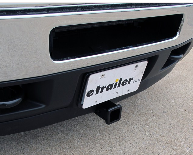

I would like to put a front hitch on my truck.
However, I am not digging the look of the hitch floating below the front facia(lets face it, not a bumper)
I would like for it to be directly behind license plate mount.
I understand that this will put the hitch pin behind the front facia but that's not really much of a problem as long as I can still access it from the back side.

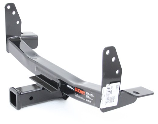

Looking at this curt hitch.
Basically I would like to just buy the side brackets that build my own hitch.
Any helpful suggestions would be great

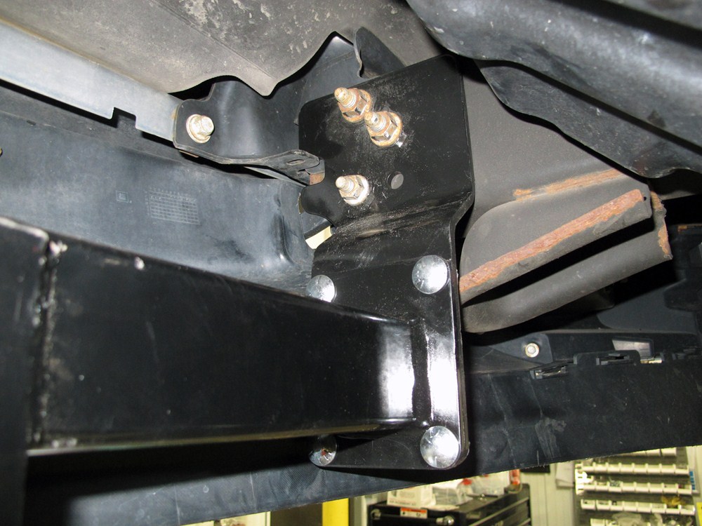

However, I need some advice. As seen in this picture there are three bolt holes in the bracket. Do you have any tips or tricks as to making sure that all of the holes line up properly? What material would you make the template out of? Bracket it self I think is going to 1/4" plate.

If those bolts arent there, take a manilla envelope and a small ball peen hammer. Put the paper up to the frame and tap the rounded end in and around the holes.

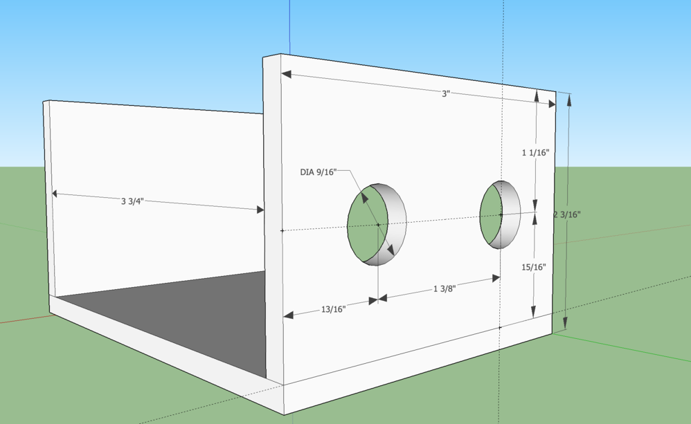

What would it cost me to have two of these made. 3/16. Holes on both sides.
