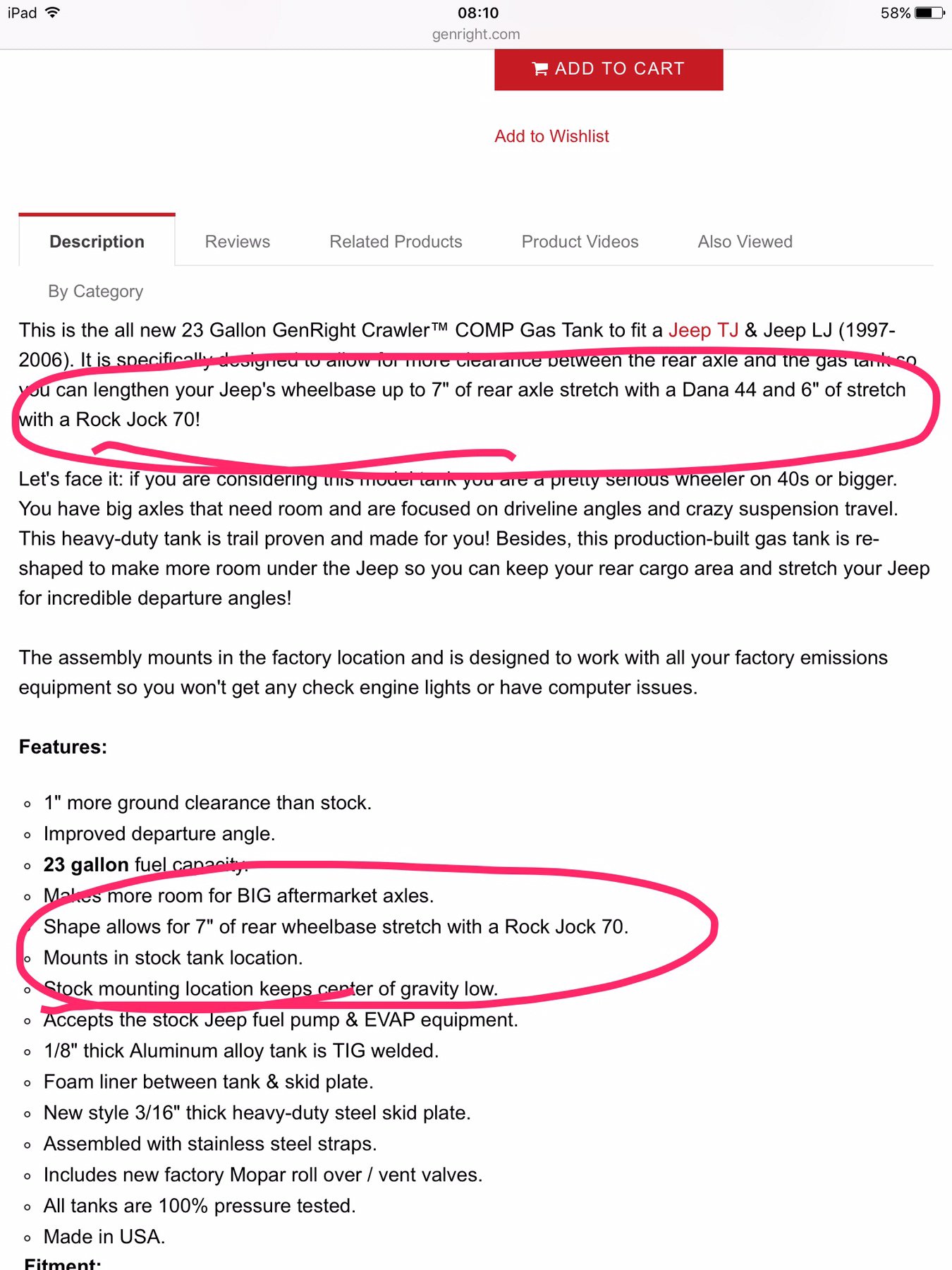

Can't run the Genright tank, my rear axle would hit it with the rear stretch.

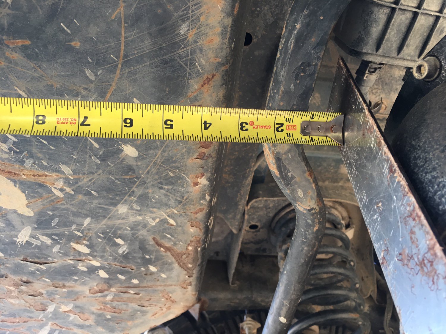

I could easily do a 3-4" stretch with the factory 44 out back, straight rear track bar, and the FACTORY TJ tank in my jeep. For an example the factory track bar with that big ass bend around the diff has a solid 2" of clearance between it and the tank, with my raised rear trac bar mount I could run a straight track bar and clear by much more.

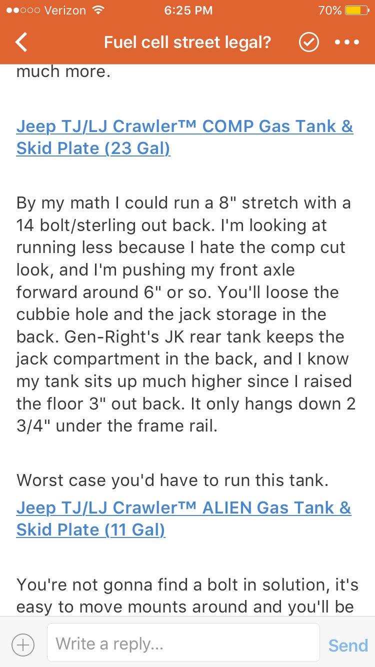

By my math I could run a 8" stretch with a 14 bolt/sterling out back. I'm looking at running less because I hate the comp cut look, and I'm pushing my front axle forward around 6" or so. You'll loose the cubbie hole and the jack storage in the back. Gen-Right's JK rear tank keeps the jack compartment in the back, and I know my tank sits up much higher since I raised the floor 3" out back. It only hangs down 2 3/4" under the frame rail.
Worst case you'd have to run this tank.

You're not gonna find a bolt in solution, it's easy to move mounts around and you'll be redoing a lot of the cross members under the jeep to fit the 4 link. I'm more than likely going to have to notch the tub some to fit the upper frame side mount because its going to be 3" above the frame rail. Only going with 38" uppers out back and 39" lowers.

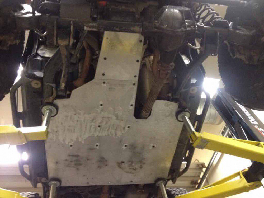

I've talked to 2 different companies that do TJ tank swaps in JKs and both said that you can't do an 8" stretch with a TJ tank. And don't really care about the jack compartment since it's too short to work on my Jeep now lol. And I already planned on taking the rear cubby hole out since I don't hardly ever use it either. And my buddy has the Motobilt cell in his TJ and I never smell any gas in it. Idk maybe he has it set up really good? Lol

Did you not read any of this? Not trying to be a dick but it does say between 6-7" stretch in a TJ with a 1 ton rear. I've already told you ditching the jack compartment you can move the tank back further. I'll post a picture of the 3 1/2" of clearance between the front of my factory TJ tank and the diff cover so you can understand a little better.
Now tell me again how that first tank I sent you won't work? If it allows more stretch? Because by those numbers I could push the rear axle back 10" if I wanted with the factory 44 out back.

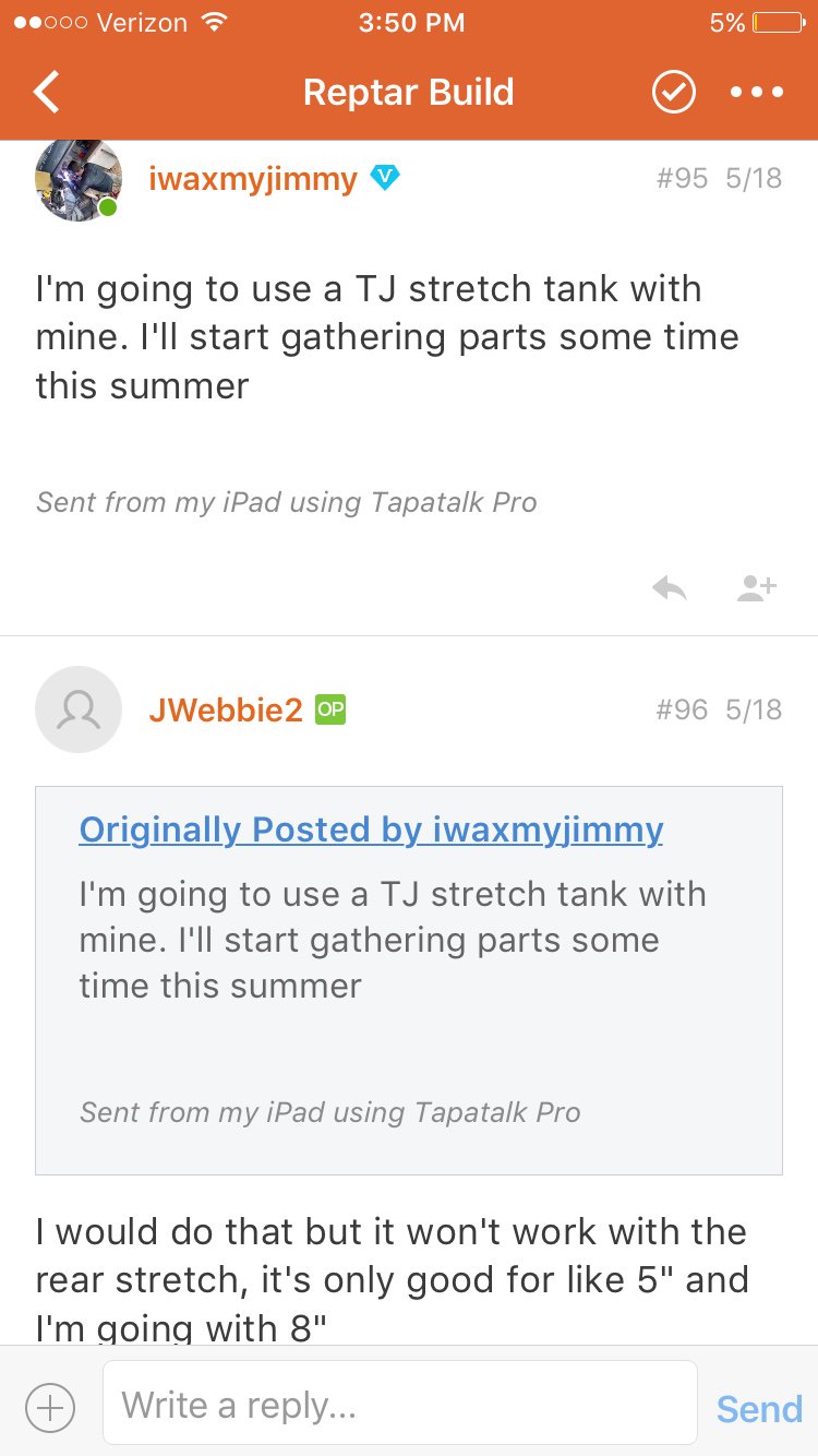

But I find it pretty weird that 2 different shops told me that a stock TJ tank won't work with a stretch but yet you're going to do it lol
And never did I ever say that either.... that's from your thread back in may.
Hell I must have read that wrong and thought you were talking about your current TJ tank.
