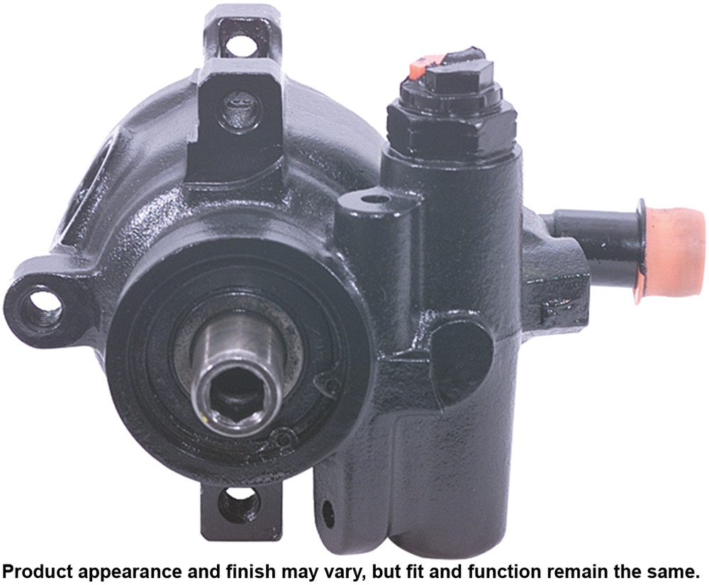

I picked up one of these yesterday. It's from an 85 S-10 with a 2.5. The 5/8 feed line that came with my PSC reservoir fits perfect on the inlet of the pump.

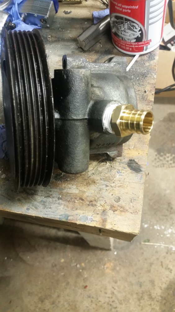

Drilled and tapped the stock xj pump for 1/2npt
I tapped it slowly with lots of lube.
