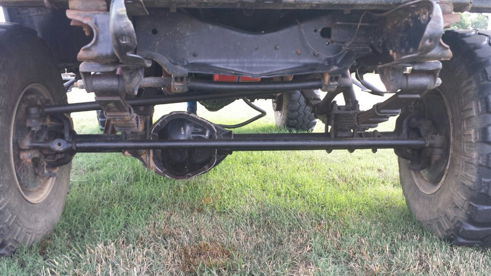

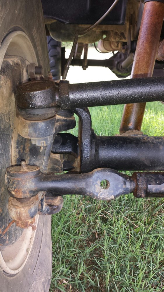

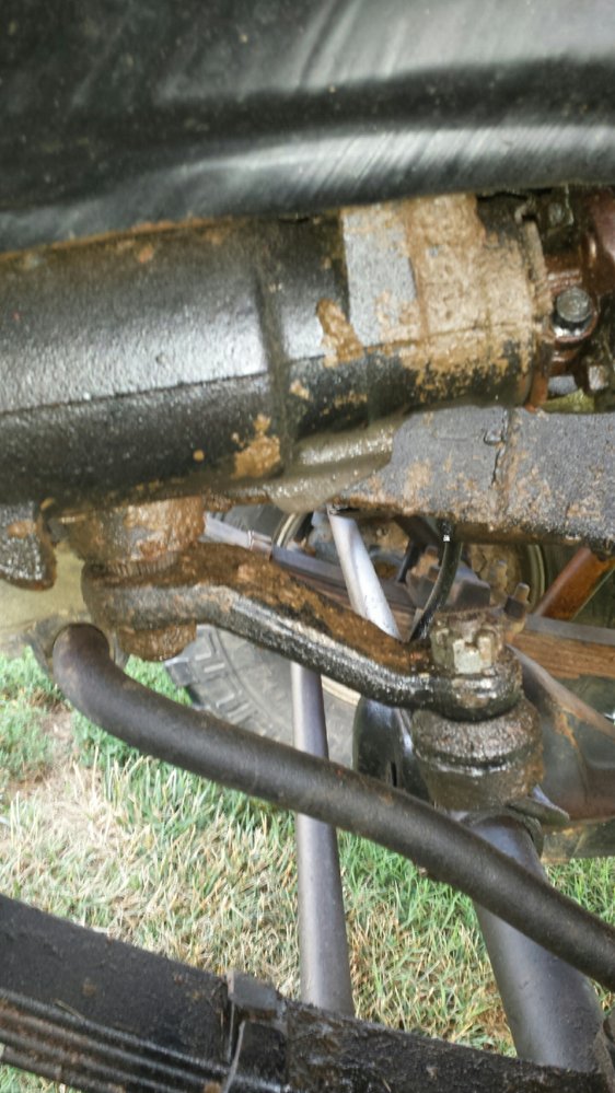

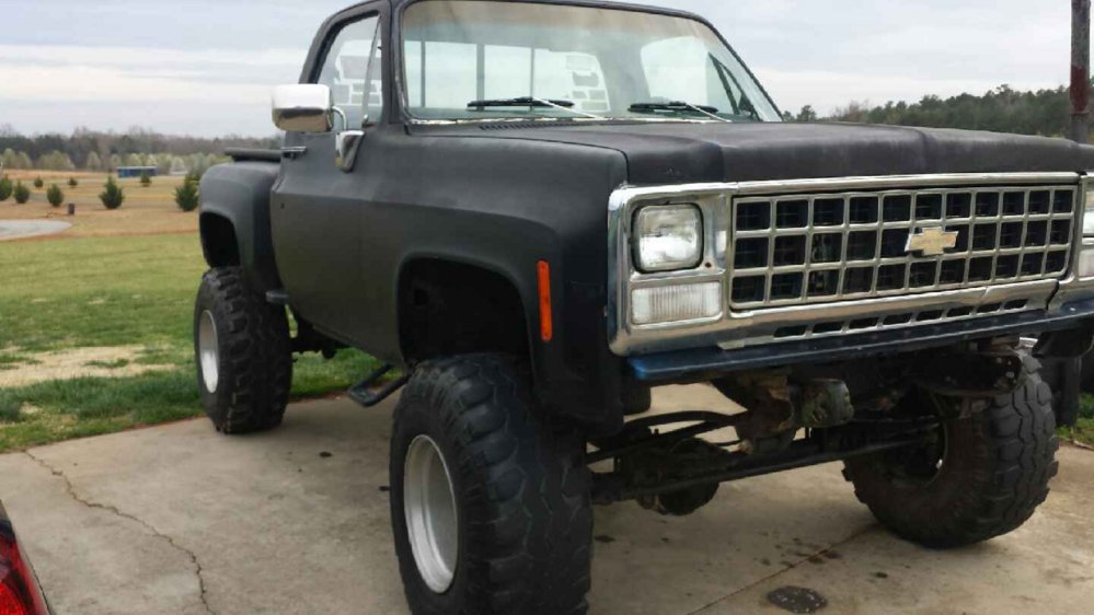

Alright gents. Im back. I need some help figuring out this steering system. Is the geometry of the drag link to the tie rod correct? Im looking at it thinking it has the possibility to be Y link tie rod? Idk. That's why I need your help. Images aren't in order but theyre all there. Help me out guys. What system is this. I mean its setup like crossover correct?
Mind you guys I didn't build this truck. And ive owned jeeps/Toyotas before but im just going by what im seeing and reading on google. Im unsure of what the factory parts looked like. If it had factory push/pull steering or side/side steering like now.
That's cross over which is so much better than the factory style setup
Flatter the better, less bumpsteer. Does it clear the engine crossmember pretty good?
Yeah you can get an idea from the picture with the pitman arm. How canbi flattenbit out? I saw that ORD has a larger spacer or something. But it seems there would be a better way?
Honestly you should be good to go as it is. But a slight dropped pitman arm would help you out. Have you made sure the frame isn't cracked behind the steering box?
With your current setup, I don't feel you can get it any flatter, otherwise it'd be close to hitting the passenger side leaf spring. If you did want it flatter, you'd have to source a further dropped pitman arm (on the steering box) and a raised steering arm (on the steering knuckle). By the way, keep an eye on that fab job steering box brace. It appears the previous owner found the big weakness of these trucks and did some rigging and repair.
