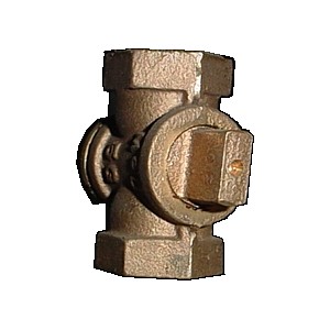

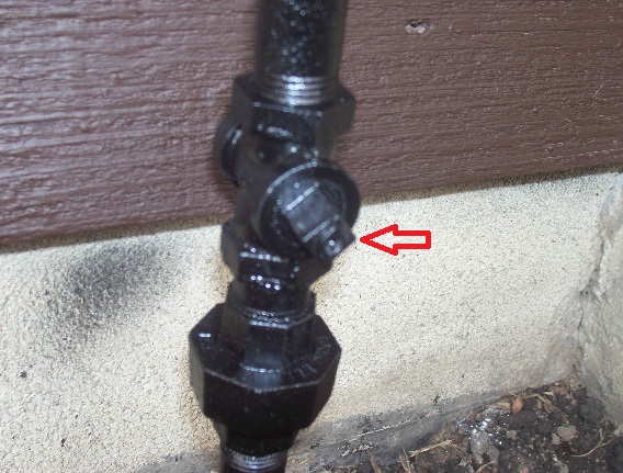

I think my main concern is the gas line that runs to the furnace. It has a bolt going through the line with a nut on the other side. so there is no real way for me to tell how "open" the valve inside is. How loose should this be for it be considered open enough.
Stop! Tighten that bolt back up. There should be a square on top of that bolt. That square should have a line on top of the square that indicates position. When that line is in line with the pipe it's open.
should look like one of these by your description
