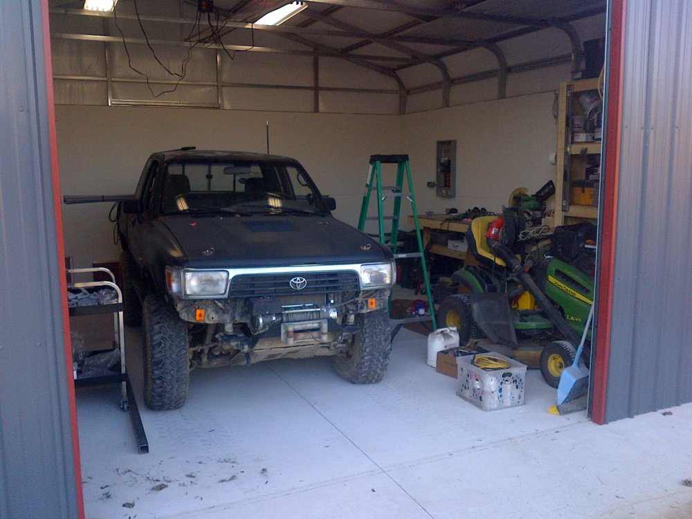

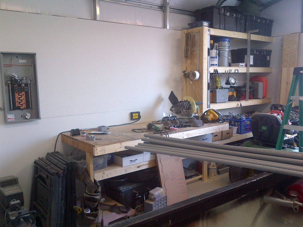

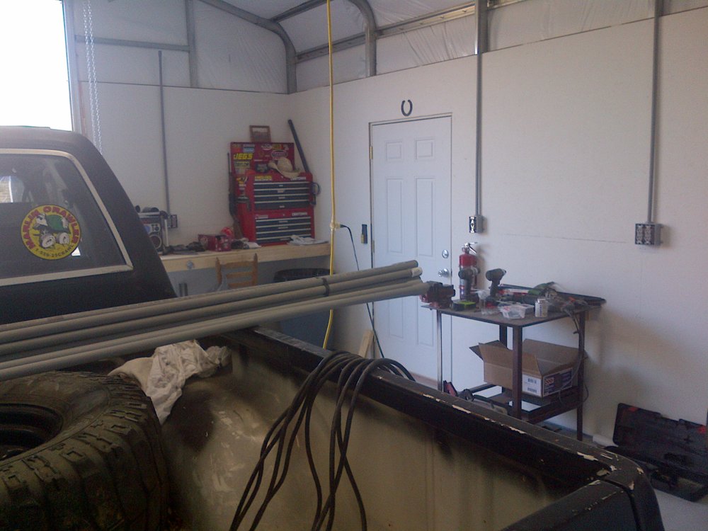

My shop is SMALL. 20x24. Just big enough for my rig. That was as big as I could build where I wanted it (drainfield, easement). 10' ceilings MINIMUM. My roll up door is not a typical garage door type, it rolls into itself so it doesn't kill the lighting. 10' wide roll door minimum. I also have a separate power service to my shop. 200A panel minimum IMO. I can weld while the air compressor is running (or be able to use a plasma). Draw everything out on graph paper a bunch of times. Small spaces require strategic placement of workbenches and shelving. I hate having to bring 20' sticks of steel in my shop to cut, this usually requires moving my rig out.
Old pics, there is more crap in there now. These are from when I was finishing the electrical.
