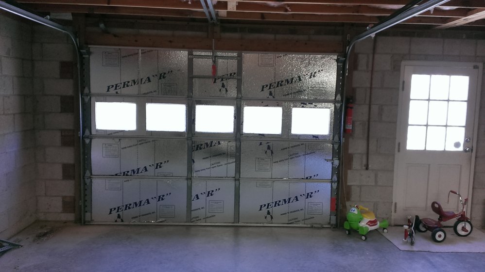

Well, I finally got around to finishing the garage doors. I ended up buying some 1" foam from Lowes with the foil face. It turned out really nice and I am happy with it. I have noticed around a 5 degree swing down there while I am running my wood stove. It cut down on some outside noise also.
Only thing I'm not seeing that's any different from a brand new insulated G-D is the seal around the edges. And you can buy that separately and install yourself too if you wanted.
Looks like a win to me!
