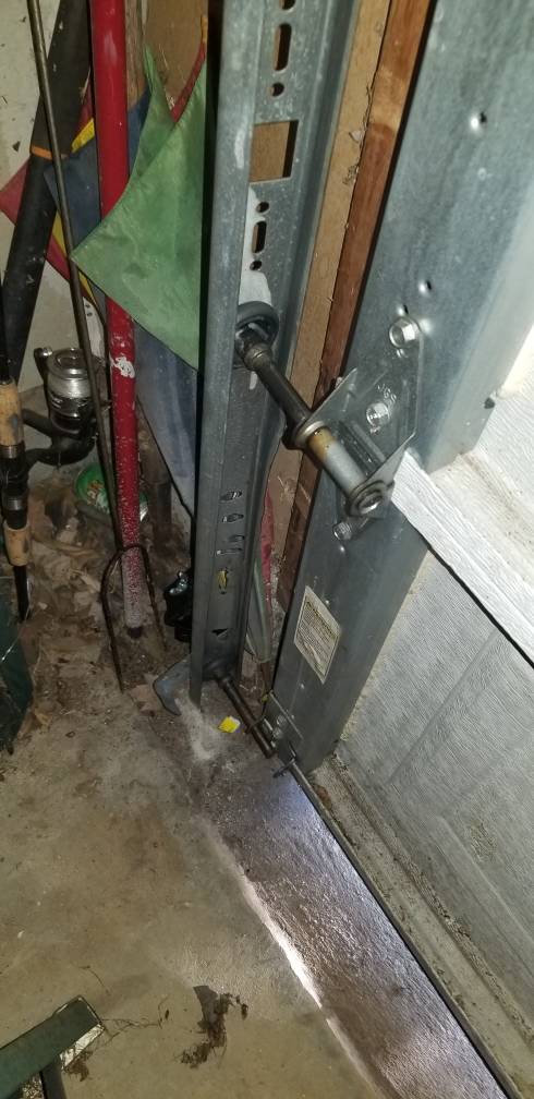

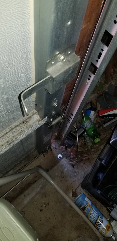

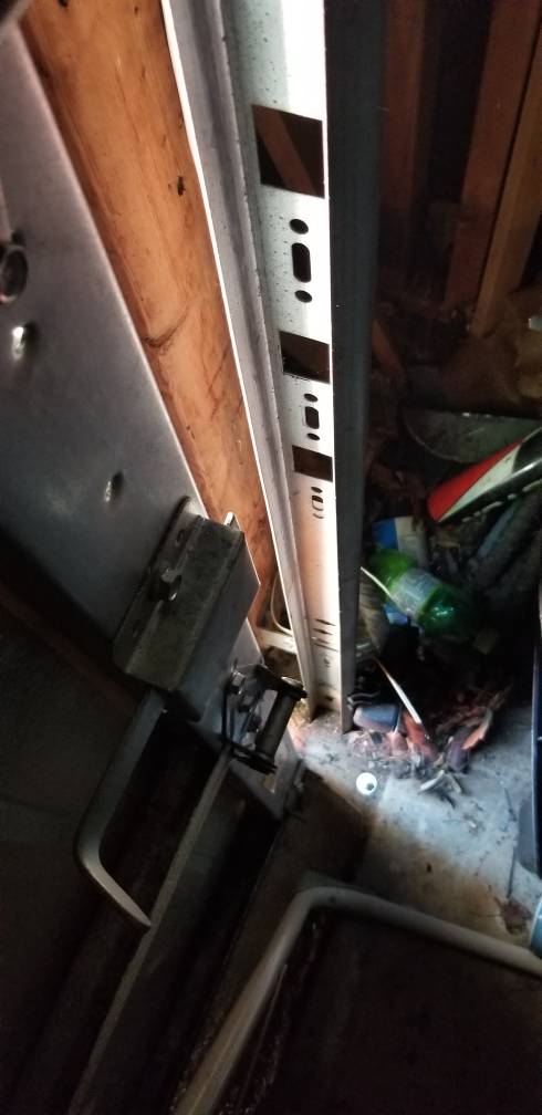

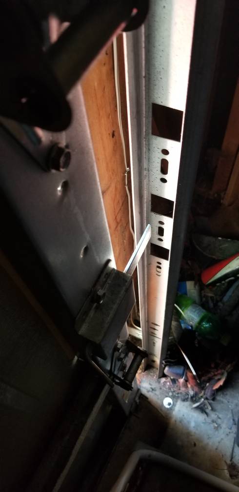

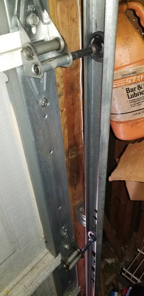

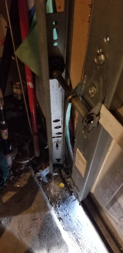

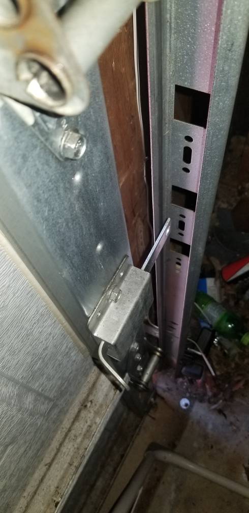

A couple months ago the motor went out so i replaced it with another with the same specs. Now the torquemaster torsion rod springs broke. I ordered a kit from the manufacturer that replaced both springs, cable drums and tension gears to the torquemaster pro/plus. I followed the instructions to the letter. And double checked my cable length and made sure to keep track of number of rotation on the springs. Did this by drawing a line on the socket and counting how many times it went by.
So i manually lifted the door 3 inches to make sure it was going to lift evenly and to double check everything. So when I plug the motor in and reconnected the trolly. Then when i hit the botton to open it seemed to have pushed the track out about 4 inches and bent it and some how this side ended up being 8 inches higher.
Right now I got the door to closed and the tension released on the torsion rod.

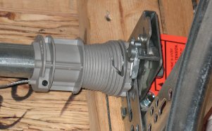

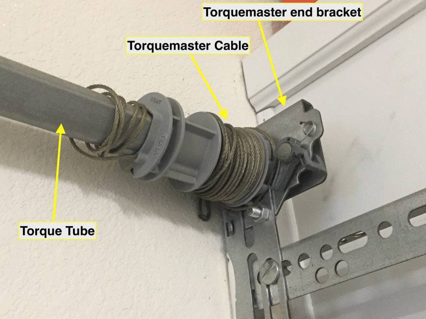

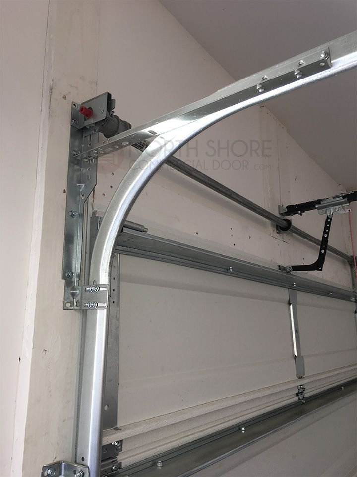

Pics are of the style of torsion rod will get pics of the real door once I go back down stairs
My carnage

That's why the only reason I decided to attempt it myself because on the torquemasters the springs are contained inside of a tube and you just use a ratchet and 5/8 socket to adjust the tension.

It is finally fixed after talking to multiple companies trying to find one that serviced the wayne dolton torquemasters. Dependable dock and door was the first one i found. They sent a guy out and got it fixed. Turned out the bracket the end of the cable connects to had shifted and bent up. It was almost cut all the way through by the old cable after 19 years of use.
Other companies were waiting four hundred dollars alone in parts to switch my system over to the standard external springs.
