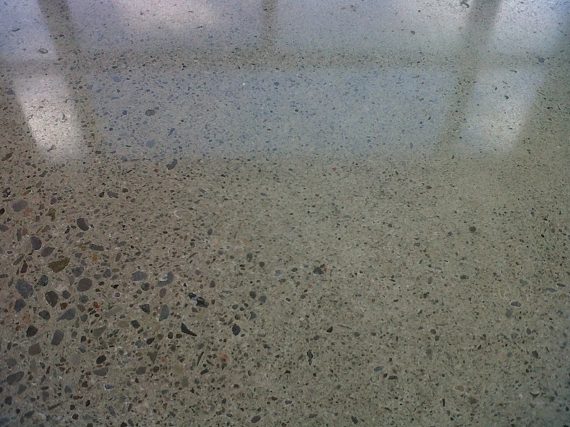

It's really not that much more expensive. and when your done you just use a sealer on it to keep oil and grease from soaking in. I believe you can rent the machine to do it from Sunbelt or others and a 2 car size garage shouldn't take more than a day. When finished though your left with nothing but shiny concrete, not much other than acid is gonna mess up the shine. No tire peel, or weld berries burning through.
View attachment 80125View attachment 80126
A little Anitfreeze or the recent oil spill and I'd either be able to break dance like a mutha' or most likely break my tailbone from bustin my arse!
LOL... this is true but unless there's sand in the epoxy its slippery as shiz too...
