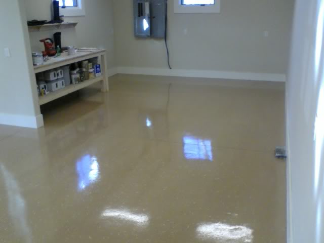

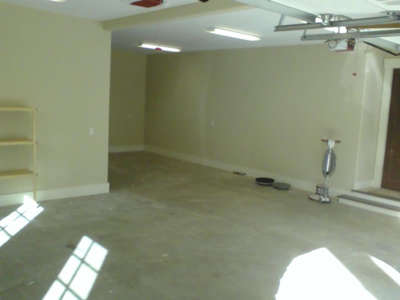

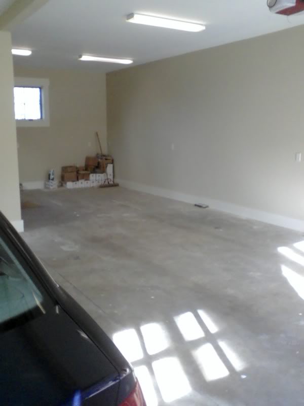

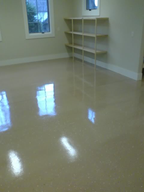

I just got done with a garage for a customer.
We used an epoxy system. Thats all I know is epoxy. It works. It cleans easy, and can be had in many levels of finish and budgets.
REGAURDLESS of what has been on the concrete, even if it has not been sealed, we etch it. This particular floor had been sealed and had some "heavy deposits" on it. We rented a floor sander with an expanded steel mesh insert that has diamond teerh on it. We used that. Clean with water. Dry. Etch. Dry. Primer Coat. Dry. Base Color Coat and Chips. Dry. Gloss Top Coat. Dry.
The home was around 3800ft and being winter...drying times extended. We waited 5 days after top coat before driving a car on it. Able to walk on Top Coat after being put down in 12hours.
Pics...
