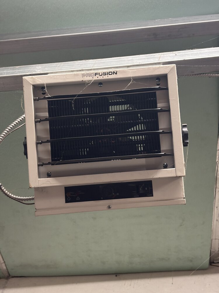

I have this 7500 watt from Northern tools. It is definitely enough heat for your space, but my power bill goes up by a hundred or more doll hairs when I use. I have a propane gas pack now and a wood stove that I use mostly.
