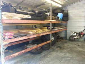

I made mine out of 3/4" treated plywood (because I had some extra laying around), and the brackets are 3ft apart so I could use 3 for every 8ft piece (at 1ft, 4ft, and 7ft). I can put really heavy stuff up there (50-80lbs), but it sags. I wish I had put the brackets every 2ft.
This is second building for storage

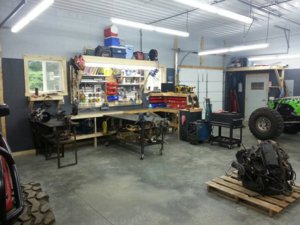

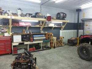

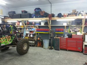

Another tip that I made sure to apply in my new garage is- anything that is not attached to the walls is on casters. That way if some thing is not being used for a period of time it gets rolled out of the way or put in the storage shop.
