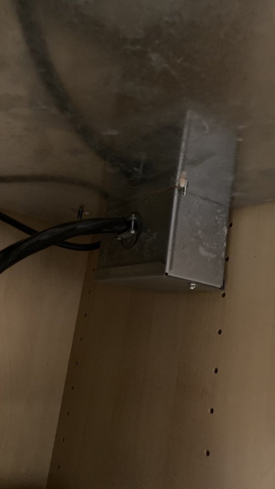

Is there an outlet or is the stove top wired into the junction box directly. Do you need 110 for the new gas top to light the burners? If it is direct wired then kill the breaker and remove the old top and tie all three legs of the 220 together. If you need 110 for the new top then you are going to have to convert it to 110 or pull a new line.
Dang I wouldn't have thought it would be directly wired to the box, that seems odd to me. Yes we need 110 for igniters, I'm sure my wife can get by with a lighter for a while though :laughing:

If you look at the installation instructions for most electric cook tops they are wired in directly. Entire ranges have a plug but built in units are wired.
Junction box
