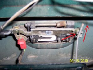

And now mine doesn't work again. I can feel it locking and unlocking with the key, but the handle is moving freely, like it's not attached to anything. I'm assuming the rod has come out of the retaining/adjustment clip, like I pictured below? How do I get the hatch to open in this situation?
