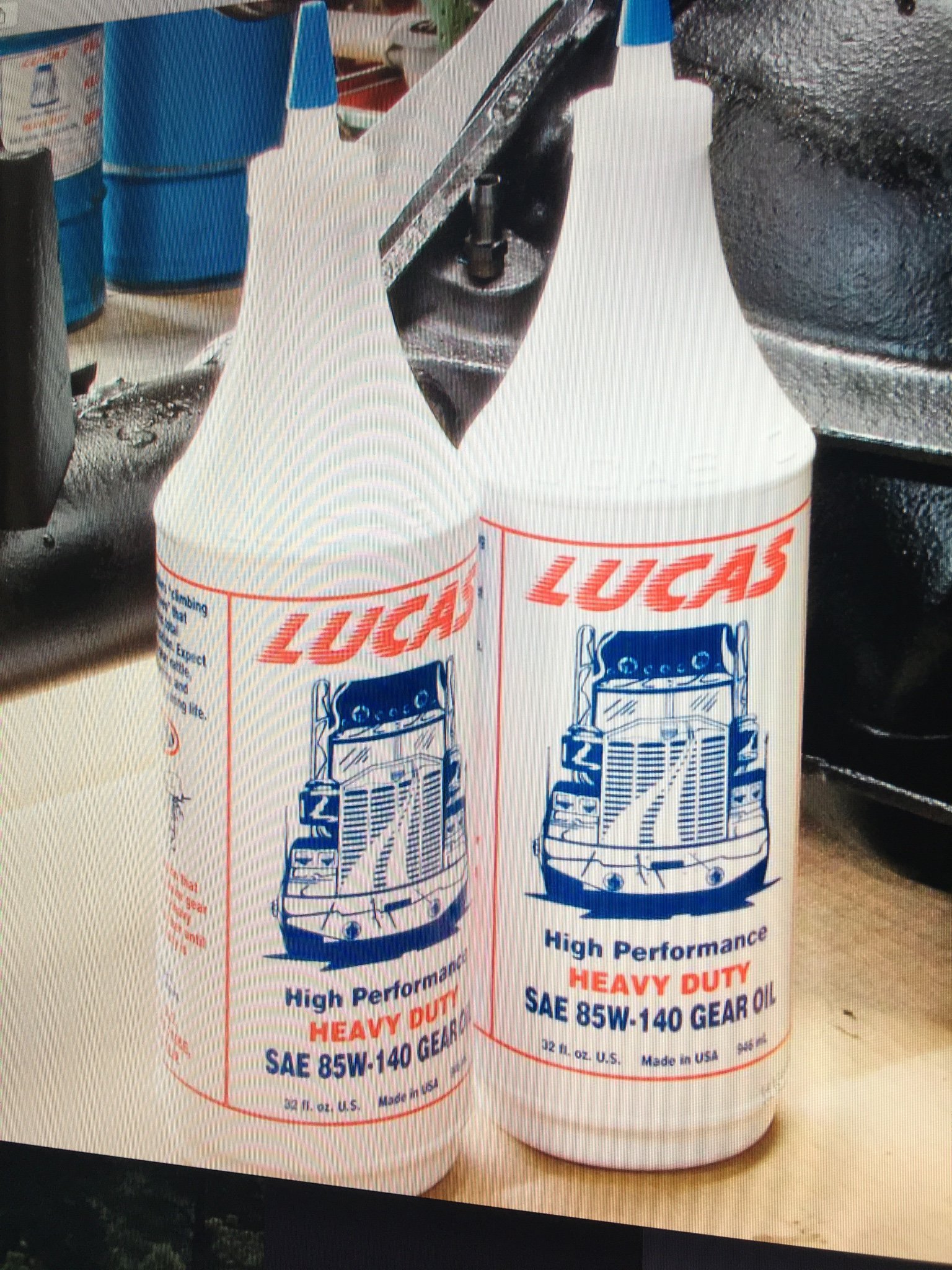

We get asked about gear oil at least 10 times a day. Then we get asked why, which is long winded. Figured we would post here for anyone wondering. This breaks it down how, what, when, where, why....
ECGS Gear Oil Recommendation - Why We Recommend Non-Synthetic Oil
ECGS recommends Dyno (Non-Synthetic) 85w140 Lucas oil with a Ford or Dana limited slip additive for clutch style posi's. The gear oil question is an age old debate that comes down to opinion. We base our opinion on differentials we have seen. Scientifically it has been proven that that when measuring diff temps, the actual “metal objects” stay cooler using a quality dyno oil with an additive package over synthetic oils. However it has been proven that synthetic “oils” can stay cooler then dyno oil. So it depends on what temperature you measure the “metal” or the “oil” hence why both can claim they are better.

Conclusion Notes:
· ECGS RECOMENDS LUCAS DYNO 85W140 & LUCAS 80W90 FOR EXTREME COLD
