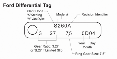

there should be a tag with some #s on it & it will tell you
if you find it post up the #s & we can help
should look something like this
