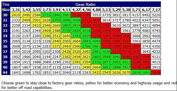

No expert here but this is how I would be thinking about it. What's your current tire size and your opinion on how it drives on the highway now? That that reference point and the chart below and there's your answer.
This chart is a 1:1 final ratio chart. With the JK, it is .83:1 with the 5 speed auto. It seems the sweet spot is 2330 rpm @ 70mph a couple charts I looked at put the 4:56 @ 2474 and the 4.88 put is @ 2647.
