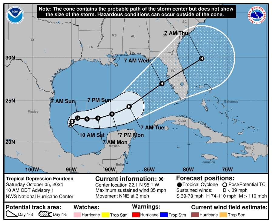

Looks like you've got until Wednesday to get something worked out!
