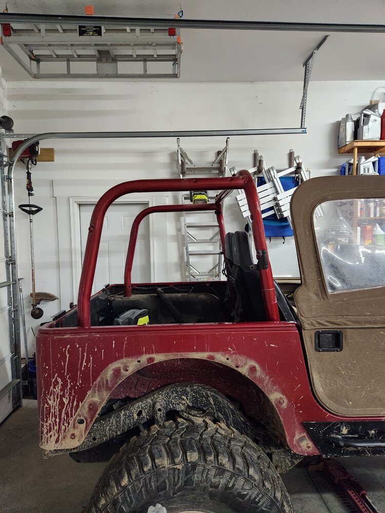

No idea if this will fit or help or anything but I've got this factory cage out of my Jeep TJ you can have if you come get it.

I used the stock tj roll bar I got from @ncsutj

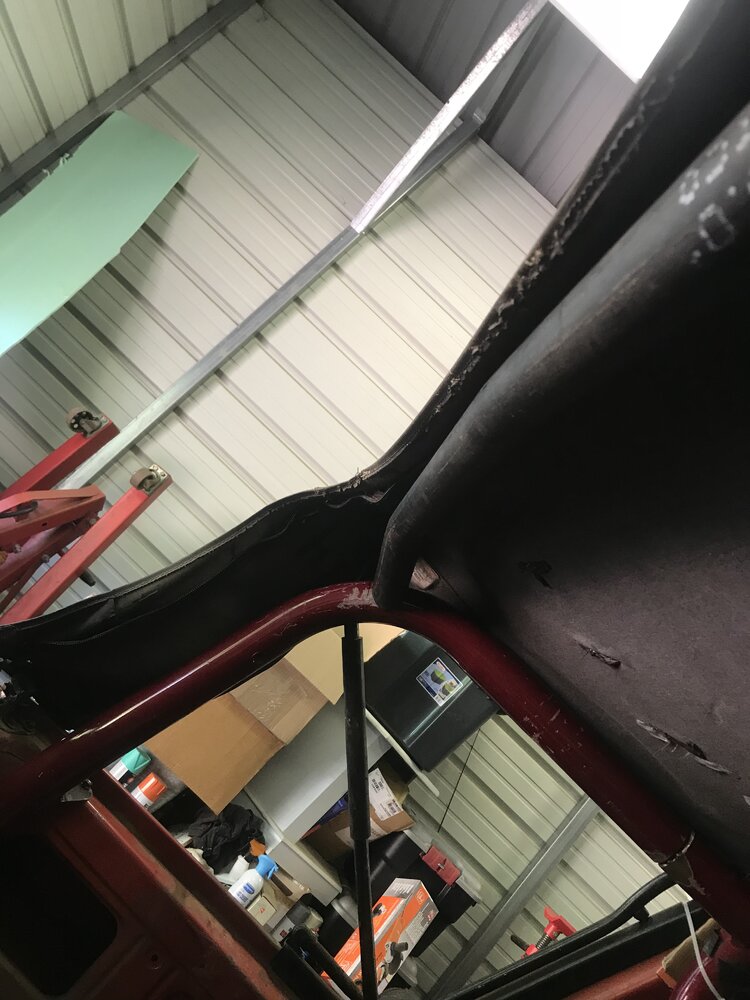

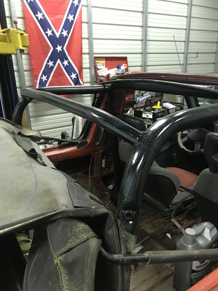

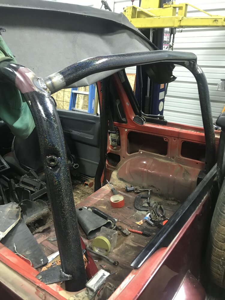

And it worked out great. We started with removing the factory 3 point seat belt mounts.
I removed 2 1/2 inches from the length of the tube going from the b pillar to the c pillar. Then cut down the mounting plates until they fit where I wanted. I had to trim down the center where the roll bar is bolted together from the factory until everything was the right angle and width for the geo.
I had a piece of 1 1/4 schedule 80 pipe laying around so I bent that to be a spreader for the rear. It tucks in the soft top above the back window.
