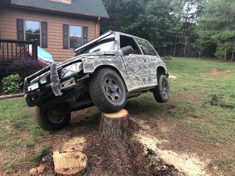

It really depends on what you want... if i were to start over, I would take the body off and tube out from the frame up.... I gutted the body as much as I could, and still leave it. The 1.6 8v with stock gears was anemic, but bearable on 30" tires. 34" tires it was a slug. I have a 2nd gen donor with a 2.0l and it has way more power than the 8v.
Also depends on your hopes for it... just to beat around the woods/dirt roads, itll do fine, stockish.... if you want to get in the rocks, SAS it. If you want to jump stuff, it has way to little power and too much front weight.

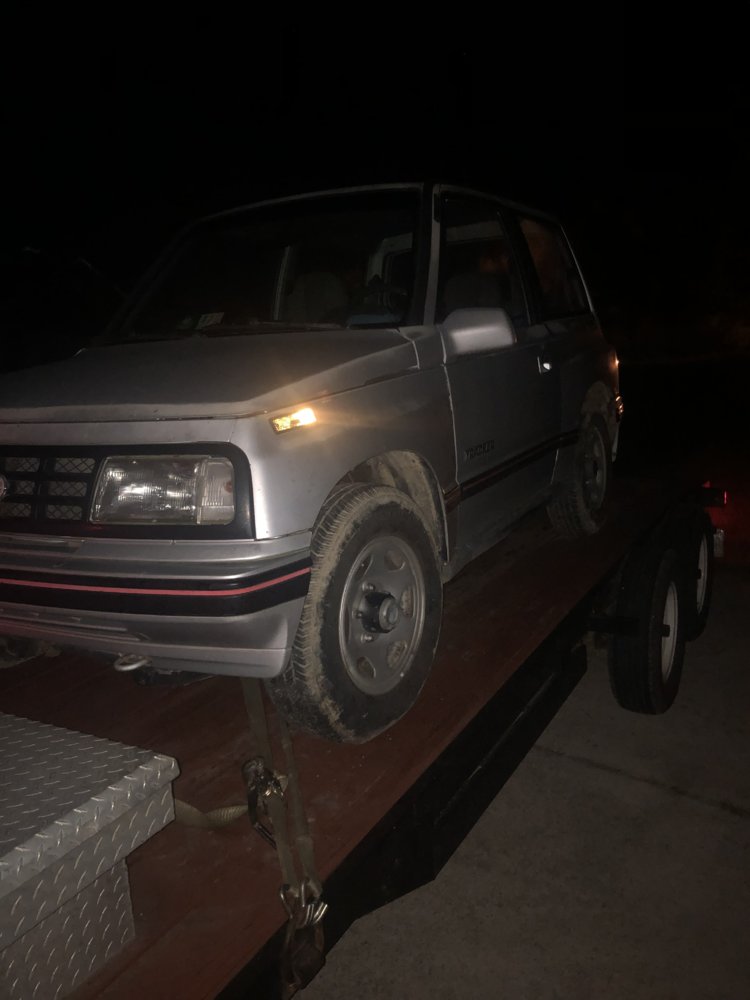

Picked it up last night. It has a lot of rust but for what I’ll use it for it will be fine. It’s a 90 model so she was way off.
