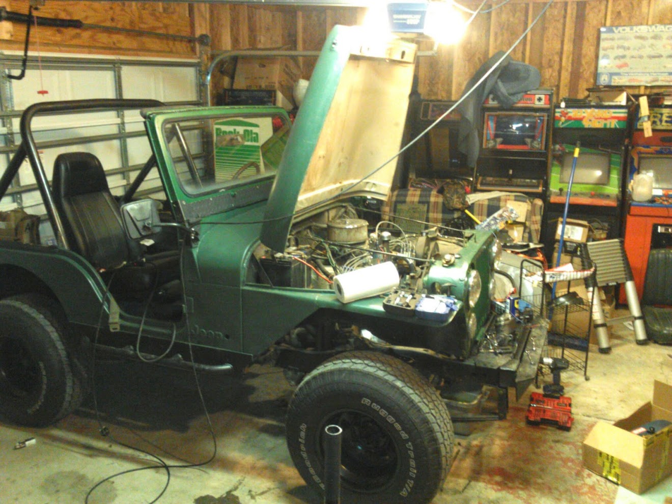

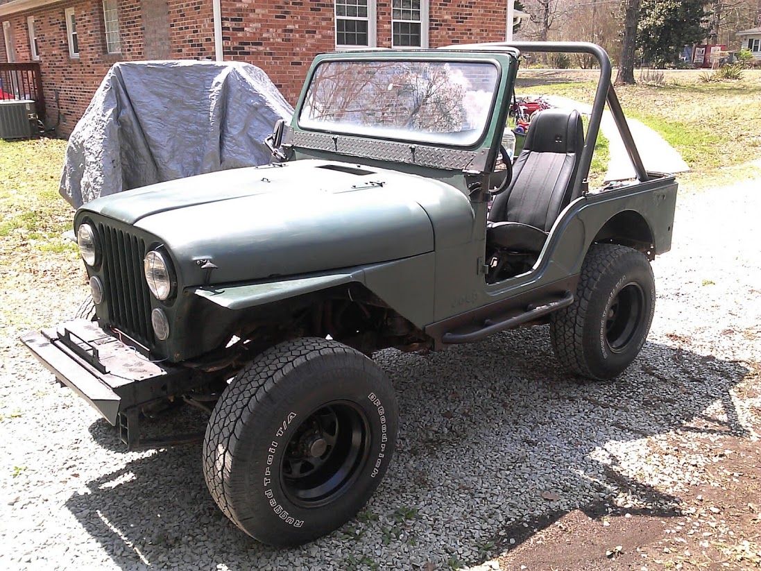

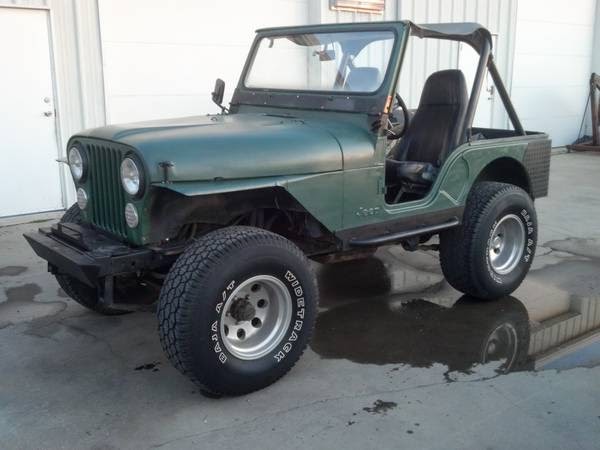

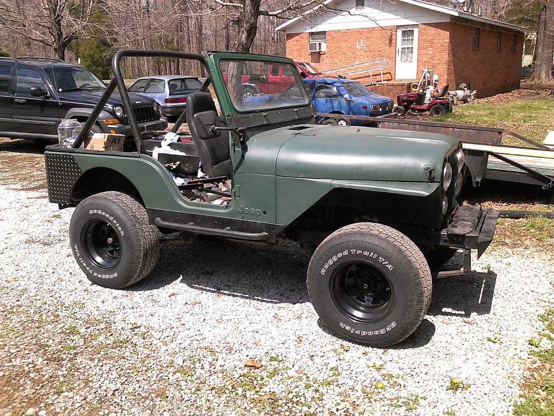

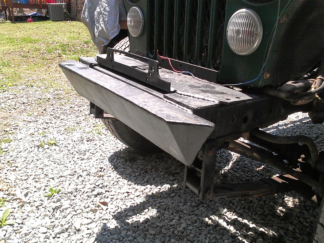

Here is the goal. Get my 78 CJ5 ready to go on Uwharrie by May 24th, two months from today. This will be full of long nights and several pounds of coffee I imagine. First pictures of the CJ5:
alh6.googleusercontent.com__uoU_34Q2GP4_UyjlrN_fz0I_AAAAAAAAKQI_NbyS1xeimhw_w600_h450_no_Jeep_1.jpg

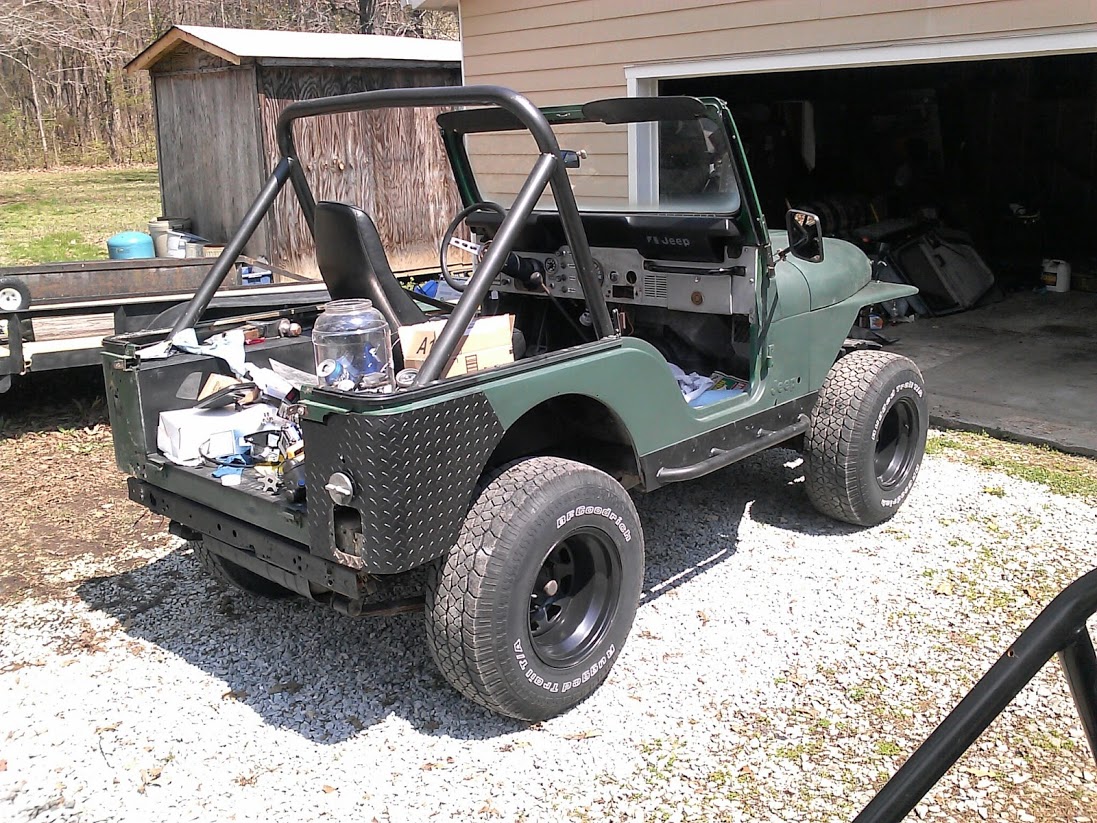

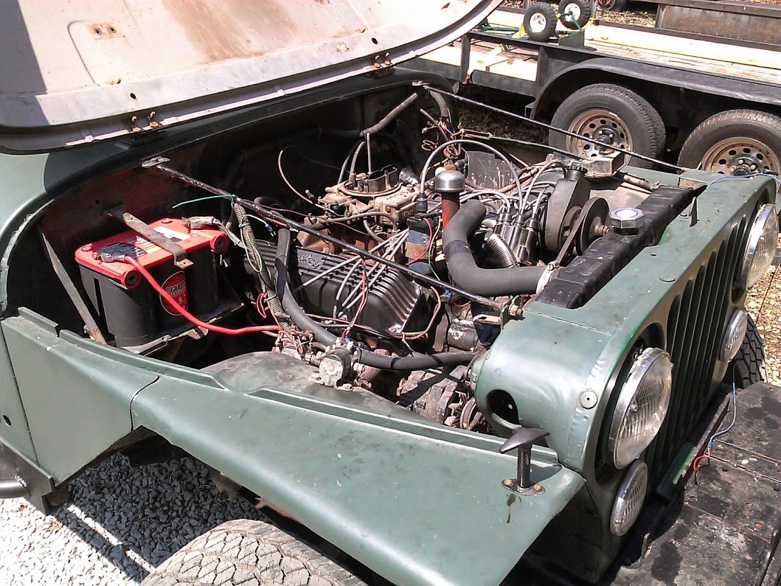

I posted this in another tread but here is me picking the CJ5 up on Saturday:
alh5.googleusercontent.com__AEQO2uugx7A_Uy2eicAXd6I_AAAAAAAAKa9ca94399299a0206d8b098f7e0bfbdf5.jpg
Let me start off by saying the CJ5 starts and the front brakes work but it has some collapsed lifters and the rear brakes don't work, and a slew of the electrical wiring needs to be looked at.

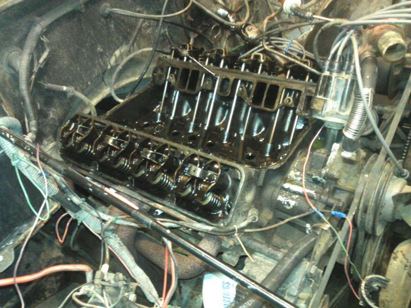

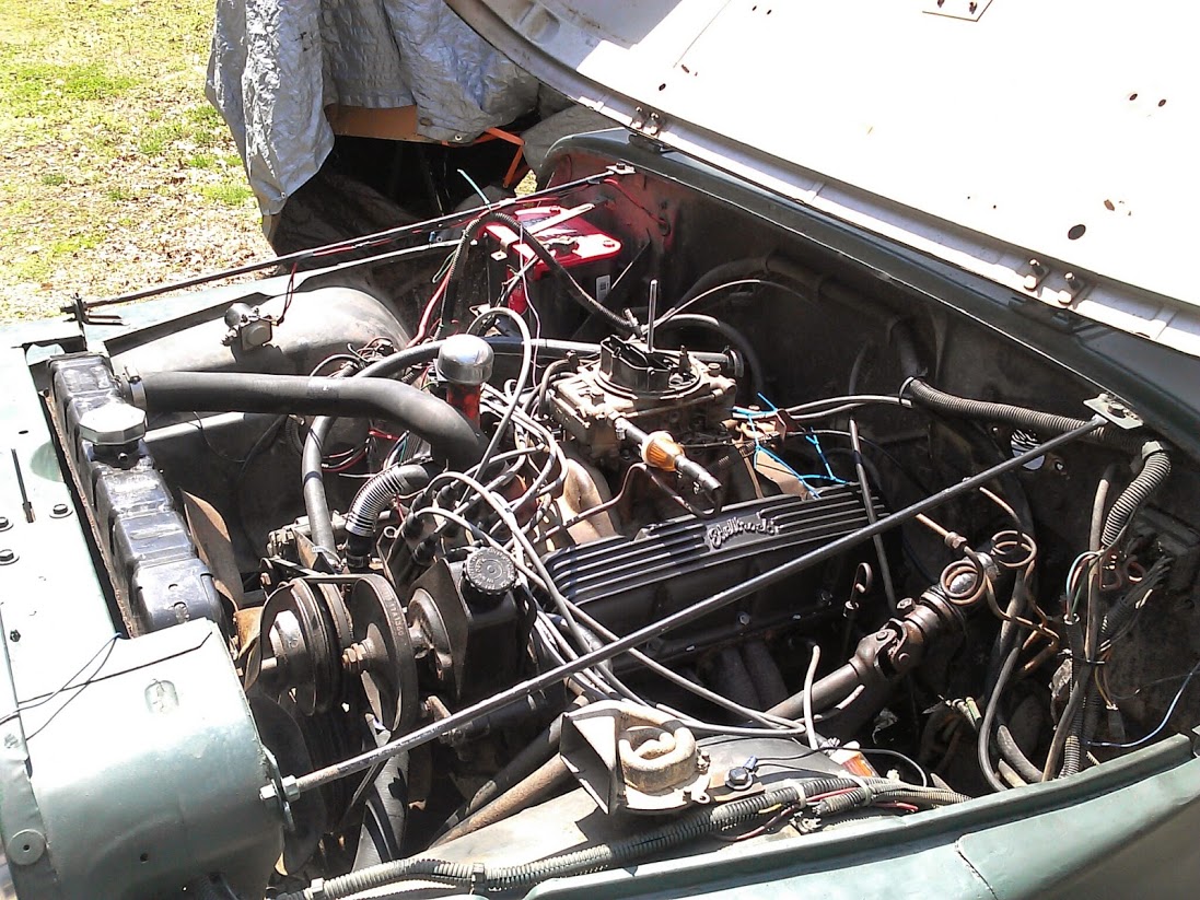

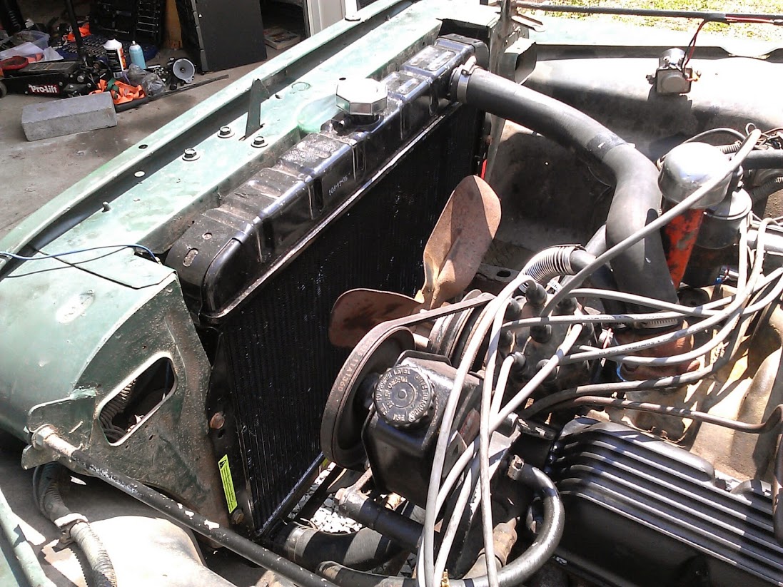

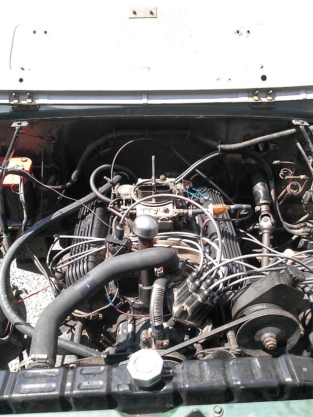

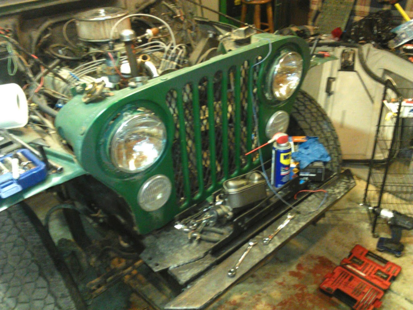

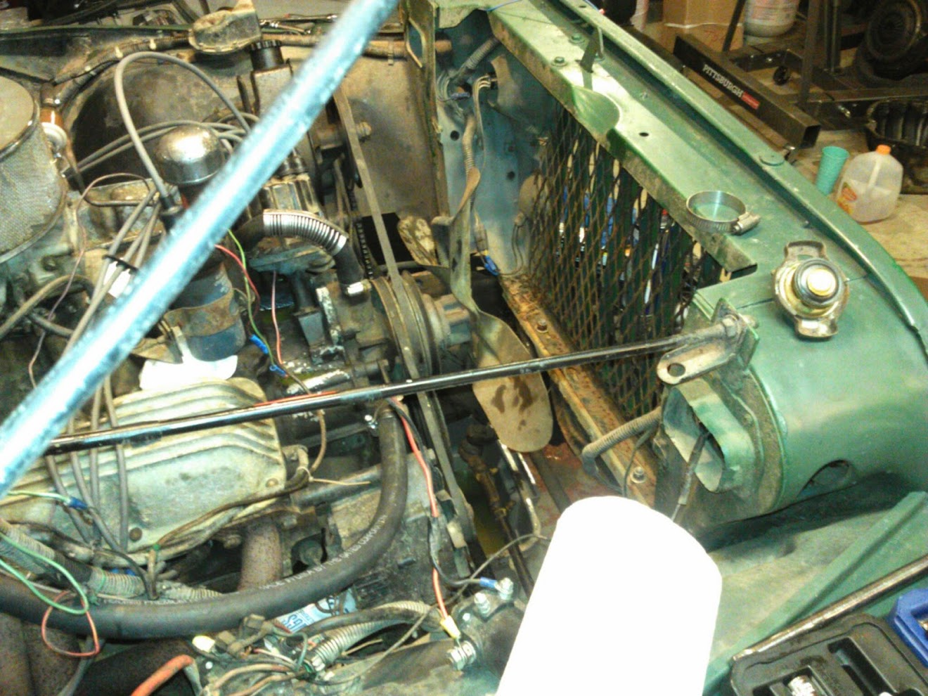

Finally some pictures of what I got done last night
alh4.googleusercontent.com__ReTvSCD8fVs_Uy9yNu9jcNI_AAAAAAAAKi8d4b587296a7f5e392ce079f04d51903.jpg
alh5.googleusercontent.com__Q29zyJ7uXjU_Uy9yRzSd6wI_AAAAAAAAKi64015a86006bf70e192b1aed989a4cb0.jpg
alh6.googleusercontent.com__miEZac6BGTs_Uy9yj_y6IxI_AAAAAAAAKj4b2a0cdfb821f0f0605d96d8a8dd8982.jpg
alh6.googleusercontent.com__Zbri4tdsVIU_Uy_BSwVkWDI_AAAAAAAAKlbe8510a7c1838a7964a2108751d045f9.jpg

Worked all weekend on the CJ5. Been trying to get the AMC 304 V8 running right. When I tore it down, I had 6 collapsed lifters in the motor. Also I took the radiator out of the Jeep as well because I had a new one. Finally got it all back together on Saturday, and because I replaced the lifters I had to do a cam break in procedure, yeah your suppose to replace the cam, but it had minimal wear and I didn't want to do it, mostly because funds are really tight and I'm worried I'm not going to have this CJ5 done in time.
Got it back together, and for 20 minutes my backyard looks like a battlefield with the blue smoke that was rolling out of my V8. Yeah I needed valve stem seals something horrible. I did a compression check on the motor all the way around and every cylinder was either 119 or 120 PSI of compression. I also checked the spark plugs and they were really dirty so I took them to my bench grinder and cleaned them and re-gapped them. I got the driver side replaced yesterday after going through 3 different over head valve compressor tools, note the one from Autozone is freaking awesome, the ones from Harbor Freight/Advance Auto/Oriellys are GARBAGE.

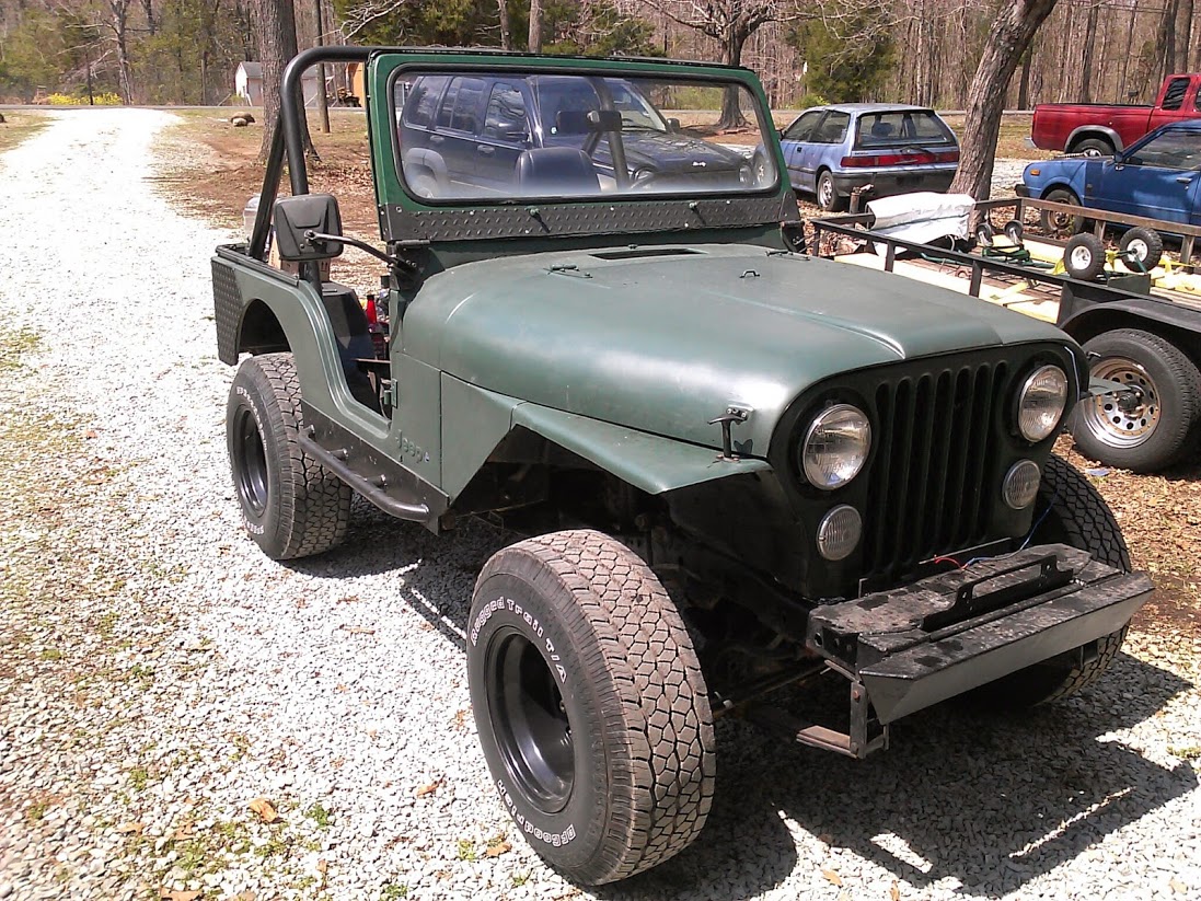

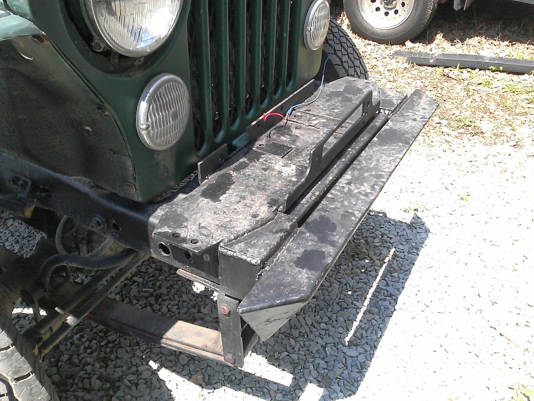

Is that front BUMPER, a direct replacement for the Master Cylinder? :p Seriously though, I hope those pics are from when you first got it. Btw, I'll be in class with you!
No unfortunately that is how the Cj-5 looked yesterday, I made the mistake of trying to do too much at once, so I've kind of back tracked and am fixing one thing at a time. Need to get the engine sorted out. When I was tuning on the carb last night I heard a bad sound like metal hitting something, I think its exhaust though, I will be double checking this afternoon when I get home from work. I haven't paid for the class yet, I know I should but I still don't know if I will get everything done in time!
