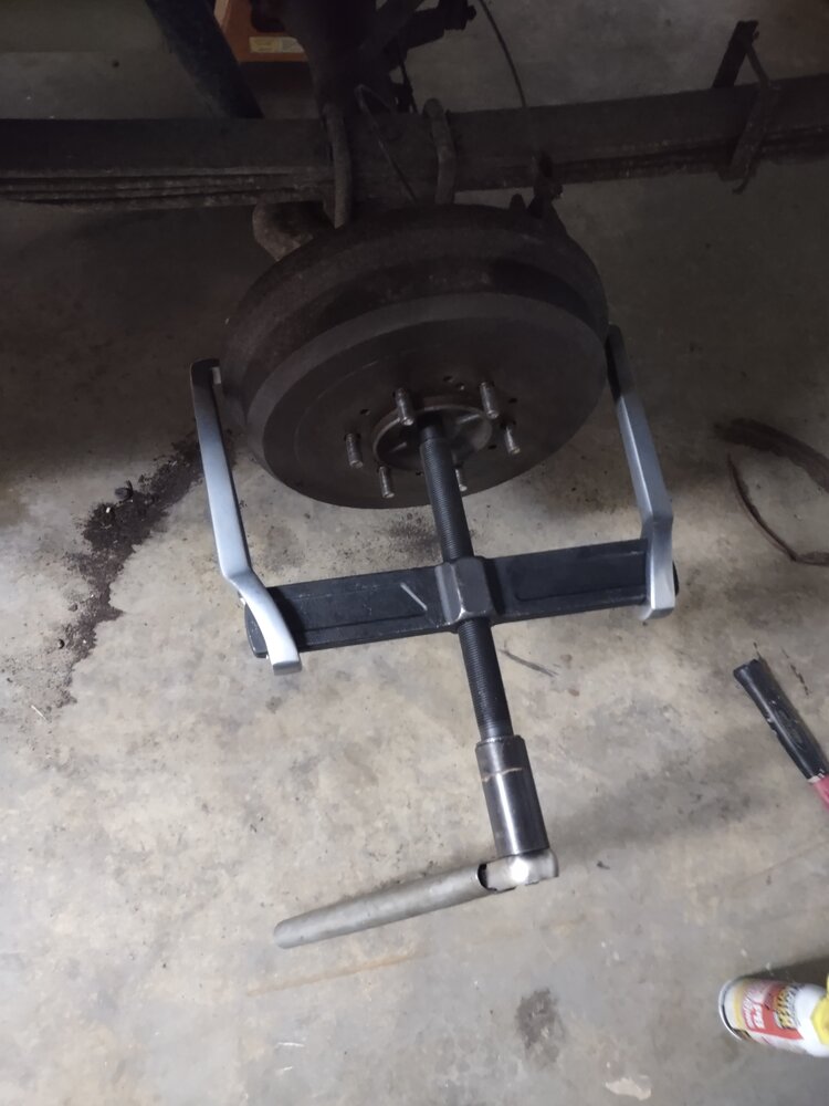

Drill 1/2" hole in drum aligned with the face of the shaft flange. Weld 7/16" nut to drum. Run 7/16" bolt in and it'll walk the drum off.
Like how some manufacturers have threaded holes for drum removal
How would one cut it so as to not F up the axle hub and hardware inside? Can't just slice down the middle of the face.
Cutting torch.
Start at a top edge and when you get through the drum and hit the hub face it will blow slag everywhere, then start moving down.
I have way too much experience removing bearing races like this with no damage.
Soooo, all disclaimers apply, your own risk, eye protection, lather rinse repeat, etc. etc.
