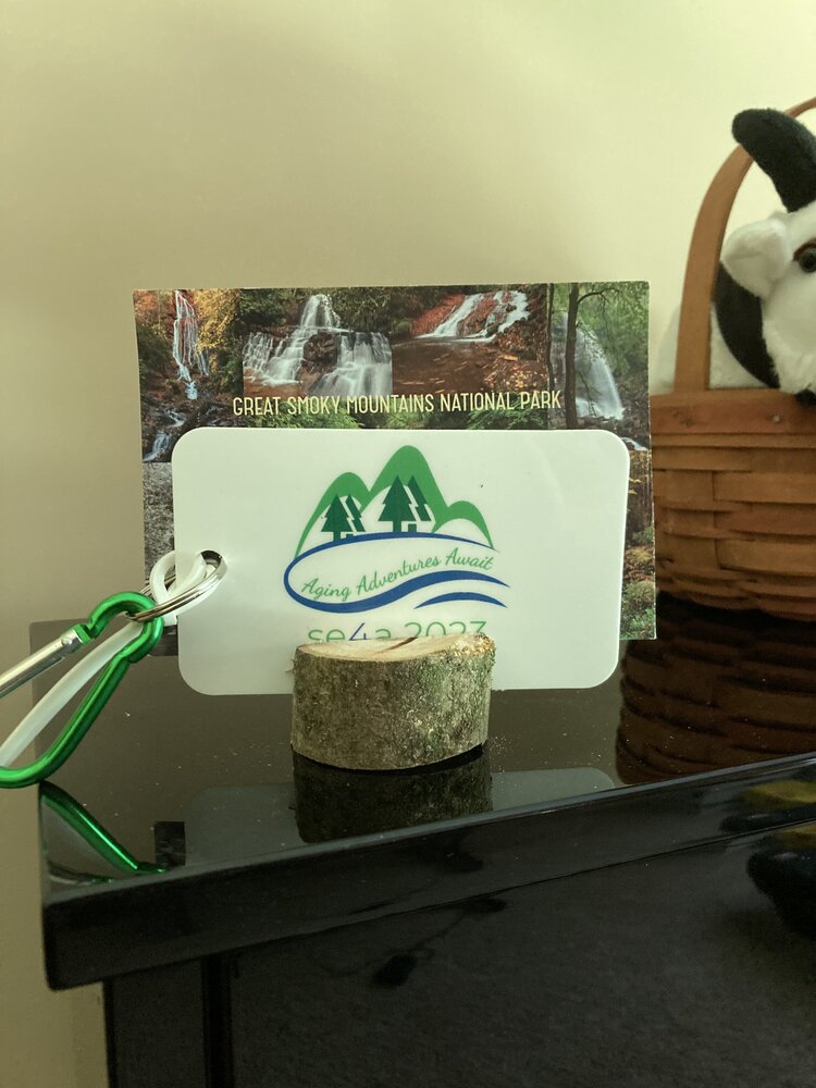

I'm trying not to give the doctor any of my fingers! Here's my dilemma, I've got to cut down some small saplings and cut them into 2 inch long blocks. Those blocks will have a groove cut all the way across one end. The groove needs to be about a 1/4 inch wide to hold a postcard and something else upright. I cut a few samples with a regular circular saw and it's kind of sketchy. I'm thinking scroll saw but the blade is very thin. Does anyone have an idea? I've got to cut 400 of these little suckers. Thanks guys.

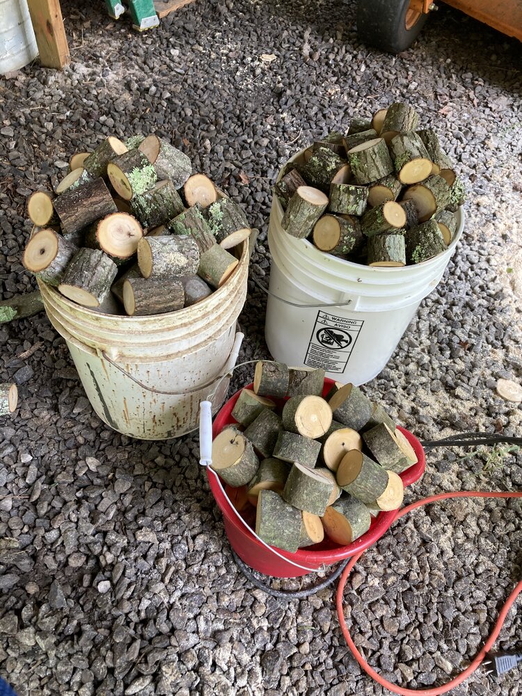

Here’s about 300 so far. I’ll cut the notch across later. Dang Braxton you are the man!!
